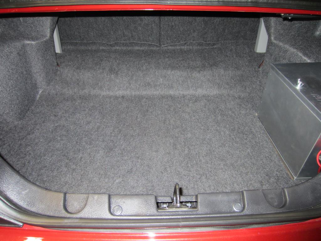

Trunk install. When this picture was taken I only had one isolator kit on the right side.
With the carpet down you do not even know it is there.

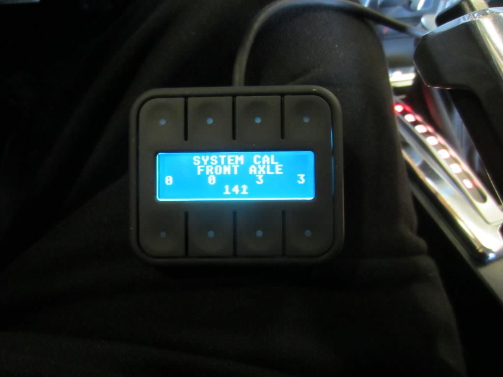

The kit allows for eight pre-set ride heights with a wired controller. Once you have set your "standard" ride height you have an alignment done at that setting.

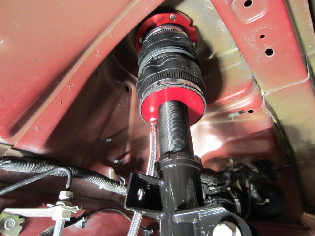

A front strut.

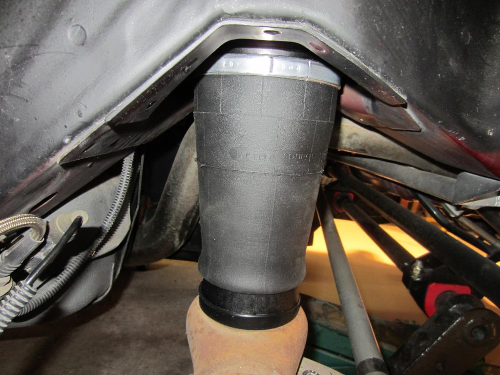

A rear air bag installed.
