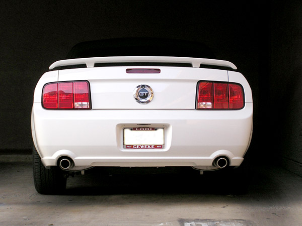

Here is the picture so far... I am still not 100% satisfied, but it's pretty close... The driver's side is still just a smidge higher than the passenger side...
I think they look even but if anything you've got it backward, the passenger side might by slightly higher.

You're right, I meant the driver side is a smidge LOWER... Oops...
I think I may just leave it that way for a while and see if it continues to bug me... Hopefully I can deal with it until I can get the FRPP Mufflers!
