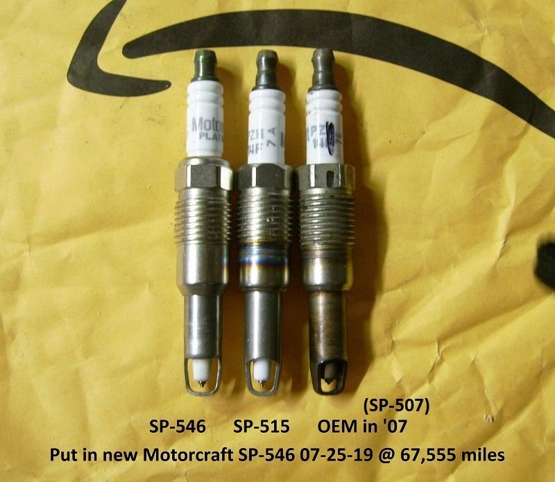

I went through this with my '07 FX4 with 5.4 - 3valve which came with SP507s, which I had bought SP515s for, but then bought SP546s last year, it had 67,xxx miles.
The 515s had more bluing at the weld, the 546s looked different in the way the ground electrode was made / attached, but I measured the barrels of all 3 and they all three are 10.0 mm. which is 0.393701" which is pretty close to the 0.393 - 0.394 range I interpolated it to on the SP515 and SP546 plugs new in box. So "diameter" looks unchanged.
I did note that the sealing taper or step down on the SP-546 plugs is somehow "more pronounced" but not sure what it means. No bluing. I hope that it means the lower shield is better attached … or maybe one with upper plug body.
I did find that the top of the plug where the coil spring rested was longer at it's seat for the coil so it applied more pressure against the coil. I put the SP546s in my '07 FX4. I had two plugs screw up upon removal in my truck, the #8 all the way under the firewall pulled the outer shell and left all the porcelain & center stuck and it was the hardest to get to. I used a Lisle tool set & Porcelain Puller for an easy fix. In the '08 Mustang GT, #8 will be easy to get to.
I suspect the same changes were made with the plugs in the 4.6 - 3 valve, just in a different heat range. Truck's been perfect ever since. The Mustang has much easier access. I had a really long 6 point 9/16" plug socket a couple years and I bought a Carbyne 9/16" magnetic Spark Plug Swivel Socket as I didn't yet have one. …....and it was great, I used it mostly. Strong magnet too.

/But yes, indeed, good info. May I also point out that using nickel anti-seize regardless of plug is probably a good move given how that shroud works in the head?

Yeah, I knew the thread was initiated a lot longer than a year ago, I knew that there was some activity last year too, I know too that my '07 FX4 5.4-3v takes different plug numbers than the 4.6-3v in our '08 GT, but the plugs look to be made the same and have gone through similar updates. Thought a look at the changes would maybe help someone. I know the Lisle tools work for either as well. If a plug breaks, follow the Lisle Tool directions, it's engineered to do exactly the job.
Yes, my new plugs in the 5.4-3v got a thin smearing of nickel anti seize on the barrels & threads.
