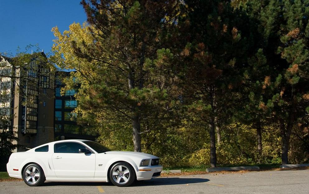

Please, if you lower with springs, do shocks as well.
Trust me. Just doing springs and pairing them with the OEM shocks totally sucks. I've done it and the difference vs. a proper set of shocks is night and day. And NEVER cut your springs. If anyone tells you it's ok to do that, don't be eve them and run the other way.
I have Eibach Pro Kit springs and Tokico D-spec shocks. The difference in ride once I installed the D-specs was fantastic (I did the Eibachs first, a few months prior), however with my experience and speaking with a few knowledgable people at some local shops, I find them to be a bit on the bouncy side. If I were to buy them again, I might opt for the Koni Adjustable shocks paired with the Pro Kits.
Looks-wise, I think my car is awesome but I'm biased.
Kristina (car has settled since this pic was taken)
