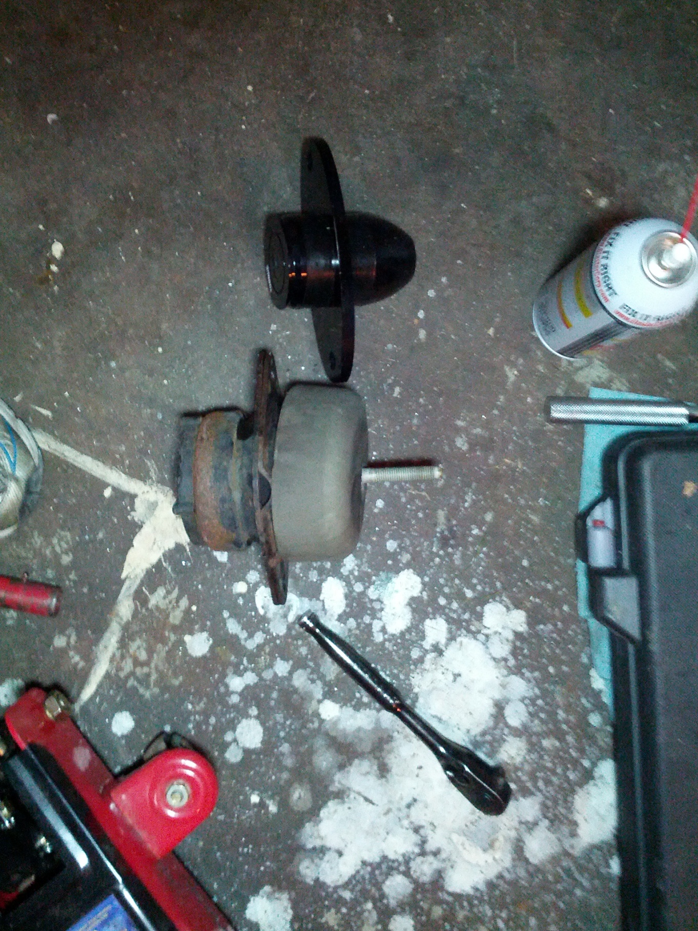

I just installed torque solutions billet mounts on my DD. These are identical to the prothanes, except 85 durometer instead of 75.
Initial impressions are that there's slightly more vibration at idle, but the improved connection with the car is well worth it. The clutch telegraphs better and goes into gear easily. Haven't given it a good test to see if it fixes the 2>3 shift under load yet, or how much NVH there is on the highway.
Feeling the torque in the car at high RPMs is awesome.
And just look at the crappy factory units they replace
Attached Thumbnails Long term experience with Prothane Engine Mounts?-2012-08-14-22.10.44.jpg

Yeah my mounts aren't looking too pretty either (not sure what that grease streak is coming out of the top there...)
