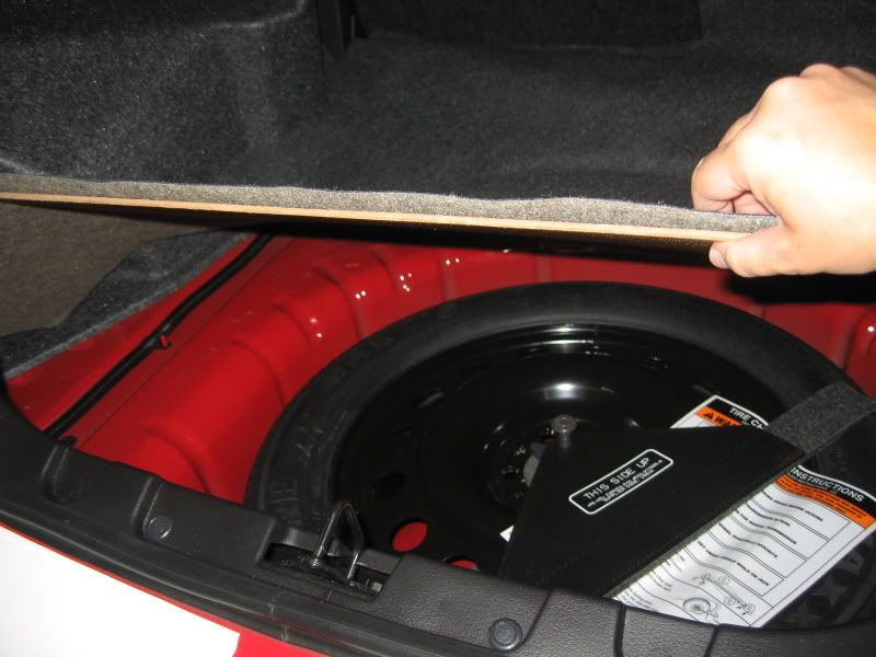

Remove rear panel in trunk; 4 push-pins (can be pulled with fingers) and 2 screw-in fasteners. Also remove carpet base board and set aside.
Pop the rear panel over the center latch and remove from car.

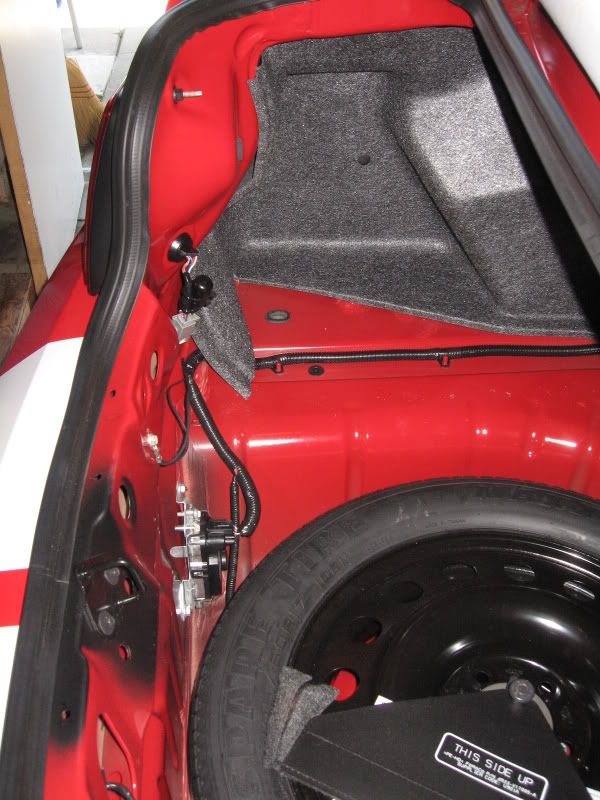

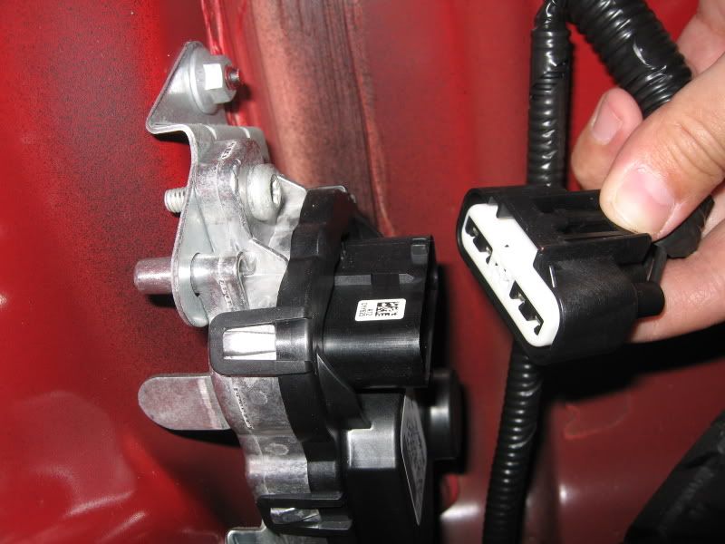

Baseline pictures showing the FPDM (Fuel Pump Driver Module) against the back wall in the spare tire stowage compartment.
Depress the release tab of the FPDM connector and remove plug

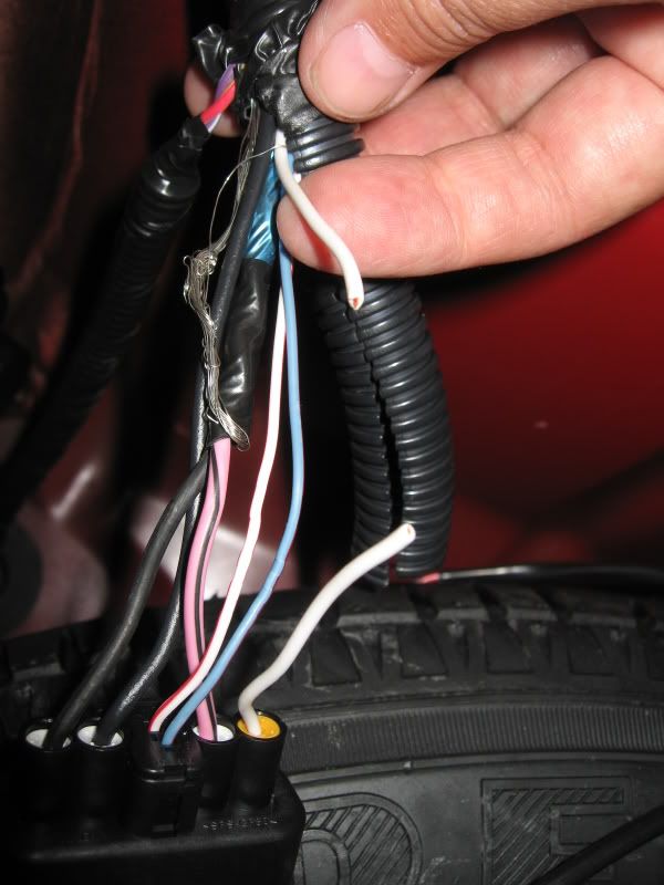

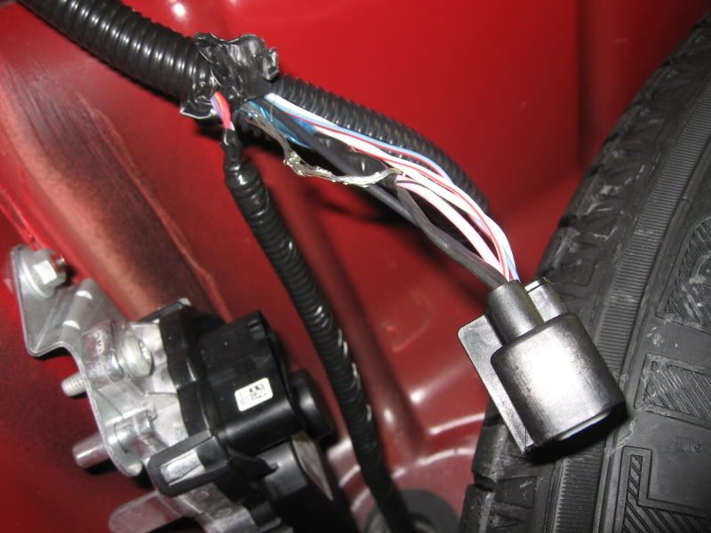

Remove electrical tape off conduit to expose the wires up to the first wire junction
Note: Exposed wire strands were there from the factory. Not sure of its purpose, so I left them as is.

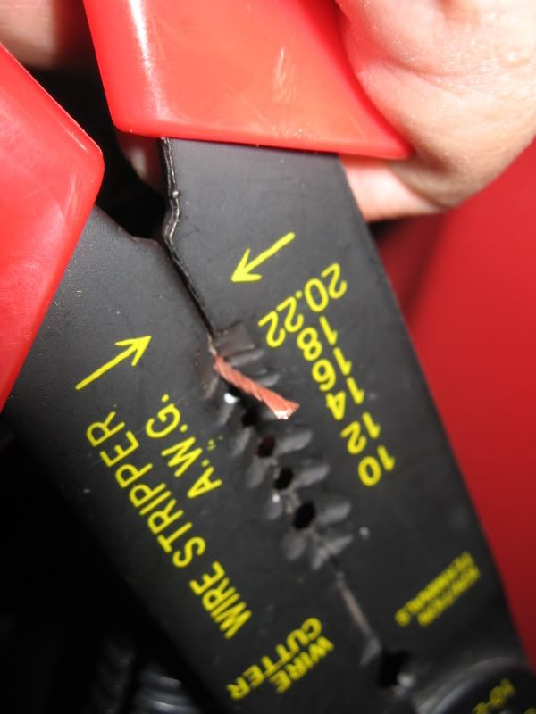

Locate the most outward WHITE wire on the FPDM plug and cut midway, then strip off the insulation off each end (~1/4”)
Remove spare tire to allow more working space

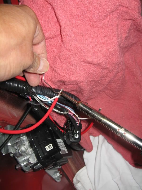

Attach the 2 RED wires off the BAP to the WHITE wires off the FPDM that you cut earlier. Make sure you wire this correctly. After you do, make sure once again.
Solder wires and slip over a shrink tube for added protection.
Note: Use caution when applying heat (ie. Heat gun) to the shrink tubing. Only apply enough heat to shrink the tubing over the wires.
