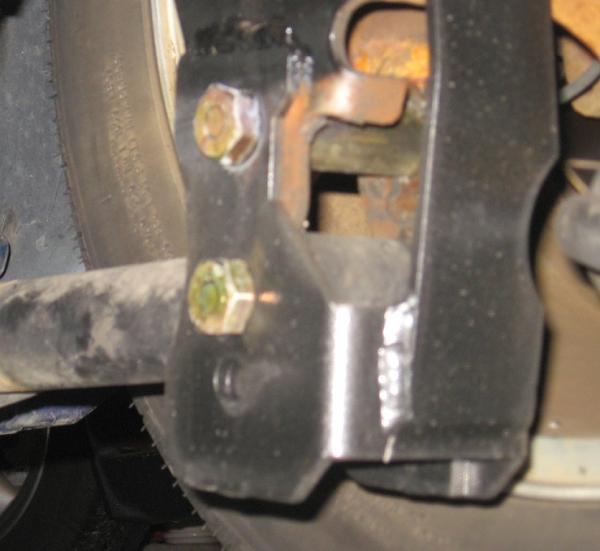

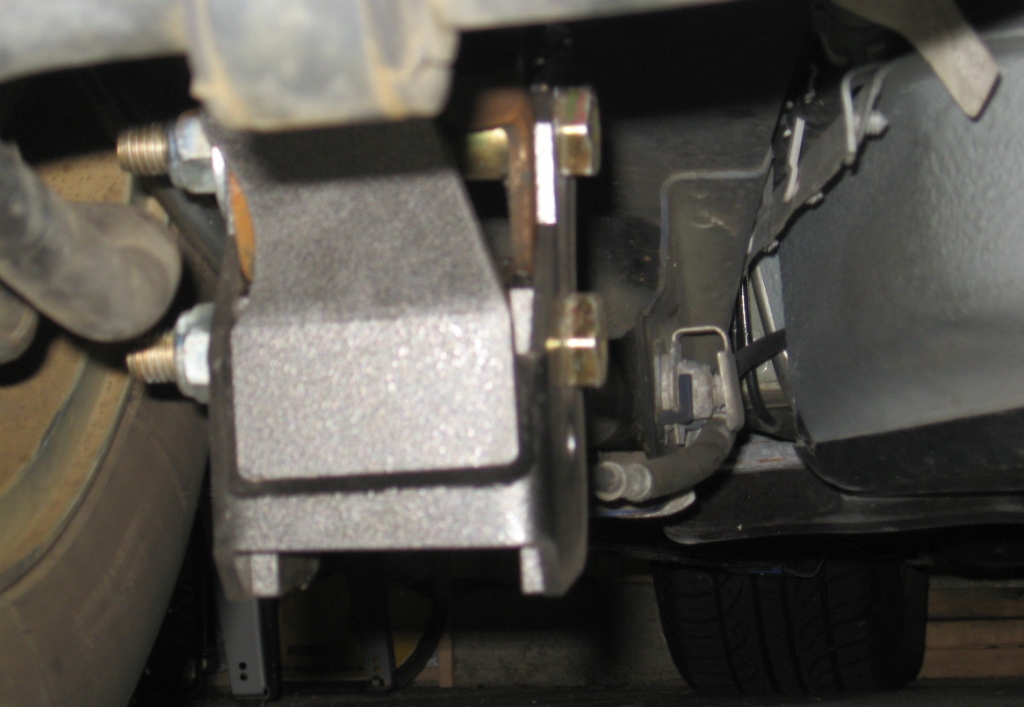

Just had them installed and WOW what a difference. I especially recommend them if you've lowered your car. Before I wasn't able to floor it in first gear without breaking the back tires loose. Now I can hammer it to the floor and it sticks like glue. It also seems to grip better around corners. I had them welded in and it only took a little over an hour.

I recently installed mine also. I would definitely not recommend the bottom setting on a daily driver. I ended up using the top setting, like the OP.
I also would recommend grinding down a bit of the bushings on the LCA's if you're using BMR's LCA's. I don't know why I didn't think about that, but between the rear end moving on me, and the LCA's not wanting to move, it took about 2 hours to change from the bottom to top setting! Same amount of time to install them.

I have BMR LCAs and I had to grind the bushings just a hair to get them to fit. Wasn't a big deal.

I installed a set of Steeda Adjustable LCAs with rod ends and thought about grinding the bushings but unstead I was sucessful spreading the BMR LCA Brackets using a C-clamp the wrong way.
I want to weld mine but since I would want to remove them to remove the paint before welding, and I am still on street tires, I figure that can wait until winter.

Stock LCAs will only allow you to use the lowest setting on the BMR LCA relo-brackets because the stock LCA ends are so hugh.

So is it safe to assume, that with the stock LCA's and lowest settings on the relo-brackets. That they're safe to use without welding them in place?

Just have them welded in. It's an easy job that any shop should be able to do.

i did not weld mine in. Too hard to change out when you bend one.

I thought the whole point of welding them was to prevent them from bending.

Good pictures! I installed these brackets a few weeks ago along with the rest of my suspension goodies, but I installed the LCA into the bottom hole because I am running the Eibach Sportlines, which is quite a bit more drop than most springs... I need to get them welded though!
