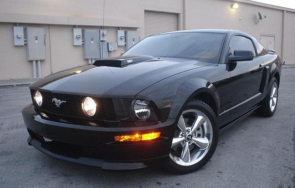

Your Roush hood scoop looks great. So does you SS centered fog light grill. So how many brewskys did it take to get up the nerve to put the drill to the hood?
Scott, it did take a couple... I had the template laid out on the hood for a day and half before I got my nerve up! but it took lot more than a couple to drill the ten holes for for the Roush rear spoiler!...

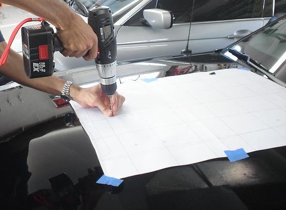

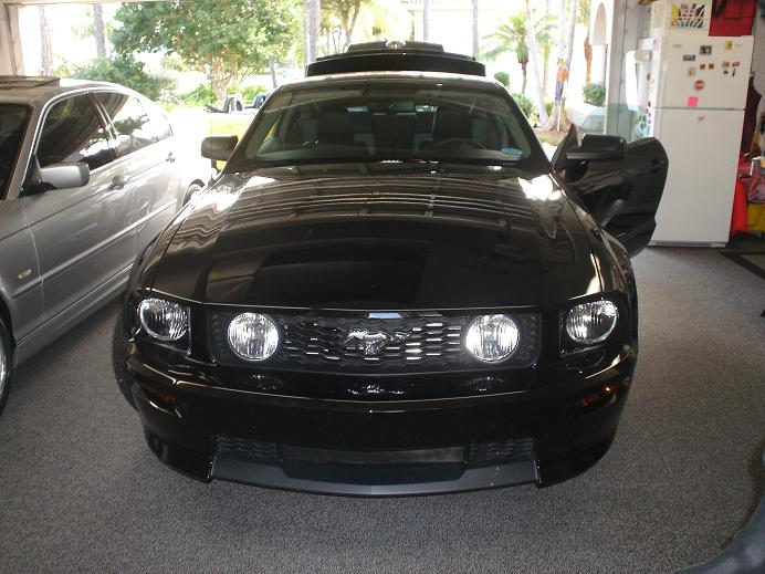

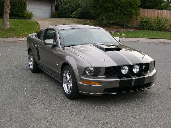

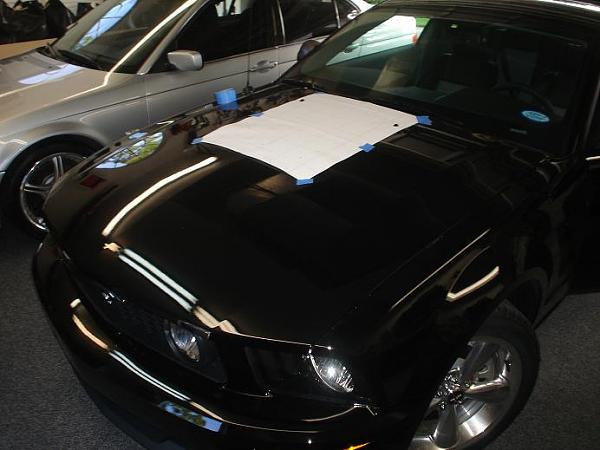

Here's a quick write-up of how I installed my Roush hood scoop 4 days after taking delivery of the car. Hope this will help. Pictures follow to illustrate in the same order as the bullet points (hopefully).
1. Here's the starting point. Your car, scoop and drill. If you got emblems to put on, I strongly suggest you do it before installing the scoop.

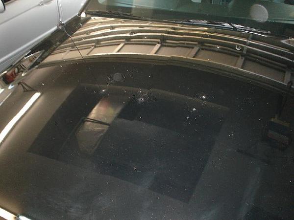

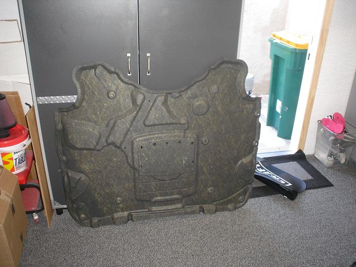

2. Open the hood and pop all the push pins that retain the heat shield to it. You may use a flat screwdriver to pop them out more easily. Just be careful cause the heatshield is not that sturdy and you don't wanna punch a hole in it. Set it aside once you're done and close the hood.

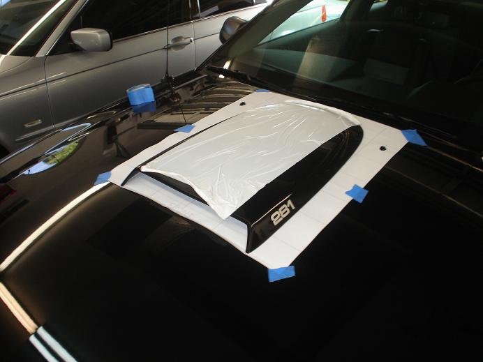

3. Now the MOST IMPORTANT part of the job is to adjust the template and LEAVE IT THIS WAY as you work on it. Go grab some tape, duct tape, regular packing tape.. whatever, as long as it's tough. Luckily, the template delivered with the scoop is very accurate so you can use it as is. The thing is to align the spine of the hood with the center line of your template. The holes for the washer nozzles are useful but do not use them for proper alignment. Use the hood spine instead. Once you're done, stretch the template hard and flat to the hood and tape it.

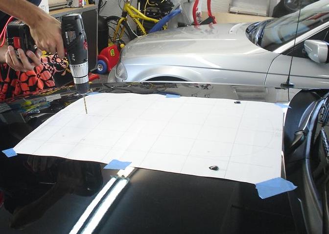

4. Make sure you can keep a firm stance while you drill. You will ideally need to stay to the vertical of the hood as you do it. So make a couple of tries without pulling the trigger. You'll have 7 holes to drill if I remember well and none of them is close to any edge of the car, so find a stable position first.
5. I did not use any punch and drill device or whatever that's called, neither was I gonna shed more $$ to get the job done. You can do it just right by holding the drill bit in the very early stages of drilling each hole to avoid skidding. Basically, place your drill to the vertical of the hole, apply a decent amount of pressure onto the hood while stopping right before it bends, start drilling slow while guiding the tip with your free hand until you feel that the tip is holding a firm direction. Once it's engaged, keep the pressure and drill faster. The metal shavings that will pop out of each hole are absolutely normal so no worries.

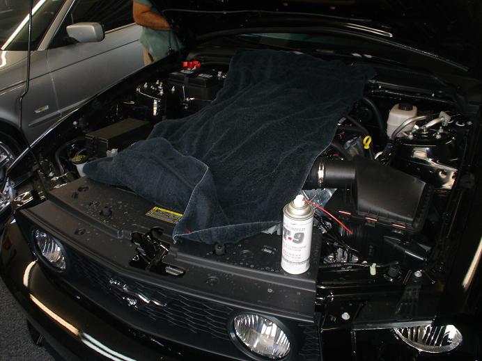

6. Open back your hood, place a towel on your engine to protect it from the leaking and spray on your holes with some anti-rust spray. I use Boeshield T-9, it's also used on boats. Do the same to the screws of your Roush scoop. No matter how tight your scoop is gonna get sealed to the hood, water WILL get in there. So do yourself a favor, spend the extra $10 on the anti-rust can and protect your whole hood from the next few years of bad weather and car wash.

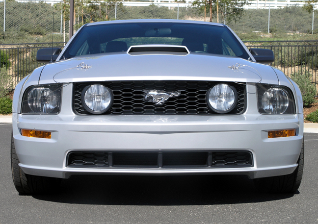

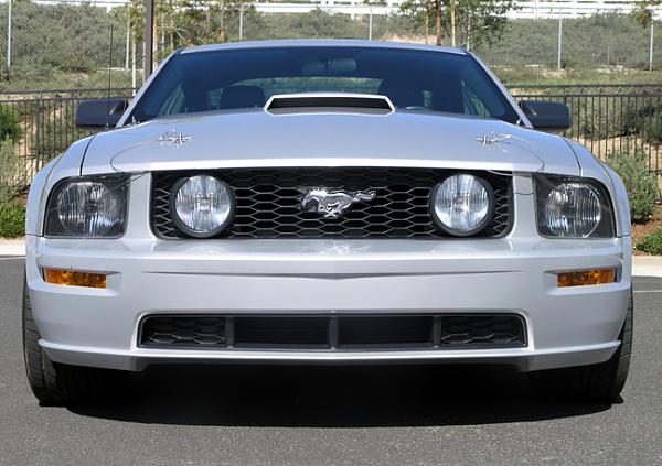

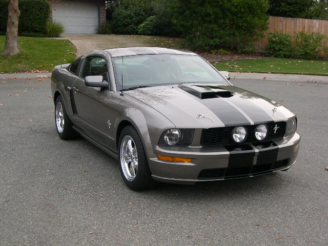

7. Close your hood, remove all the shavings to be able to see the holes better. Then place the screws that come with your scoop on it and plug it all into the holes. Make sure you pull a little bit of 3M tape to be able to grab the tips afterwards. Stick your scoop to the hood with a large piece of tape while you lift the hood to fasten the scoop screws from the inside. Once you're done, re-plug your heat shield inside the hood, close it, remove all tape + 3M adhesive from the scoop while pressing it onto the hood firmly to get all this mess together. You should be all set
