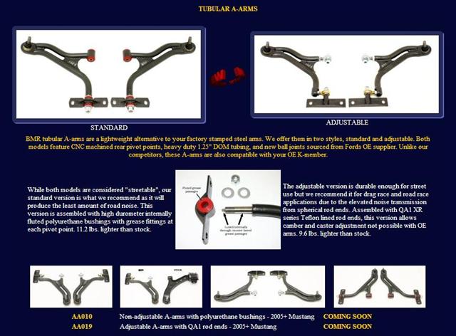

You mean these ones?

Sweet, thanks for posting. You don't happen to know how much I might be looking at for a set would you?

For the BMR's? No pricing yet. Another 2 weeks or so.
Granatelli's looks like ~300 and their K-member is ~360 + motor mounts I think

BMR now has pics of their A-arms on their site. It won't be too long. 11+ lbs. weight savings!

Have you found out if that's the total savings for both arms?
Originally Posted by 169stang
Pair..total.
