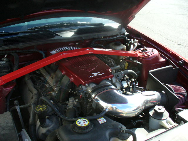

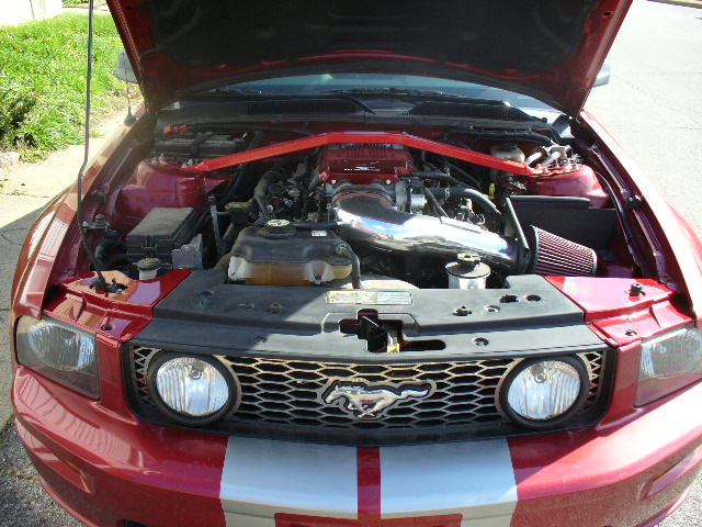

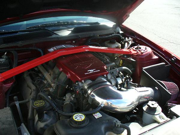

Love my bmr brace, and you can add what decals or emblems you want too it. Clears the cover nicely.
