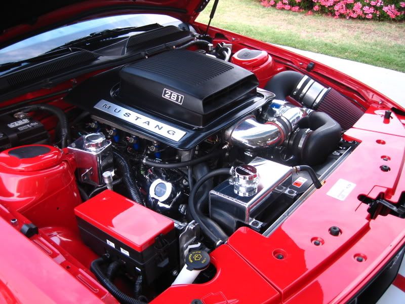

Bill, I noticed you've got the Canton overflow tank. I had one on my '03 Mach 1 when the factory plastic tank started warping. Our Vortechs require moving the overflow tank to the passenger side of the car. Did you have any trouble fitting the Canton tank over there? Any mounting modifications needed?
Thanks Brian!
The Canton coolant overflow tank just mounted in the factory location.
The p/s reservior tank posed a problem because I could not mount my MWAG side extension cover if mounted where Vortech instructs you to. So, we ended up mounting it off the strut tower.
A custom bracket was fabricated to mount the reservior tank.
Shots of the engine bay as it sits today.
I'll be swapping out all the hose clamps for T-bolt clamps soon. I have them, but most all are too small!
