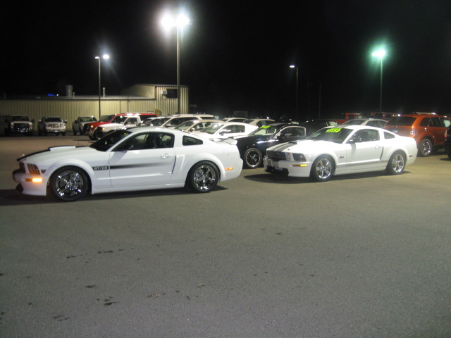

I believe they are equal to the pros. I have parked side by side to a shelby and mine is just a lil bit lower front and rear. infact I think I have a pic..standbye. There ya go. I have sportlines
