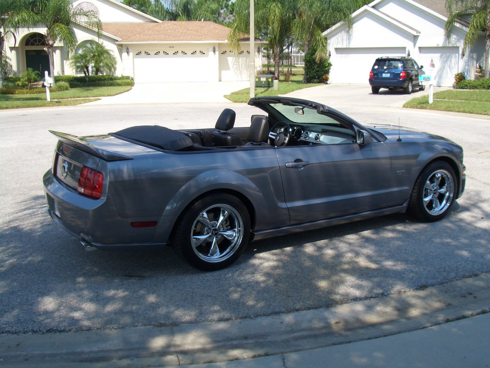

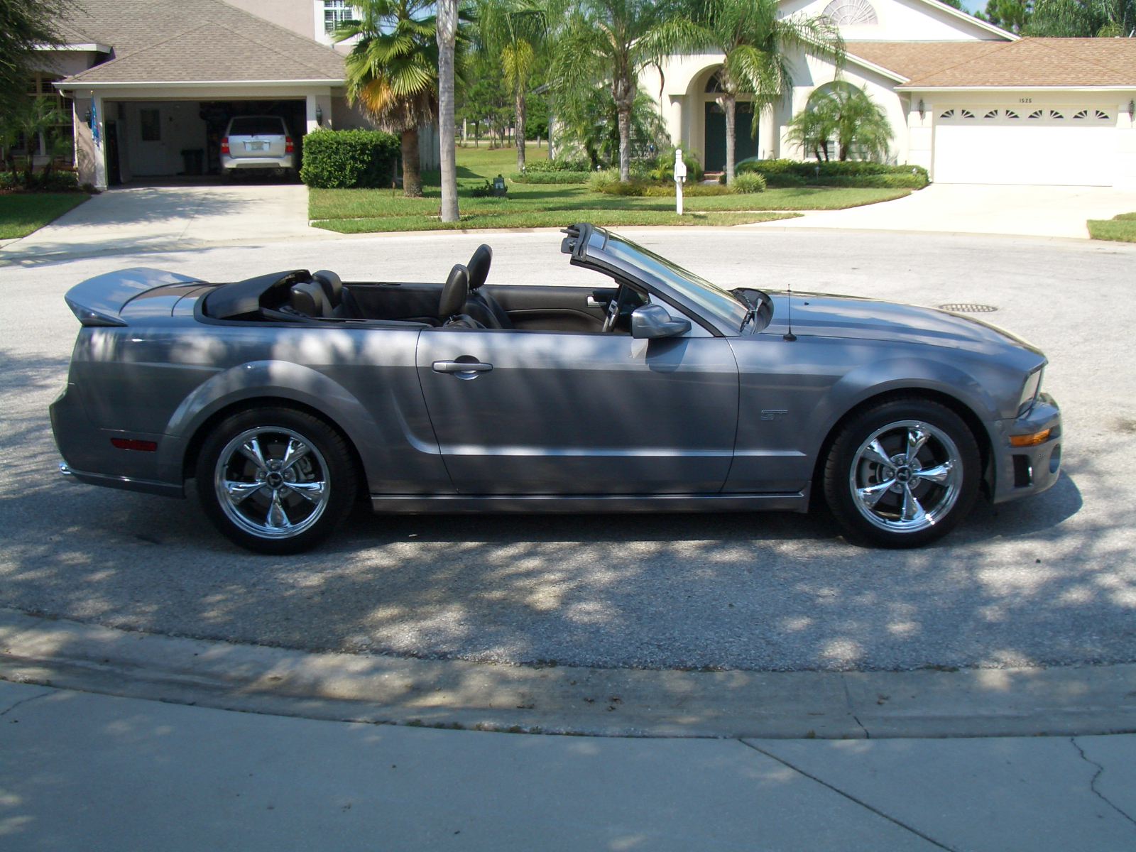

I have the Steeda springs all around so I don't know exactly what it'll do with only the rear dropped but you definitely don't need an alignment with just a rear spring swap. I drove around for months after installing my springs without getting it aligned and didn't have any issues.
The one thing I can tell you though is that without replacing the shocks it gets a little bouncy over expansion joints due to the firmer spring rates. I would also suggest an adjustable panhard bar to recenter the rear axle after lowering. It isn't imperative to get one but it is suggested.
Sorry for the bad pics due to the sun/

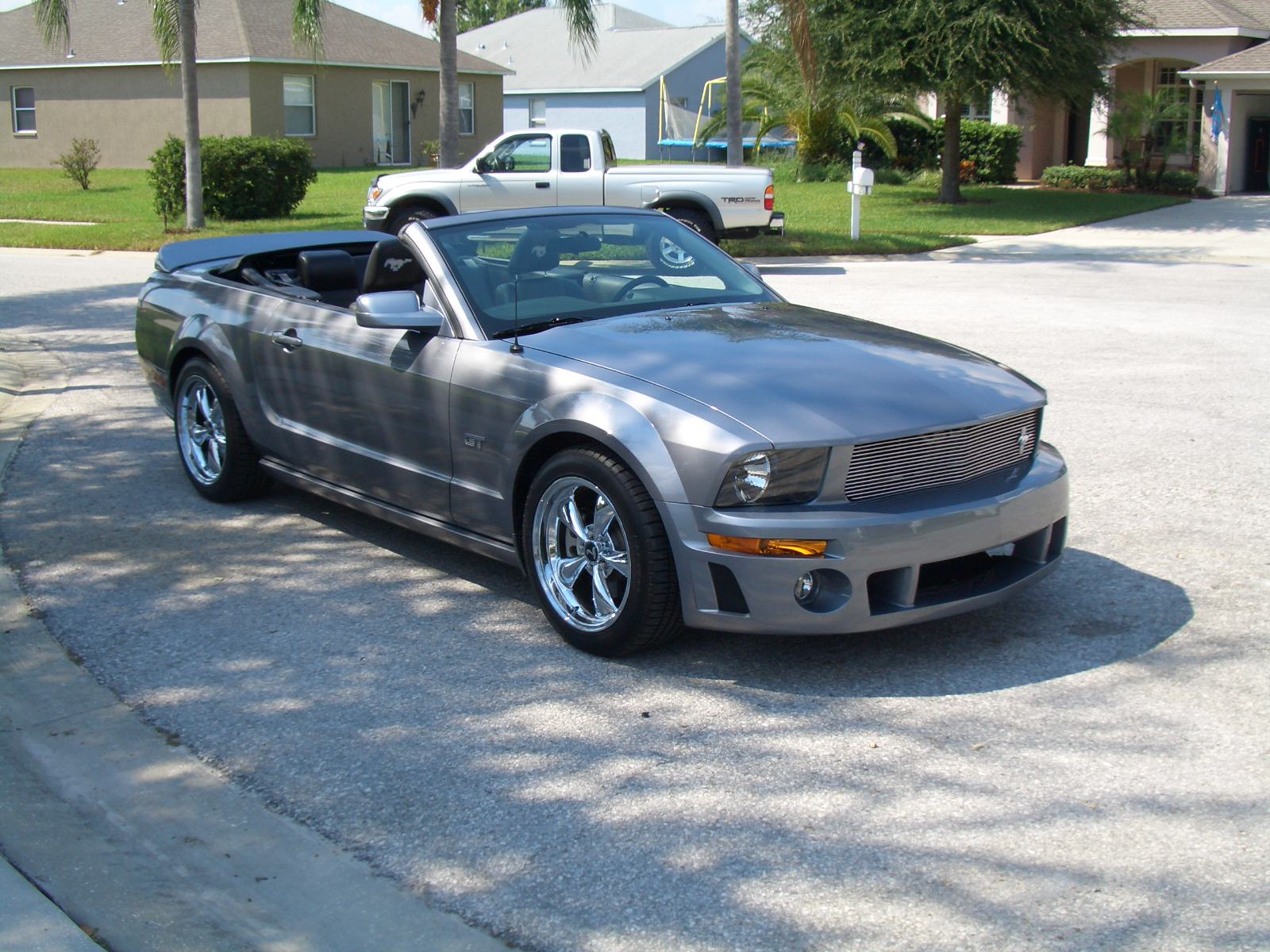

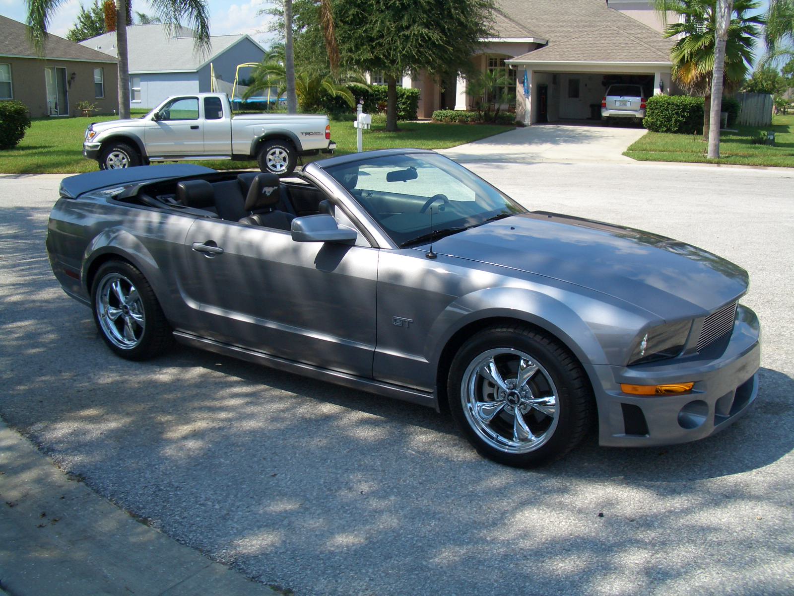

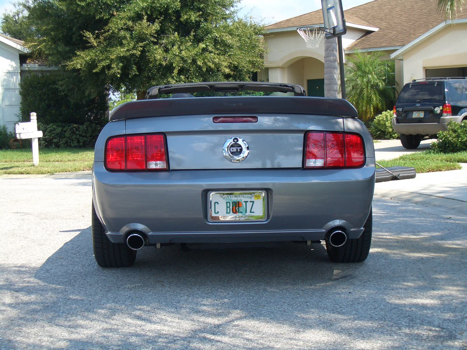

here ya go Dan.I got the ultalites(4 of them,cuz you can'y buy just the rear) at American muscle-formerly mustang tuning for 209 delivered. I have the fronts incase I want to install them later on . The ride quality feels the same.
The rear shot looks crooked but its just the way I took the pic.

Wow your ride looks great. Are the tires the stock pirelli's? 17"?
I think what I'll do first is get the 270/40 18" first, because it is my understanding that those alone will close the fender/tire gap by an inch without touching the suspension. Then I'll revisit lowering the rear maybe by just 3/4in with the Steeda Sport springs. Whadaya think?

the rims are 18"x 9".Tires are the stock 18" 235/50 G-force...after these wear out I'm going with 255/45.sports will give you a 1" drop I'm pretty sure

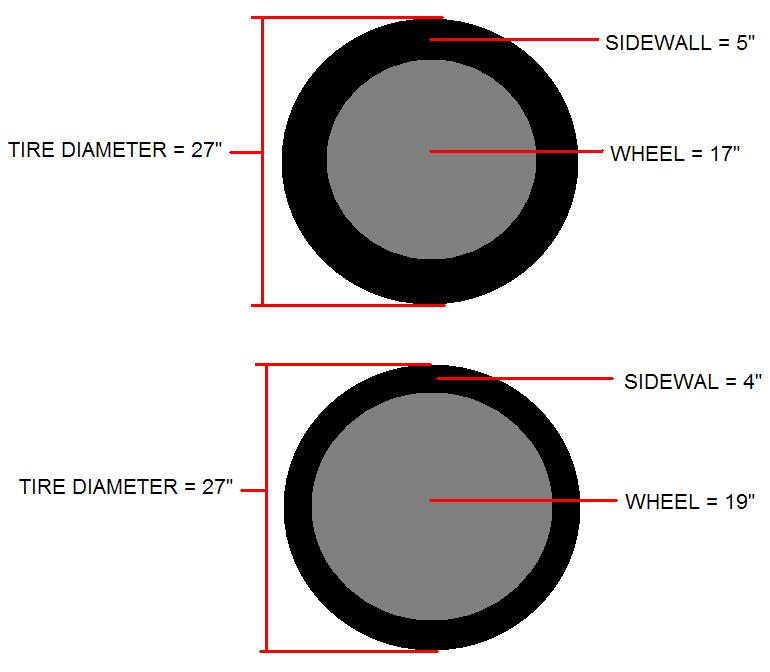

The numbers I'm giving you are simply generalizations. The most important thing to remember (because most people get this wrong) is the first number is the width, and it's in milimeters.
Chuck, to keep from loosing sidewall, all you have to do is keep the size of your wheels the same and the sidewall will stay the same height. Think of it as 2 circles. One inside the other. The circle on the outside, which is obviously the larger one, has to stay the same. That one is your overall tire size, or diameter. If you change it, your speedo will be off. So the only other thing you can change is the size of the inner circle, which is your wheel. As it gets bigger (17", 18", 19") the space between the two circles gets smaller. That space between the two is your sidewall.
Maybe the drawing will.
One problem though is as the tire gets wider and you kep the width of the tire the same, the sidewall will tend to bulge out if it's wider than the wheel itself and can make the sidewall slighty smaller.
