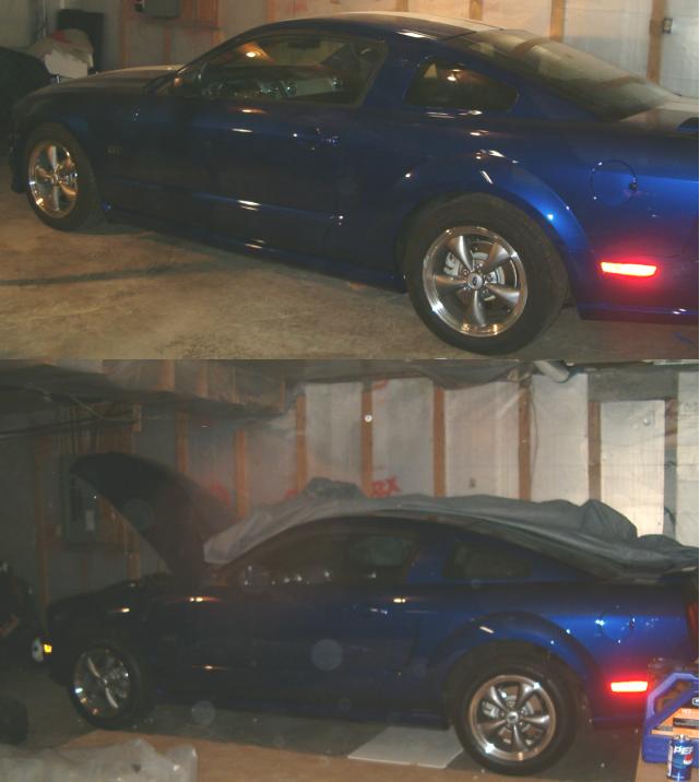

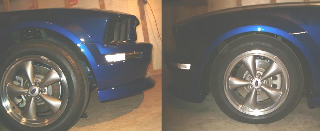

I have attached pics of the before and after with the Eibach-Pro setup. I know the pictures look like crap and I apologize in advance. However, i think its good enough for you guys to get idea just how much this kit actually dropes the car... Eibach says the Pro-kit allows a 1 inch drop on the front and a about 1.5 inch drop in the rear, however the front seems to be more like 1.5 inches.
Installatation was very easy!
-Adam

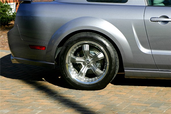

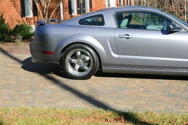

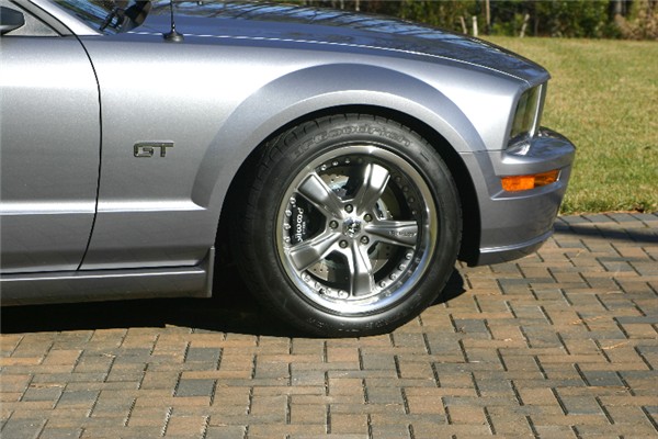

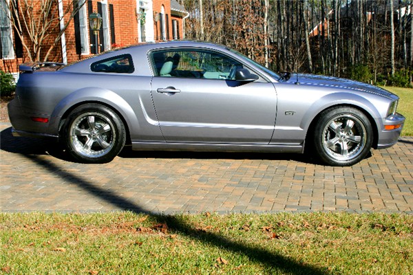

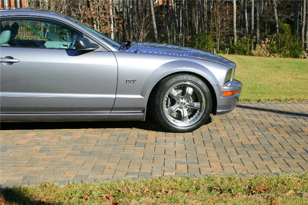

I have the same Steeda spring and D-Spec shock setup and am very happy with it. I run the front and rear on 5 for daily driving and turn it down to 3 frt and 4 rear when I want to play. I think the drop is perfect here are some side shots that may help your decision.
Earl

hi retfr8fly, your car looks amazing! it does sit very nice!
are those the ultra light steeda?
man..steeda or eibach?? seems like both are GREAT...
