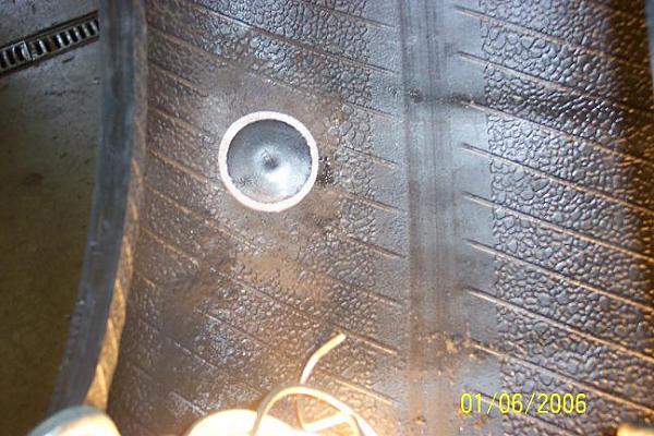

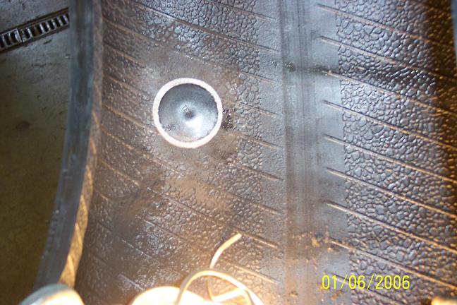

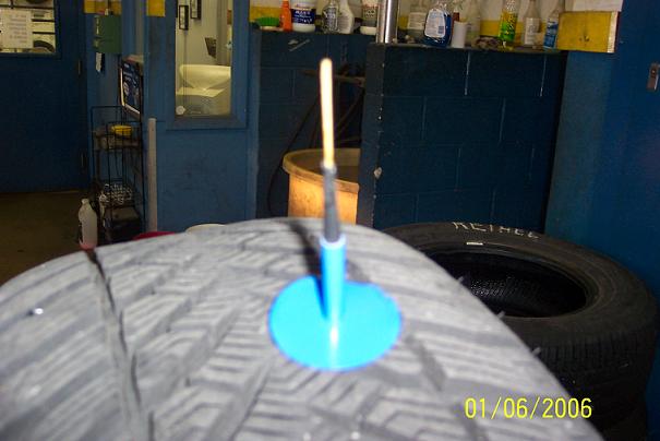

And personal experience. I patch plug my own tires and have done well over 100 mph without an issue. Also work for goodyear for the last 17 years.
Heres the patch plug he was talking about (Nipple, lol)
Attached Thumbnails Concerns w/ tire patch on speed rating???-patchplug.jpg   Concerns w/ tire patch on speed rating???-patched.jpg

Wow, thanks for the info and the pics Stoenr! I'm ready to hit the speed limiter (well maybe get close sometime).
