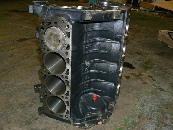

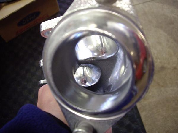

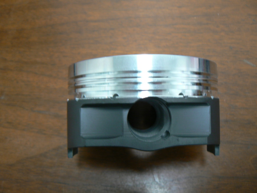

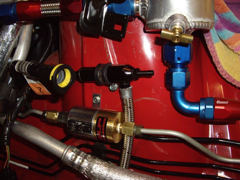

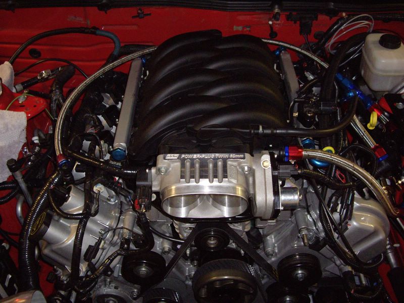

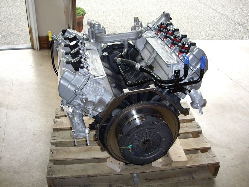

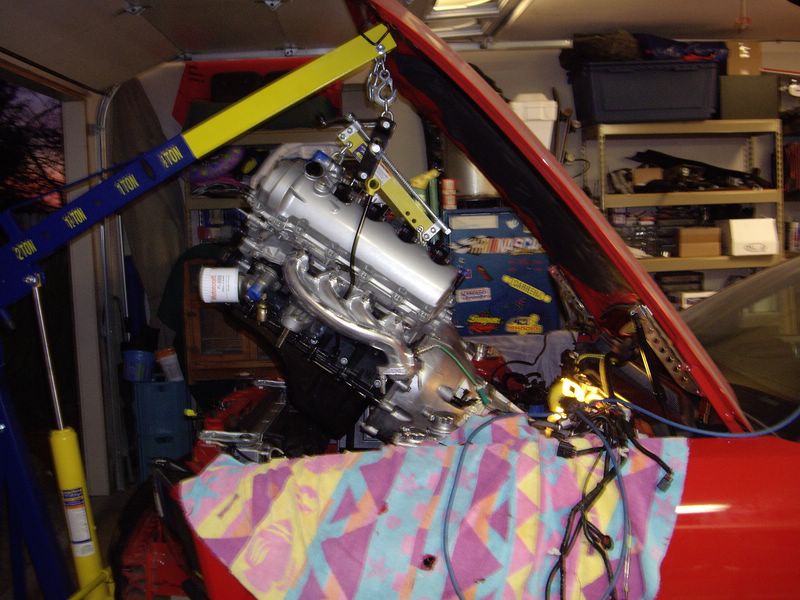

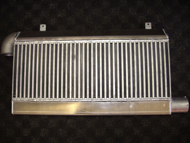

I have had a couple requests to document my latest build as some of you are interested in doing something similar. I will keep things brief and answer any questions and post any pictures that you guys want. I am shooting for a conservative 650-700rwtq on pump gas/street tune with a fully upgraded BB 76mm kit from Jim @ Turbohorsepower. I have upgraded my stock 5 speed with a 26 spline input shaft and a GT500 twin disc clutch and flywheel. Right now I am breaking in the motor N/A before I put the turbo on. The motor was built and tuned by Adam @ ST Motorsports and consists of the following:
-FRPP Boss50 iron big bore block
-Kellog forged 3.75" stroker crank
-Manley forged H-Beam rods w/ARP 2000 bolts
-Custom Diamond 9.0-1 slugs w/skirt coating
-GT500 oil pump
-JDM CNC'd big valve heads w/Manley Nextec springs & titanium retainers
-Comp stage 3 cams

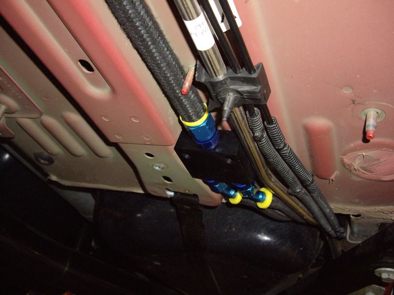

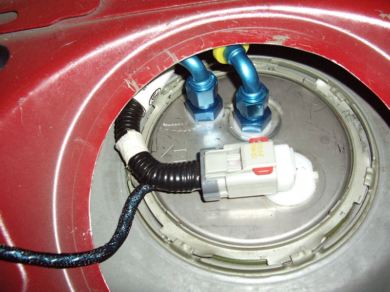

-GT500 fuel system modified w/dual GT supercar pumps, dual -6 to -8an supply line, power supply upgrade.

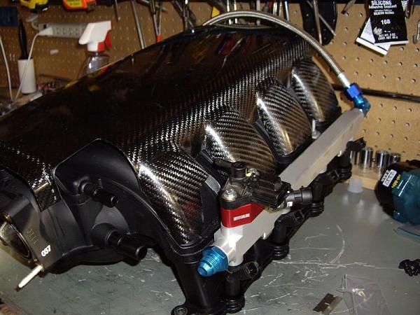

-Metco fuel rails
-flow matched 60# injectors
-Meziere H2O
-Steeda UDP
-BBK throttle body

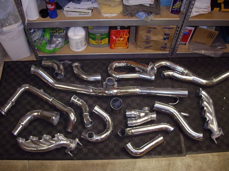

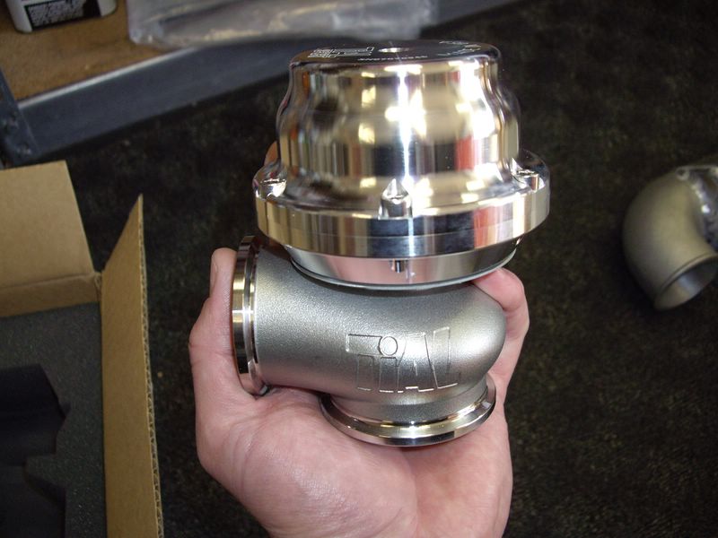

-Turbohorsepower 76mm bb turbo kit
-GT500 twin disc clutch/flywheel
-26 spline input shaft on stock 3650
-No cats and 3" Magnapack system
I am currently running the stock H pipe with cats, stock injectors and stock air box/filter.
This motor pulls as hard N/A as my stock motor with the Saleen SC running 6# of boost!!

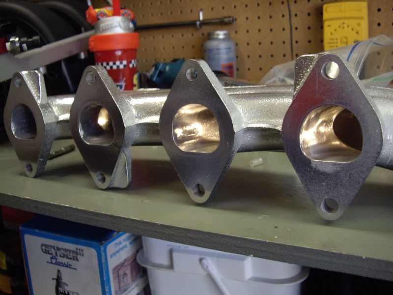

I have also hand ported and jet-hot coated my stock exhaust manifolds and port matched my intake manifold to the CMC delete plates.
Attached Thumbnails Cali's Boss50 326" motor build-big-20bore-204_6l-20003_jpgmod.jpg   Cali's Boss50 326" motor build-p1020207mod.jpg   Cali's Boss50 326" motor build-imgp1371.jpg   Cali's Boss50 326" motor build-imgp1376.jpg   Cali's Boss50 326" motor build-imgp1395.jpg
Cali's Boss50 326" motor build-imgp1312.jpg   Cali's Boss50 326" motor build-imgp1276.jpg   Cali's Boss50 326" motor build-imgp1278.jpg   Cali's Boss50 326" motor build-imgp1282.jpg   Cali's Boss50 326" motor build-imgp1273.jpg

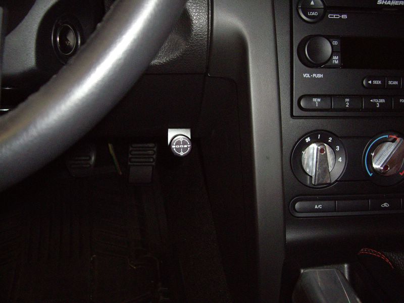

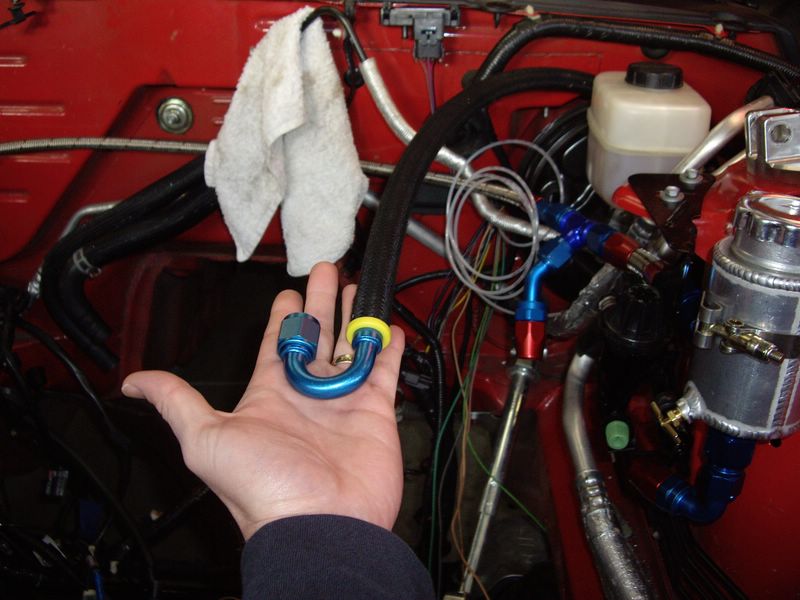

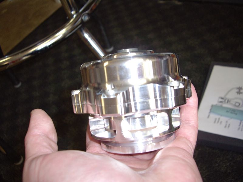

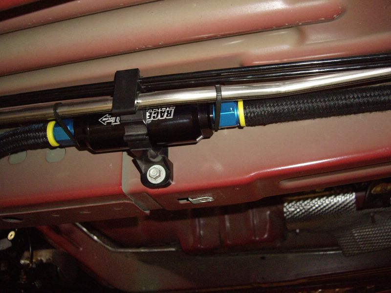

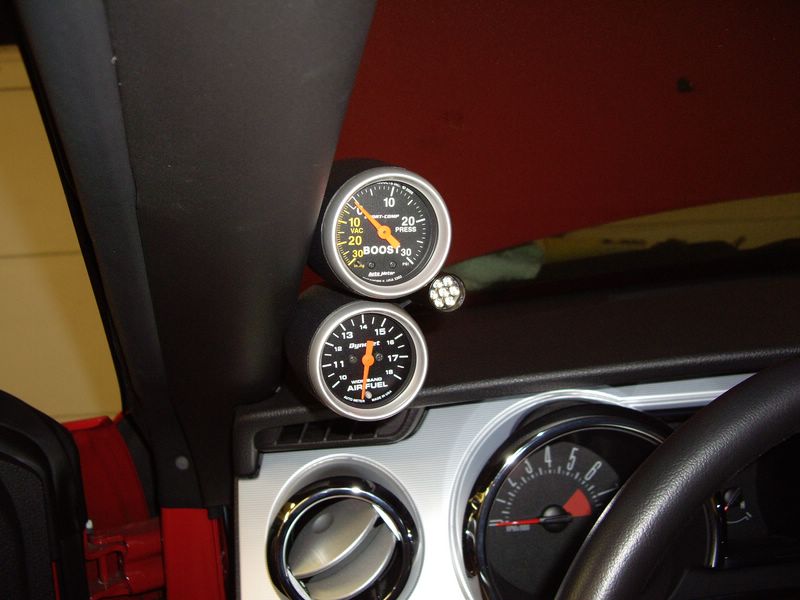

This is the 3rd boost gauge I have had in this car so I figured I better go with the 30psi just in case.
I am using a Hallman Evolution manuel boost controller with a **** that extends into the cab for easy adjusting. This one has a ceramic ball also.
I also installed an SLP line lock kit and a BMR K-Member while the motor was out.
