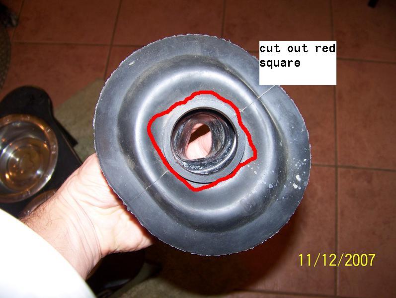

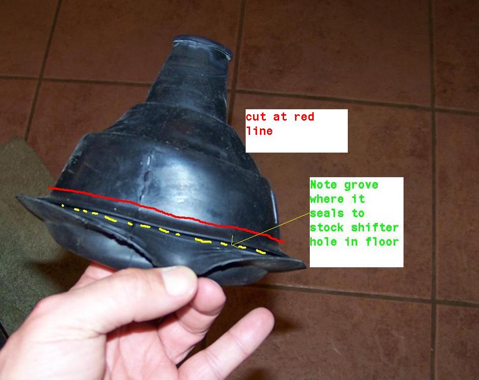

Yea, MGW is the way to go. One question I have yet to post, How does the dynamat, foam heat/sound barrier make it all water proof? I just dont see how it is.
Thoughts?

I followed Taco Bills Instructions except I modified my stock lower shift boot and reinstalled it instead of using the supplied DynoMat.
A few pictures below or follow the link to my detailed instructions for my minor modification to the installation instructions...
http://www.nextgenmusclecars.com/for...ead.php?t=2645
Attached Thumbnails C&L Street Intake & Brenspeed Tunes-stock-shifter-boot-top-mod.jpg   C&L Street Intake & Brenspeed Tunes-stock-shifter-boot-bottom-mod.jpg

I like your idea and read your instructions. Can you post the pictures? I don't feel like signing up on another messaging board Thanks in advance!
