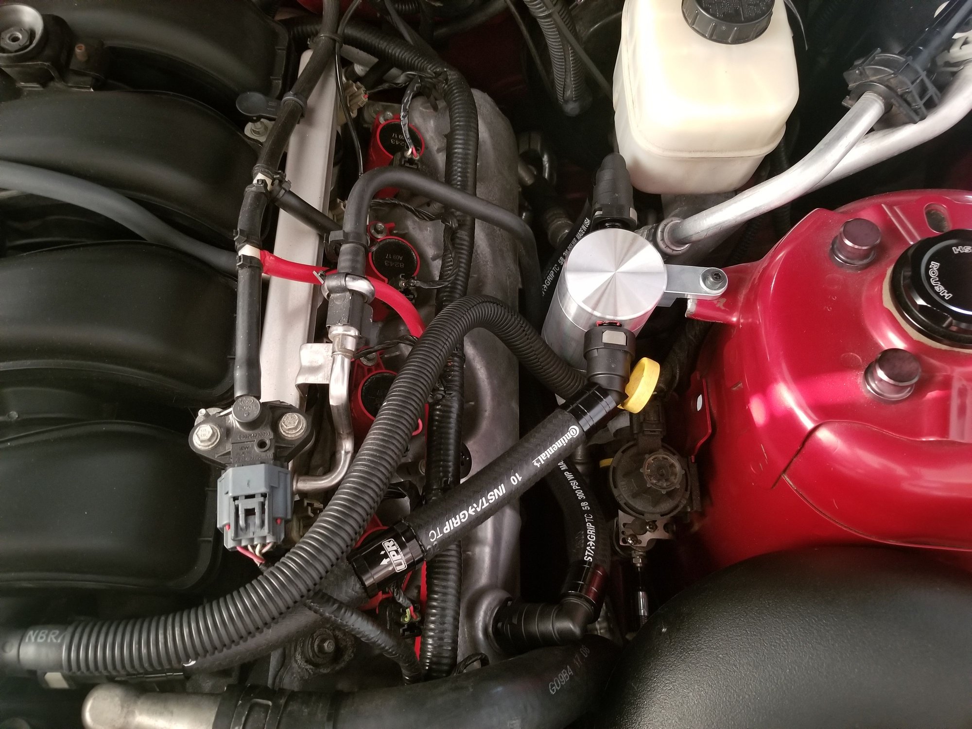

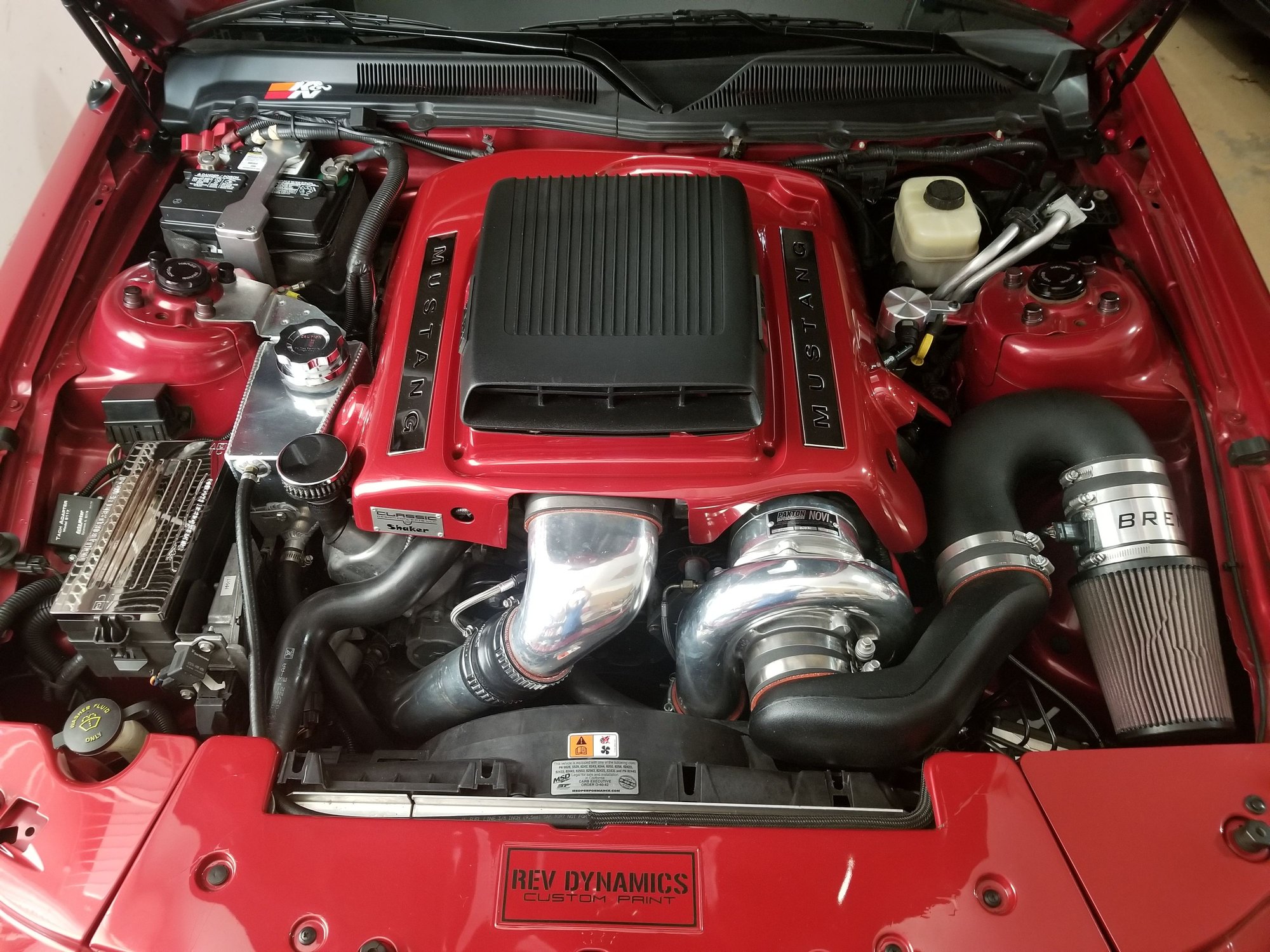

Alright, I got it installed. I purchased the UPR Universal can with there quickfittings and 5/8 lines. With my shaker system..I couldnt initially install it due to the cover not allowing me to place it where I wanted it. After thought and mentally committing to modifying (cutting the cover) I got it to work and I'm proud of how it turned out.

Congrats, and I'm also very proud on how well your modification of the shaker cover turned out. The hoses also look really tidy and nicely tucked away in the engine bay.. Meanwhile, glad everything worked out, as the UPR catch can sure looks really awesome in your "08" GT/CS and also thanks for following up as well

Nice clean looking engine bay. You did a great job hiding that and a very clean looking install, Especially with the tight space on you passenger side, where I assume you are connecting!

Thank you! Its connected from driver side valve cover to intake. All driver side. I don't even think I could put anything more on passenger side Haha

I know the 5.0 Coyote gets all of its blow by oil on the passenger side and no one is getting anything in the driver side cans. Is the 4.6L different with that? Noticed @m05fastbackGT also looks to have his on the drivers side too. I am not too familiar with that engine. But, you do have a very clean looking modded engine bay, looks sharp!

Thank you, for the 4.6...the dirty side is the driver side. So, I run a catch can on the driver side and an open breather for engine oil cap and valve cover on passenger.
The PCV valve on the older 2005-10 3v cars are integrated inside the driver's side cam cover.. They must be physically removed by cutting them out with a dremel tool before adding an open breather to the driver's side cam cover port, unlike the 5.0 Coyote models which have the traditional PCV valves on the passenger side that are interchangeable/removable.. This is exactly the reason my catch can is routed from the driver's side cam cover to the intake manifold.
Yes, that is correct.. The PCV/dirty side is in fact located on the driver's side for the older 2005-10 4.6 3v models..
