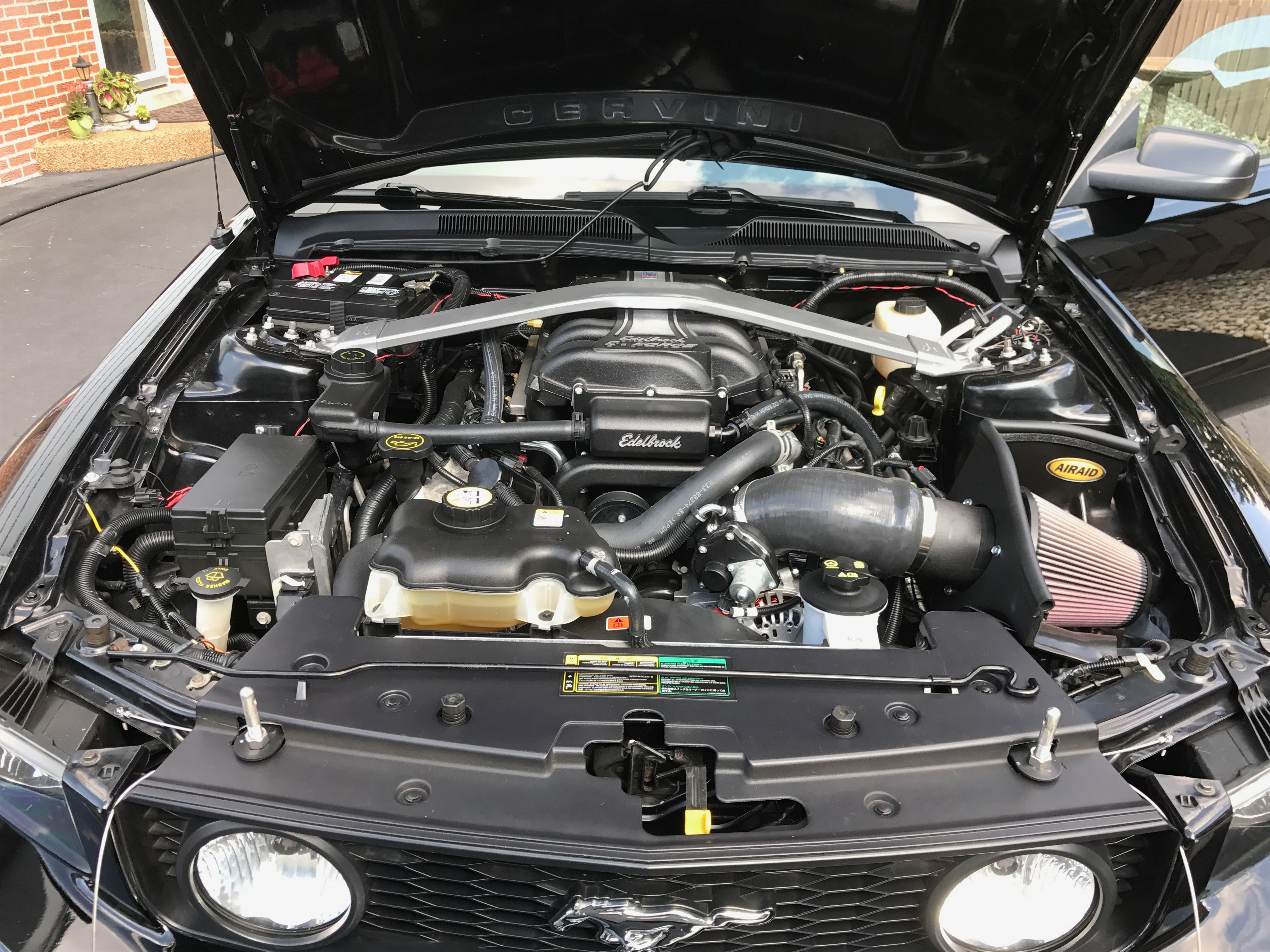

I installed the E-Force on my 05 Gt auto last June. The kit came from Brenspeed with everything needed. It is awesome. Excellent drivability and tons of power and torque on demand. 520FW HP and 450 at the wheels. The tune is what makes the difference. Don't get greedy and stay with what the stock drivetrain can handle and you should have no problems.
Joined: October 2, 2006
Posts: 4,777
From: Southeast Michigan
Holy crap, what kit did you buy? Stock they only produce 466-470 hp at the crank. Did you get a different pulley or something?
How was the installation process? I read the manual and didn't like how much modifying I had to do to the stock hoses/coolant pipe/wiring, but was curious how difficult it really was. How long did it take for you to finish? Did you have to get a new fuel pump?
http://www.brenspeed.com/efstage0.html
Installed this kit. It took me almost two days, but I have serious spinal problems and the "old" me, five years ago, could have done it in 10-12 hours. I am a retired carpenter and not a mechanic. The only help I needed was placing the blower unit on top because it weighs around 70#. The kit comes with a Keene Bell boost a pump which handles the higher fuel flow. Almost no modifying needed as everything is included. The only thing I added was a boost gauge in the dash. Love it!!!
