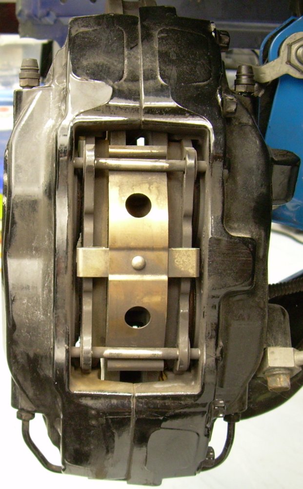

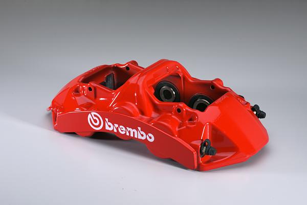

Originally Posted by jlmounce
the monoblock multi-pot design of the GT500 kit.
Technically the OEM GT500 calipers are not a “Monoblock” design.
The term “Monoblock” was I believe coined by Brembo and was the name they gave their calipers that are/were one single machined piece. Hence the term “mono”. The OEM Brembo calipers are a two piece design that splits along its length.
The advantage of a Monoblock caliper is that it is a lot more rigid than a multi piece design and in a lot of cases have a “brace” machined in above where the pads go that ads even more rigidity to the caliper. The extra rigidity offered by a Monoblock design does not add much to the overall braking power of the caliper but they do provide a lot more feel so they are easier to keep right on the threshold of lockup. Another design feature found in most Monoblock calipers (and can be had in non Monoblock designs) is that they are radialy mounted opposed to the “standard” caliper mounting.
In my experience a radial mounted multi piece caliper gives a massive improvement in feel compared to a standard mounted one and a Monoblock caliper will only show its benefits if it is used at 10/10ths.
There is also a pretty big price jump from a multi piece caliper to a true Monoblock (and a massive jump to a billet Monoblock). The cost/benefit ratio is not very good unless you are racing at the front.
For the most part I run multi piece radial mounted cast OEM calipers on my racebikes and with a good radial master cylinder (I prefer Brembo), braided lines and fresh pads they are more than enough brake to run within a second of the lap record at most tracks. The only times it has entered my mind that I wouldn’t mind a little more brake is when racing at Daytona and having to come down from 195 to about 50mph for turn one (Tri-Oval to infield) and the brake markers for turn five at Road America (180ish down to about 30mph). And even in those two extreme situations a Monoblock caliper would be a luxury not a necessity.
That being said I had a SBK spec set of billet (opposed to cast) Brembo Monoblock calipers on my AMA spec GSXR1000 and they were nice to have. Pads cost a fortune, but there was enough power to lift the rear tire at 150mph and enough feel to be able to trail brake to the point of tucking the front tire………without doing it. That’s what you would expect out of a set of $7600 calipers though (I didn’t pay for them).
The red caliper is a cast Monoblock.
The black one is an OEM GT500 caliper.
