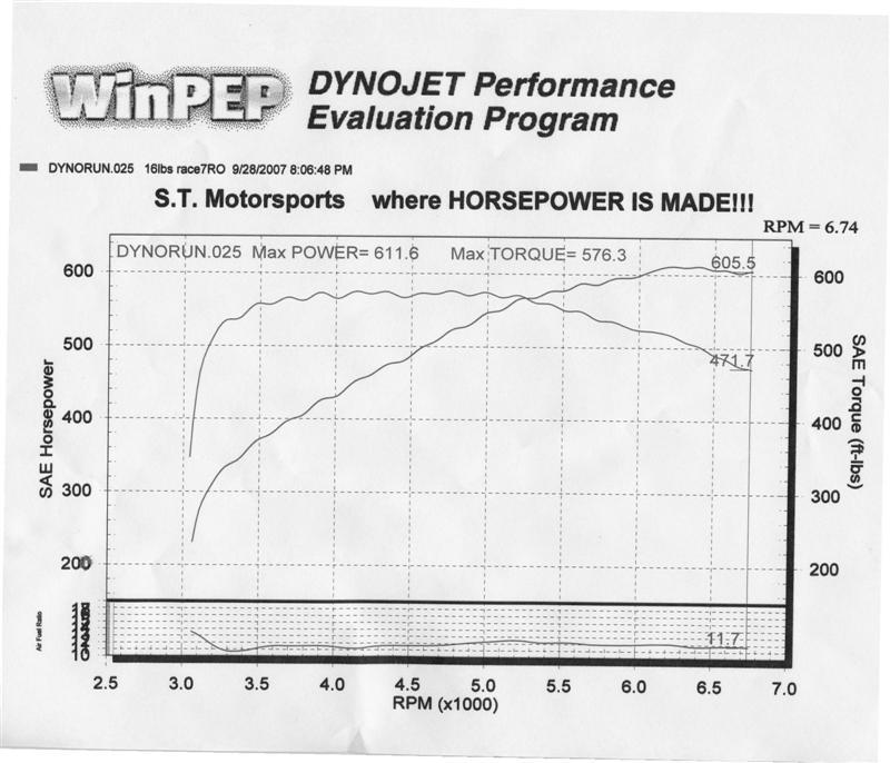

I just got back from ST Motorsports and had Adam tuning my new setup they built. 611 Hp and 576 Tq!! . Adam is the best. This was on 17 lbs of boost and goes down to 16 after 5000 rpm and it has an automatic. It has a 6 rib belt now. I guess I need to look into a new belt setup.
My new setup is a cobra crank, JE Pistons (low compression), H beam rods, head work, cams and a 2.3 Whipple. Adam also has installed his Bad a** air inlet setup.

That torque line is awesome. It heads straight north at 3k. What a gut wrencher. That's what it takes to get the car moving. This is why I like the twinscrews over the centrifigals. You wouldn't see that with them. Awesome!! Wonder how long the auto will like those numbers. I am pulling for it. Keep us informed.

torque curve on dyno sheet - EVIL! and it is good... Probably end up killing myself quick with those kind of numbers...
