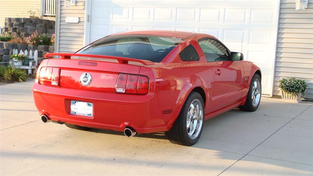

I'm running Nitto 555s, 295 in back 255 in front. Rims are 18x10 fr and 18x9 rear. Much better handling than stock, no following ruts either.
Attached Thumbnails 255/45s or 275/40s-copy-dsc00142-large-.jpg
