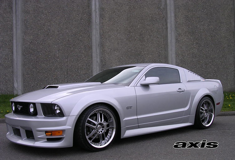

I've heard that while adding the look of a car, 20's can rob HP due to the larger diameter. Is it enough of a loss to not do it? Below is a pic of the wheels I am gonna get. What do you guys think? I don't see alot of Stangs with these wheels. Axis Matrix, 20x10.5 in the back, 20x9 in the front. Looks sweet, a little bit of a tuner wheel maybe, but def holding down the race look with the rivets Click pic to enlarge

This topic gets involved with regaurding to rotational mass.Depending on the wheel,composite rims,one componet is usually heavier than the other,the center of the wheel or the outer rim.It would be wise to check wheel weight before purchasing.
One heavy rim in particular is the Boss rim which weighs around 42lbs. each.They look awesome but by the time the crank turns each component in the drive line they have to push the weight of the wheel and the weight of the tire,combined weight comes to around 50lbs each(maybe more),times four... thats one heavy set up.

Maybe there is a happy medium in a 19" wheel, too?
I can call Axis tomorrow for you and get the weight on that wheel.

IMO, anything above a 18" rim is sacraficing performance. Granite with a forged wheel it is lessened to some degree, when you put more mass further away from its axis point, it takes more effort to get them rolling as well as more effort to get them stopped so braking performance is something else to consider. If you go above the factory tire OD, its just like putting higher gears in the rearend as well.
On sports car revolution they did a project Acura RSX and swapped out the stock rims for 18"s(I think), and they lost 7 or 8 hp on the dyno.

in the newest issues of 5.0 they have an article on testing a new GT and i saw a little side note talking about the car they used for the test lossing 10hp when the 20" wheels the owner had on it was dyno tested compared to another set they used. can't remember the size of the others though.

As for my dyno pull with 20", on a stock '07 GT/CS she put down
267.77 Max Power/ 284.72 Max Torque
How does that compare with smaller rims?

I don't think that the numbers on a dyno will change, as you aren't moving the car, just the wheels. It would be no different than having a 100 lb person dynoing the car vs. a 400 pound person.
But, once you get on the road, you are trying to move the weight of the vehicle. So, with bigger wheels, you have more rotational weight, more curb weight, and more rolling resistance (due to more rubber). This is where you get a "loss" of HP. Technically though, you don't LOSE horsepower, you just USE more horsepower to get the car moving, and to keep it moving.
Think about it this way: do you gain any HP by removing 400 lbs. from your vehicle...NO! You just use less power to move the car

Axis Matrix 20X9 weighs 28.1 lbs and the 20X10.5 weighs 29.75 lbs.
Here's the link to the weights on the Axis web site:
http://www.axiswheels.com/axis_wheel..._and_lips.html

Wheel size WILL effect dyno numbers.
Above numbers are right on par for a stock 05,06, but not sure on the 07's yet.
