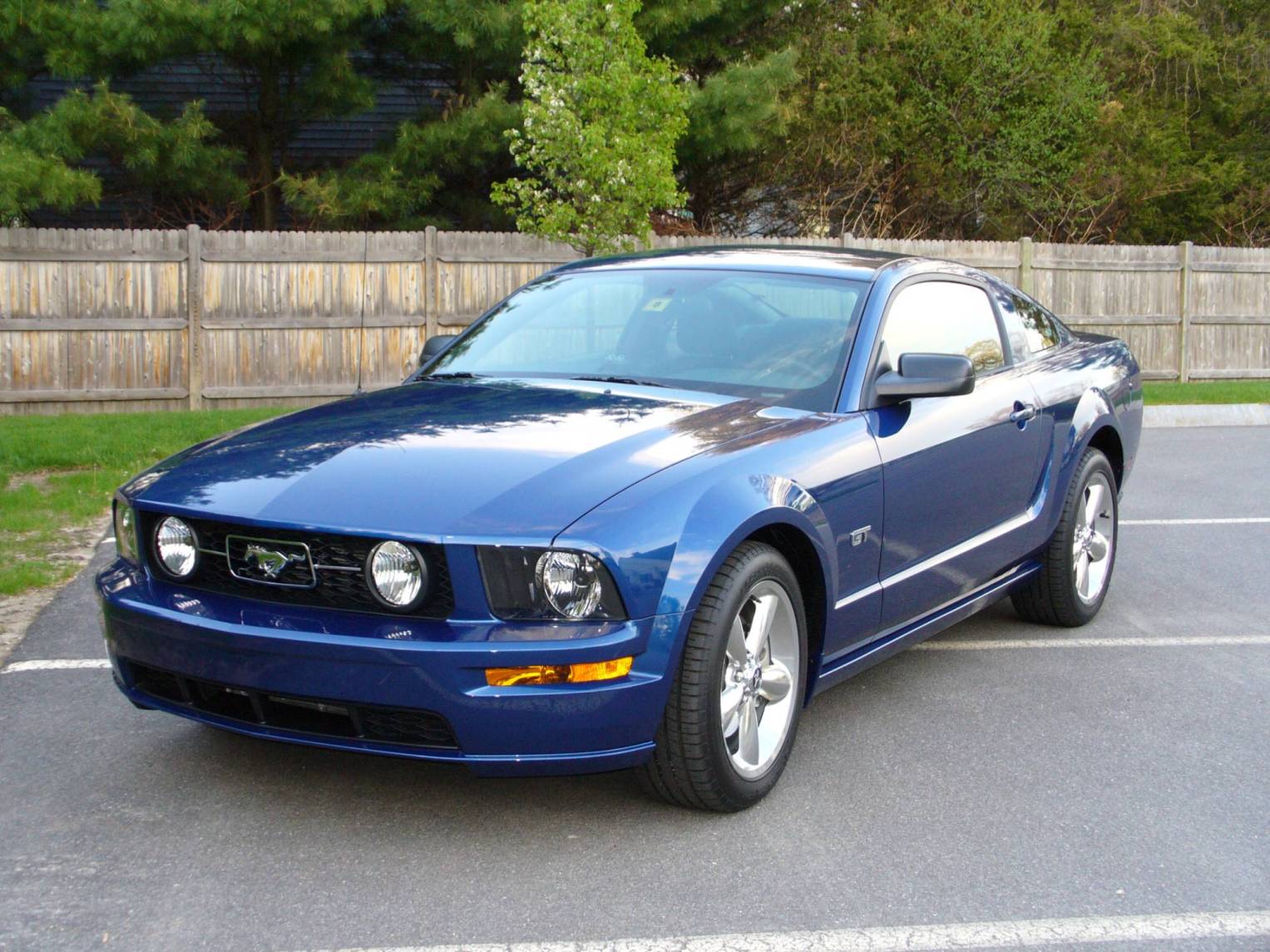

Take a drive up, check it out and you make the call then.
Attachment 10008
