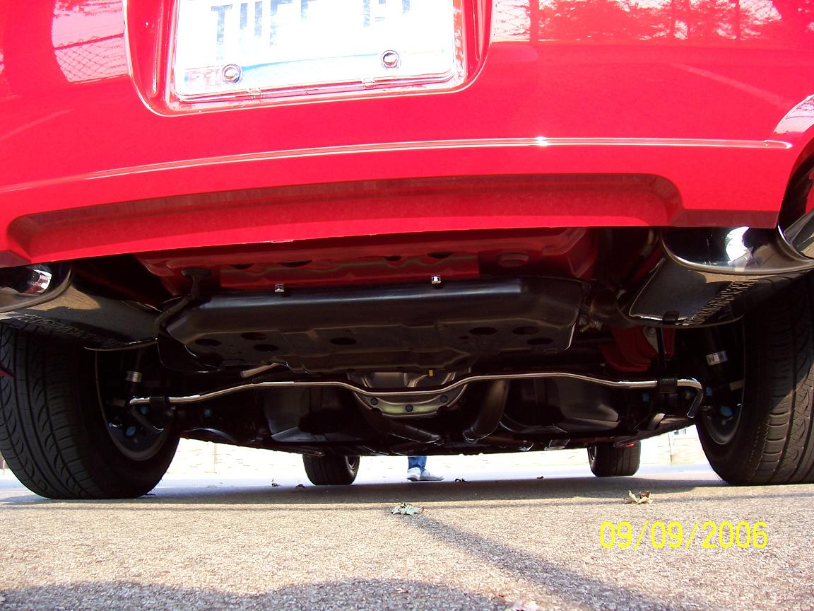

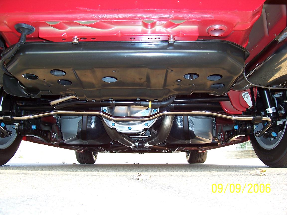

Originally Posted by GTJeff
I was looking under my car today and noticed that the back axle and some other parts were starting to rust. The car has not even been in the rain. Any ideas on how to deal with this... I was hoping to to keep the undercarriage in showroom condition?
Well it's been almost 2 years since that original post, now here is the end result:
Attached Thumbnails 2005-2009 Mustang Undercar Rust Detailing!*-undercarriage.jpg   2005-2009 Mustang Undercar Rust Detailing!*-undercarriage2.jpg
Very Sweet!!!! now I need to get mine cleaned up.
Looks real good.
It looks like new!
Great job!

So what did GTJeff do?
