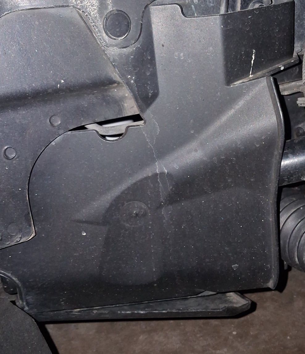

Has anyone here seen or know anything about these front wheel well covers? It's an extra cover that I've never seen before. Somone on FB posted it about it and I can't find them anywhere online. Any information would be appreciated.

I Have Cross Checked Various Years & Found Nothing. Exactly What Year is it and Which Engine??? Sometimes A Certain Configuration Will Have an Extra Shield None of The Other Models Have. Also Sometimes Early Cars Will Have a Part Which Was Deemed Unnecessary and is Discontinued. Example Early V6 05's With Alternator Heat Shield. It Came & Went! Sometimes Items are Flat Overlooked in Cataloging! Had a Bunch of Those When S-197 Was First Introduced. I Did Many an Inquiry To Ford Asking For Missing Items To Be Cataloged.
Why Was The Fb Poster Asking about Item?? Are You Sure Shield is on Both Sides?? Worst Case Should Have Embossed Numbers on Backside of Part.

Apparently his car came with them but is missing the passenger side. His car is a 2013 GT/CS. I've asked him to take the driver's side off and check if there are any numbers on it. Thanks for looking into it KC. Appreciate it.

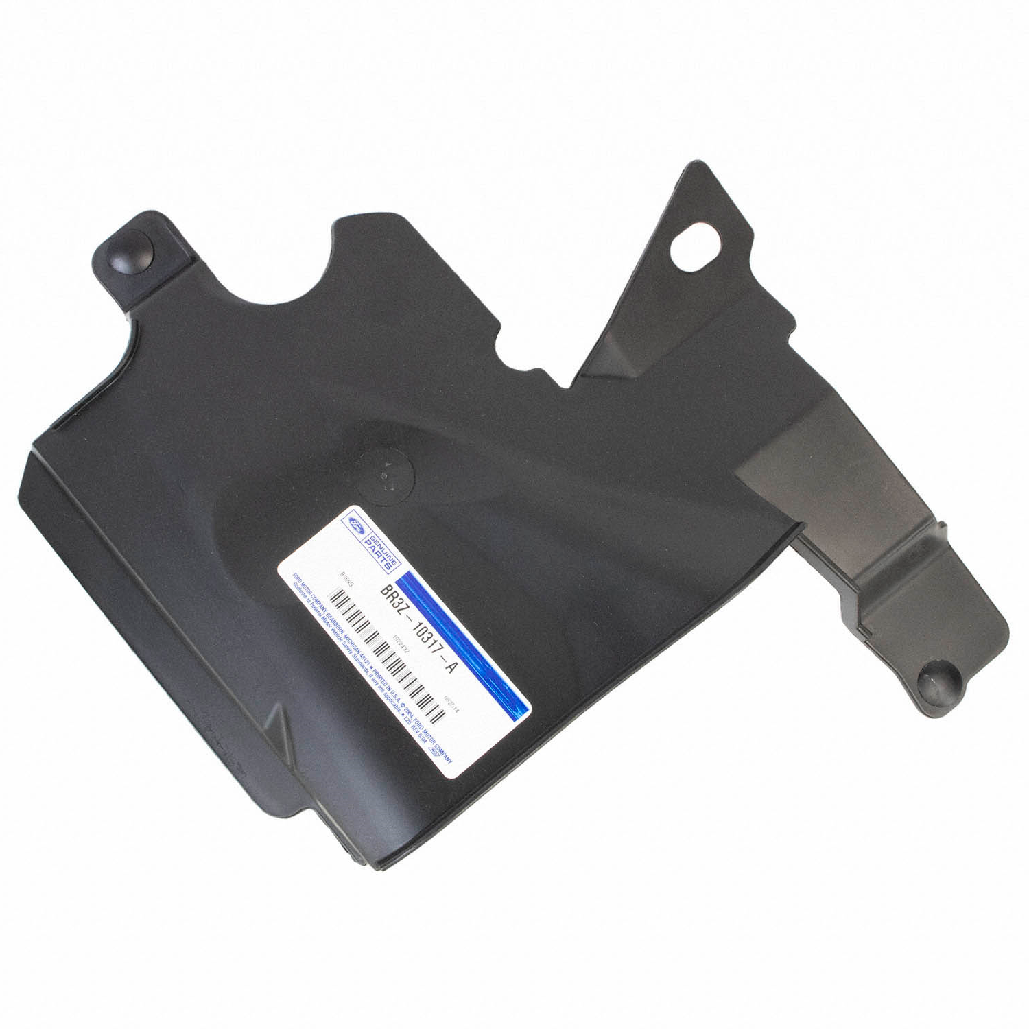

I Believe it Is The Alternator Shield and Would Only Be On Drivers Side.
His Pic Is So Close Up it Makes it A Bit Hard To Determine But Makes Sense! Front Mounting Tab is Longer May Be UpDate or His Was Broke Off at Far Right Clip!
See PDF For Parts Catalog Pic!
KC

Well, It's What I Did For 35 Years and I Just Know What Seems Logical With Ford Parts Cataloging Many Times is Not!
Trust Me I Was Tasked as Well Trying To Find This!
Well Your Friend Can Rest Easy Now!
