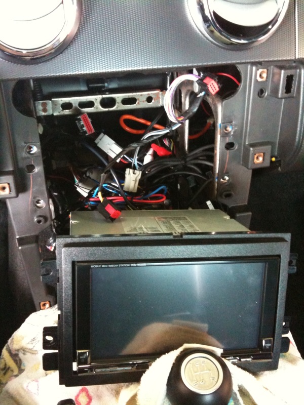

Got a chance to do fix and a mod yesterday on the TR.
As some of my FB peeps already know, I finally was able to get my front door subs working again! Gary and I have been PM'ing back and forth on this issue and came up with bypassing that 5V regulator alltogether. Well, it worked like a charm, now I have the door subs back.
Down side at this point is I get the amp 'pop' thru the subs when the system turns on. Not really a big deal.
After some surfing on the net concerning this issue, I found wiring kits (like the Crutchfield one) that include a 1.5k resistor that gets soldered inline with the remote turn-on wire. So this is the route I'll go if I start to get sick of that pop noise; they're only like 99 cents at Radio Shack.
(Not really showing anything here, just my mess.)

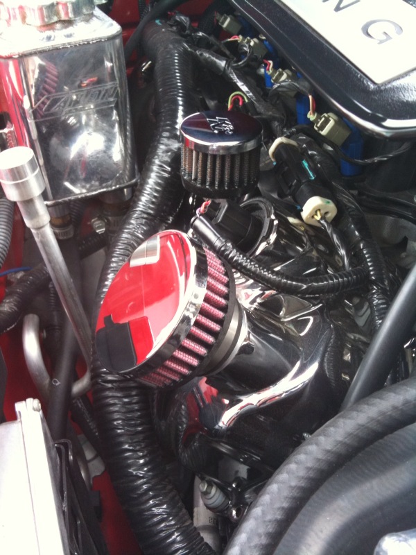

Mod.. Got a chance to install the oil filler cap breather. After seeing Brian's and Leo's, mine seems to be a slightly revised breather. Not only is the filter oil red, but it fits much more snug with almost no play in that billet connector to camcover.
Now hopefully, no more residual oil to clean up.

looks like a mess bill!

Bill, if you read this thread I posted a few years ago it has the info you need for the pop issue and the radio shack part number. If you have any questions let me know.
https://themustangsource.com/showthread.php?t=450830

Robbie, that's the v-regulator I had installed back when I put the Alpine in. Sub amps never got the signal to turn on. Looking back, I wired it backwards.
In thinking ahead, I routed the remote turn-on wire near the driver's side sail panel so I don't have to hassle pulling the headunit out again. I think the 1.5k resistor idea will work just as good (seeing they include it in kits), plus be a lot easier to solder than messing with those PITA 3 prongs on the regulator.
I'll get to this later on. After messing with this project yesterday, I don't feel like tearing into it again any time soon.
Speaking of which, I'll have to revise the Alpine how-to.

That was a good idea running it to the side panel, thats much better than pulling the head unit. And yes those little 3 prongs are a major PITA to solder!

It's a bummer you had to pull the deck Bill. I always dread pulling that thing out. With so many wires and little bxoes and RCA's and everything from teh stereo and all those sharp metal pieces behind the dash, I'm always worried something is gonna get stripped bare or something. Plus I had to put some washers behind the head unit to get it to set flush with teh black cover panel. Of course everytime I get in there I lose washers on teh carpet and bla bla bla.
Anyway. Congrats on getting some more bass/mid-bass back in the car.

Bill, I hear ya on not wanting to tear back into the system so soon, but I'd do it now while you still remember how everything is wired up and you know it will take like half the time this time... At least that's how it always is for me! LOL! Get it done and over with... Then you can start working on the A/C...

Well, since I had nothing better to do today, I did it.
Went to Radio Shack and bought a 5-pack of 1.5k resistors for only 99 cents.
Had Chris give me hand and soldered in the resistor.
And like magic, the pop is gone.
