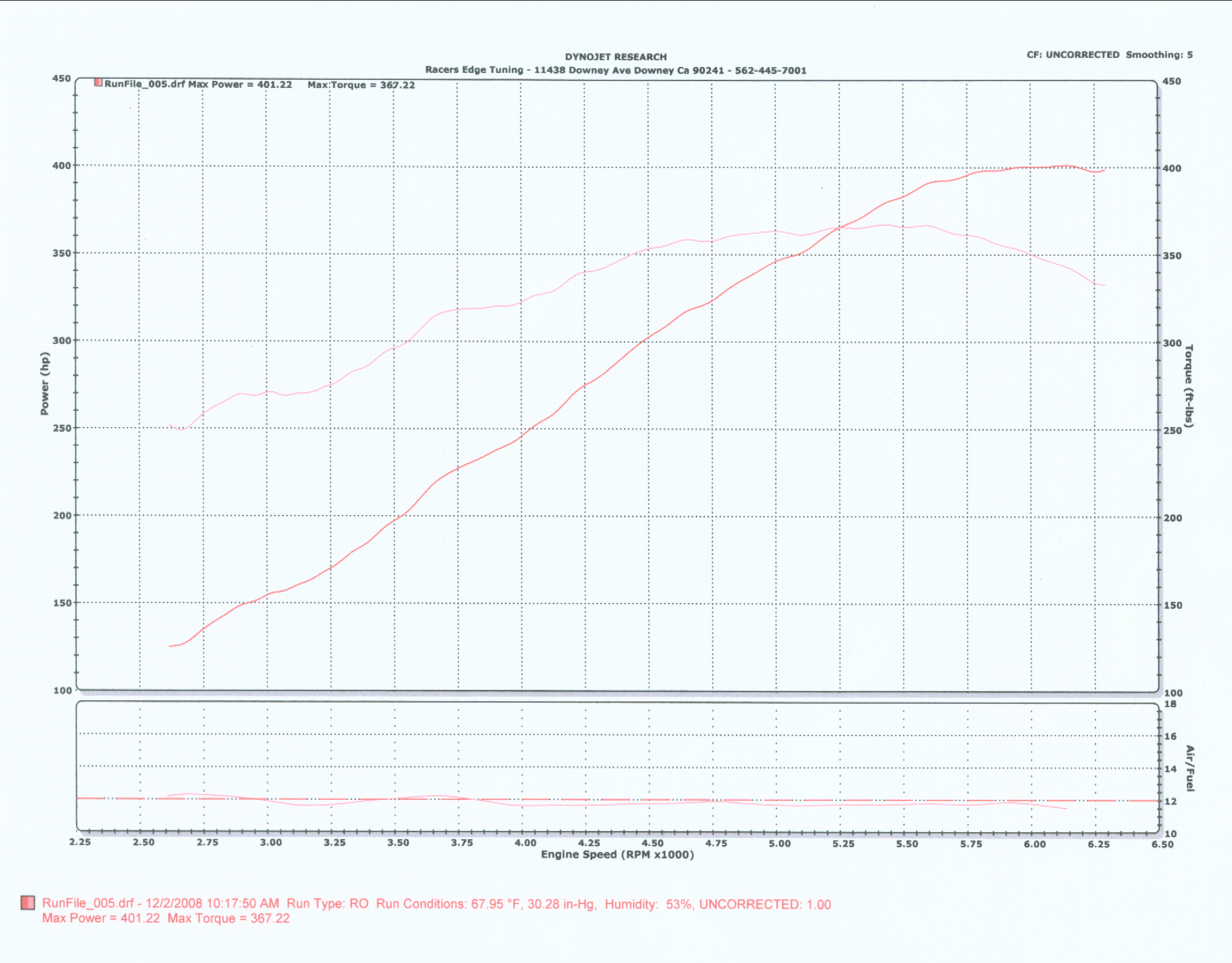

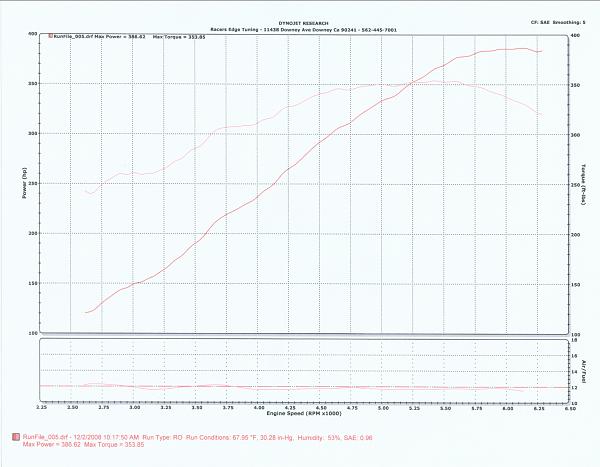

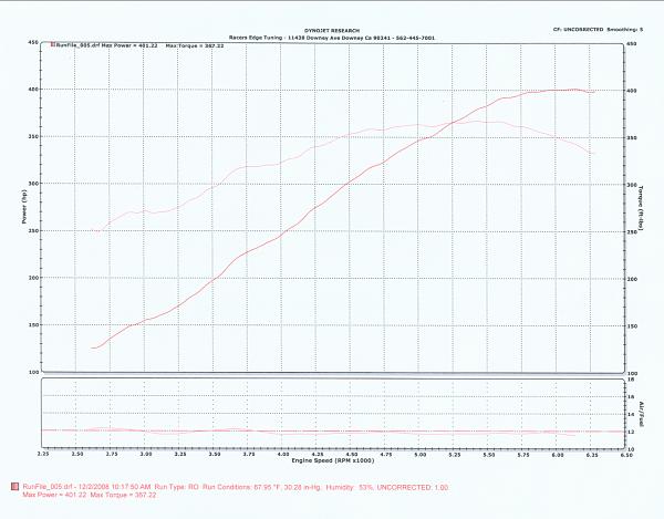

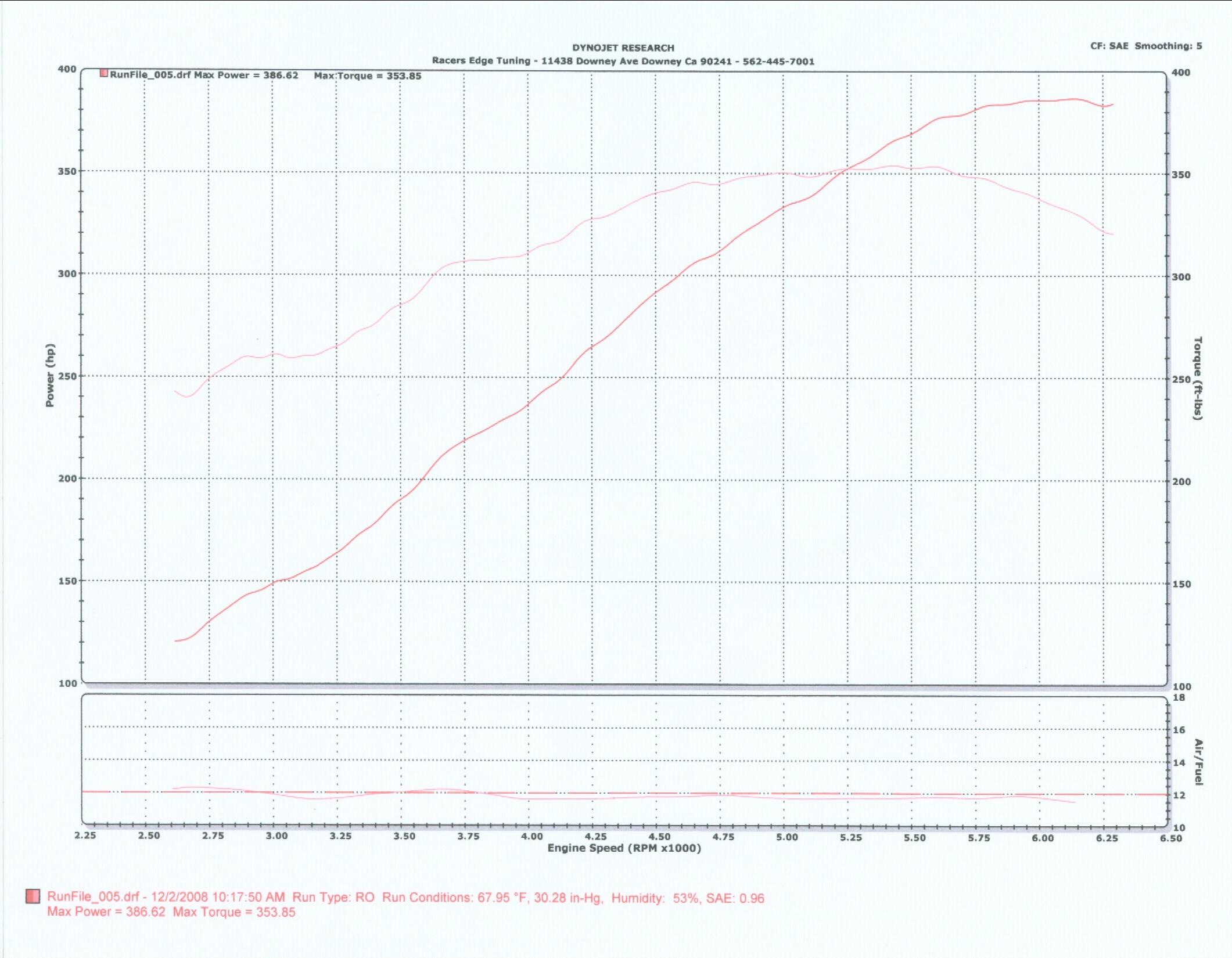

Back from RET!
She held together!
The video.. http://www.youtube.com/watch?v=JcdJ56kBixU
My criteria was that I want to drive it all day and drop the hammer at will with no issues, and this is what I got.
Q: Whats up with the low numbers?
A1: No intercooler (laugh away Brian & Leo). Without the IC, IAT was thru the roof, timing had to be pulled back, and more fuel had to be added to keep it safe. Greg made the decision to keep the A/F at 11.5 as well as pull timing and keep it conservative.
A2: Low compression forged pistons is hurting me right now at this given boost level (made 10 psi today) and being non-IC'd. Greg said that 0.1 in compression ratio equates to around 10hp, so that makes sense in comparing my 9.0:1 versus 9.3 or 9.4:1 factory.
Q: What happened to the Brenspeed tune?
A: We loaded it for 1 pull. It made more power/torque than RET's tune, but Greg shut it down at around 4500-5000 rpm's because timing went to ~18deg and A/F at 12.5ish. No doubt the Brenspeed tune is very aggressive and will probably produce the advertised numbers, but Greg advised against running it because he didn't want to see me pull my motor for the 3rd time.
Q: Can I run a smaller pulley and install an IC for more power?
A: Yes and yes! In fact Greg said that my motor can sustain 16-18 psi of boost and run a more aggressive timing ONLY with an IC, then will my 9.0:1 pistons will start to shine.
Q: So what's stopping me from upgrading?
A: Duh.
So in summary, all appears to be running good and the car feels hella fast to me. It's nice to finally have closure to my bad mojo.

Almost forgot to post the graph..
Attached Thumbnails Ponies on The Run!-dec_02_001.jpg   Ponies on The Run!-dec_02_002.jpg
