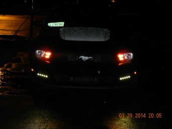

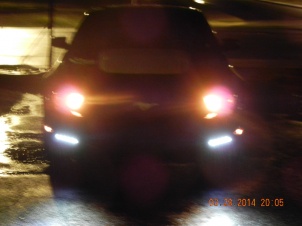

The finish look on these Raxiom DRL’s is amazing. This Raxiom kit is beautifully put together and well-worth the exterior upgrade, especially for those who don’t have fog lights. The lights are LED’s and are extremely bright when the parking lights are not on. Remember, these lights are always on once the engine is engaged so during day light hours, and with the headlights off, these DRL’s are very, very bright.
I was amazed by the brilliant white light emitted by these two LED lights. The kit is wired to turn on automatically when the key is turned onto the on position even if the engine isn’t running.
Raxiom even went a step further and added this amazing second feature: when one engages and turns on either the parking lights or headlights the DRL’s automatically reduce its light output and dim. The DRL’s are still on however there just not as bright because at night time it would cause issues with blinding oncoming traffic.
Remember, these LED’s produce a brilliant white, bright light! The DRL’s fit flush up against the bumper. Raxiom did an impeccable job at making it look like an OEM finish.

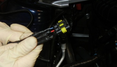

Jack up the car a good six inches or higher and use either jack stands or place a 6 by 6 block of wood under each front tire. Turn the emergency brake on and place a piece of wood behind each of the rear tires. When removing the lower belly panel there are a total of 9 screws that need to be removed. Use a 7 mm socket.
Have control monitor hooked up for bench functional test prior to installation (testing DRL’s for them to turn on.)
The purple wire is for the illumination supply (next to fuse box in engine bay.)
The blue wire goes to the purple wire in order to illuminate lights. (Next to fuse box in engine bay.)
The control module box has three colored wires and are numbered the following: Black wire is 1, Red wire is 2, and Blue wire is 3.
The blue wire gets connected to the purple wire.
When cutting into the bumper please take your time. It’s better to make too small of a cut because moving forward and bigger is easier. Once the cut is too large, there isn’t any going back. Highly recommend using metal grinding bit to shave plastic down for a perfect snug fit after the original cut has been made with the Dremmel or air saw/small hand saw.
