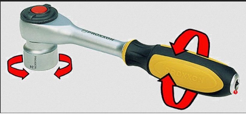

Anyone ever seen one of these tools? I just bought one and thought I'd share.
https://chadstoolbox.com/search.php?...eid=734ec9c1f0

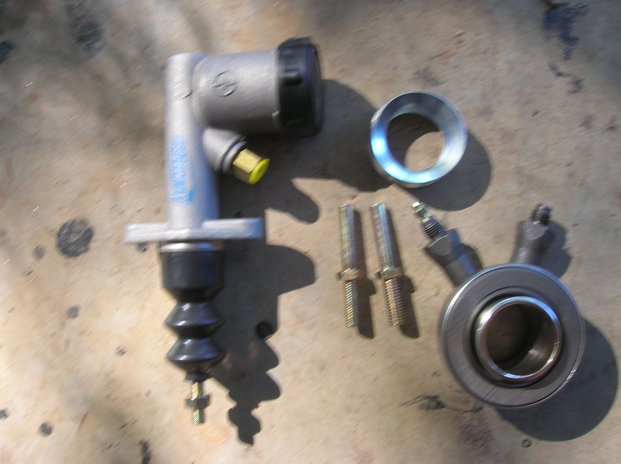

well i have given up on trying to make a cable operated bell crank type clutch work .. i have purchased a hydrolic throw out bearing set up .. little disappointed i have to make my on hose setup but i can do that . i will have to butcher my firewall a little bit .. dropping the trans was not a big deal .. gravity helped a lot .. lifting it back up will be .... i have pictures but dont know how to get them from my camera or my phone .. i will work on that ..from what little i got to drive the thing with a 5 speed it will be a blast someday ..

finally remembered how to add a picture from my camera .. got to write it down i guess .. i have the hydraulic master cylinder mounted and i think it is correct .. i have not put things back together yet as i have having an issue with the throw out bearing clearance .. it is suggested that there be 1/8 th inch spacing between the bearing face and the pressure plate fingers and they give you a ton of spacers to set the gap with .. well i dont have a gap to begin with .. everything is too tight .. i am having to fabricate trans spacers to back the trans off a bit .. i bought a fluid feed line but have to get the bleeder line ... just dragging my feet .. dreading how i am going to get the trans back up into place ..and not feeling well most of the time does`nt help ..

a bit of an update .. i ended up pulling the engine back out in order to install the trans back on it .. got it all put back in and hooked up all the hydraulic hoses and bled everything and had no clutch . it would start engaging a little bit about an inch from the floor . it was too cold one day .. was not feeling well another day .. was discouraged a few days and let it sit for a month .. i decided i needed to change the pedal ratio and the pushrod length so i took the plunger out of the clutch master cylinder ..it got cold again and i said screw it !! I`m gunna put it back together and push it outside till warmer weather .. after putting it back together it started working .. i can only suspect that the plunger on the master cylinder was stuck over half way down and not pushing ant fluid .. i have only driven it a little bit and need to put more confidence miles on it but that will have to wait for warmer weather .. it is a blast with the 5 speed .. ..
