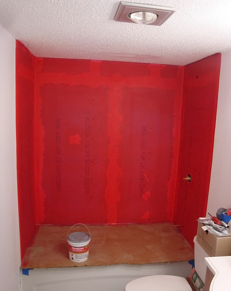

These are the walls after the backer board and about 4-5 coats of Redgard :

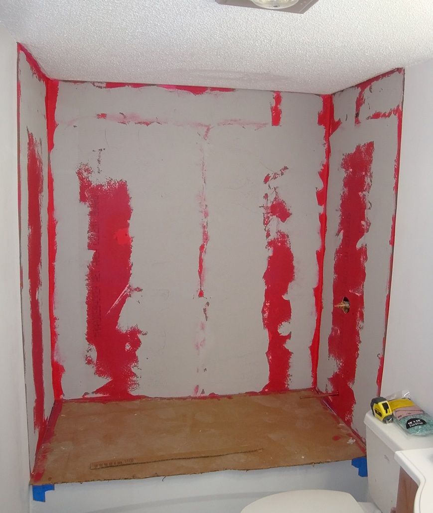

Apparently the areas where joint compound went down ended up getting raised a bit, so I used the tile adhesive stuff to try to level-off the walls before the tile installation :

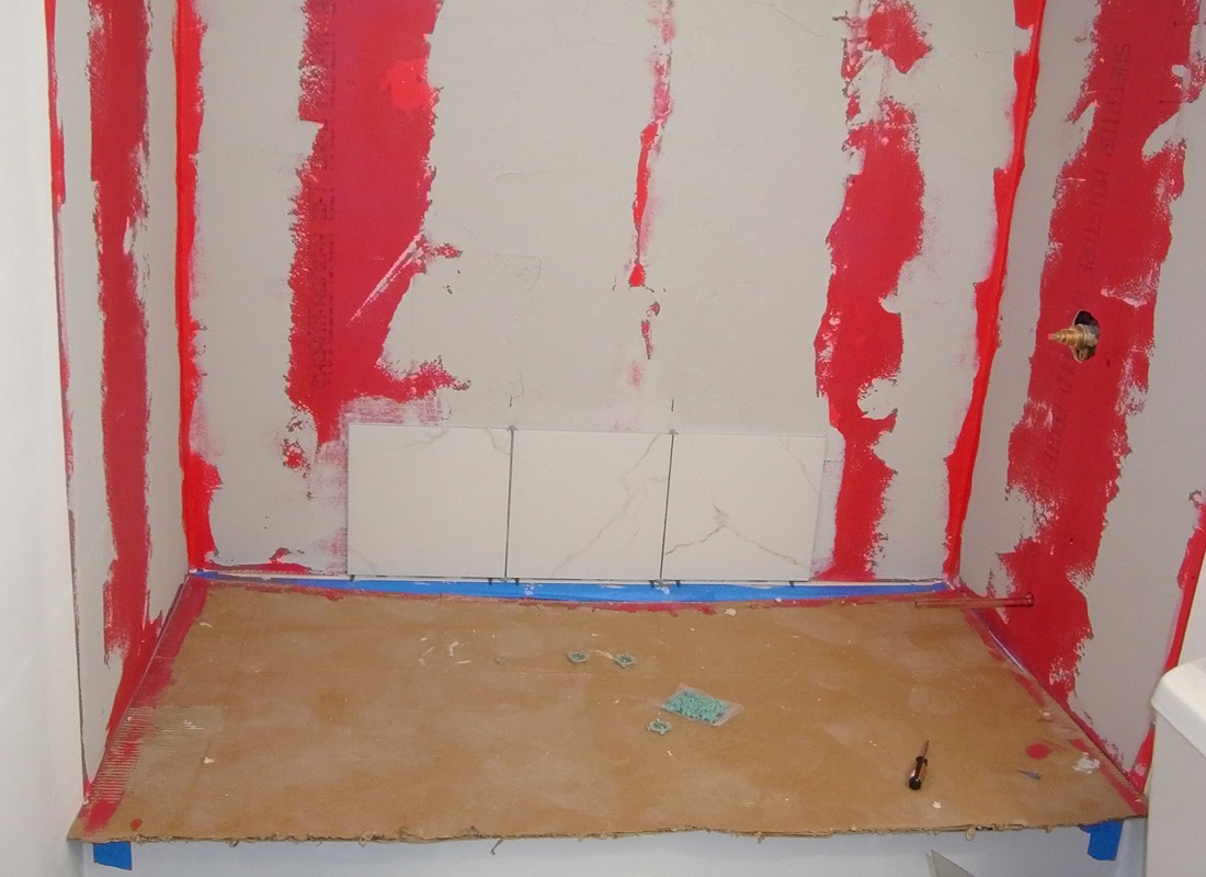

And yesterday I started installing the tile. Still not sure if I was supposed to let the tile basically sit right on the tub, but I plan on grouting the bottom, then caulking it.
