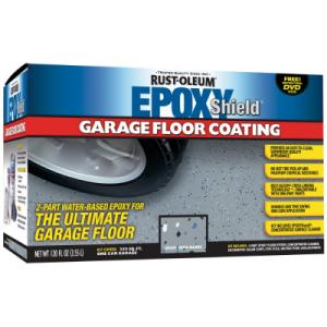

thanks for photos Glenn. I am sold! As soon this weather breaks (which won't be for a couple months), that will be my first outside project... followed by finally getting my heater installed so I can actually do some modding when the weather gets crappy without having to deal with all the fumes from my torpedo heater. I made the mistake of picking it up too late and now I can't do the venting until things warm up!
Hey, where is Lockport?? I am just north of border between Kenosha and Lake Geneva.
I assume this is stiff, right?? $64 at Home depot!

Old Jan 13, 2009 | 08:20 AM
yep thats the stuff. Lockport is about 25 miles or so south of Chitcago.

I was looking at getting that stuff but my concern is how slippery it will be when it is wet. Especially in the winter after snow has melted off of the car. Last thing I want is my wife to wipeout and break something just because I wanted a cooler looking garage floor.
Old Jan 13, 2009 | 08:27 AM
you can spread some play sand or other anti slip stuff on the wet paint so you wont have that problem.
http://www.rustoleum.com/CBGProduct.asp?pid=16
click download label for instructions.
