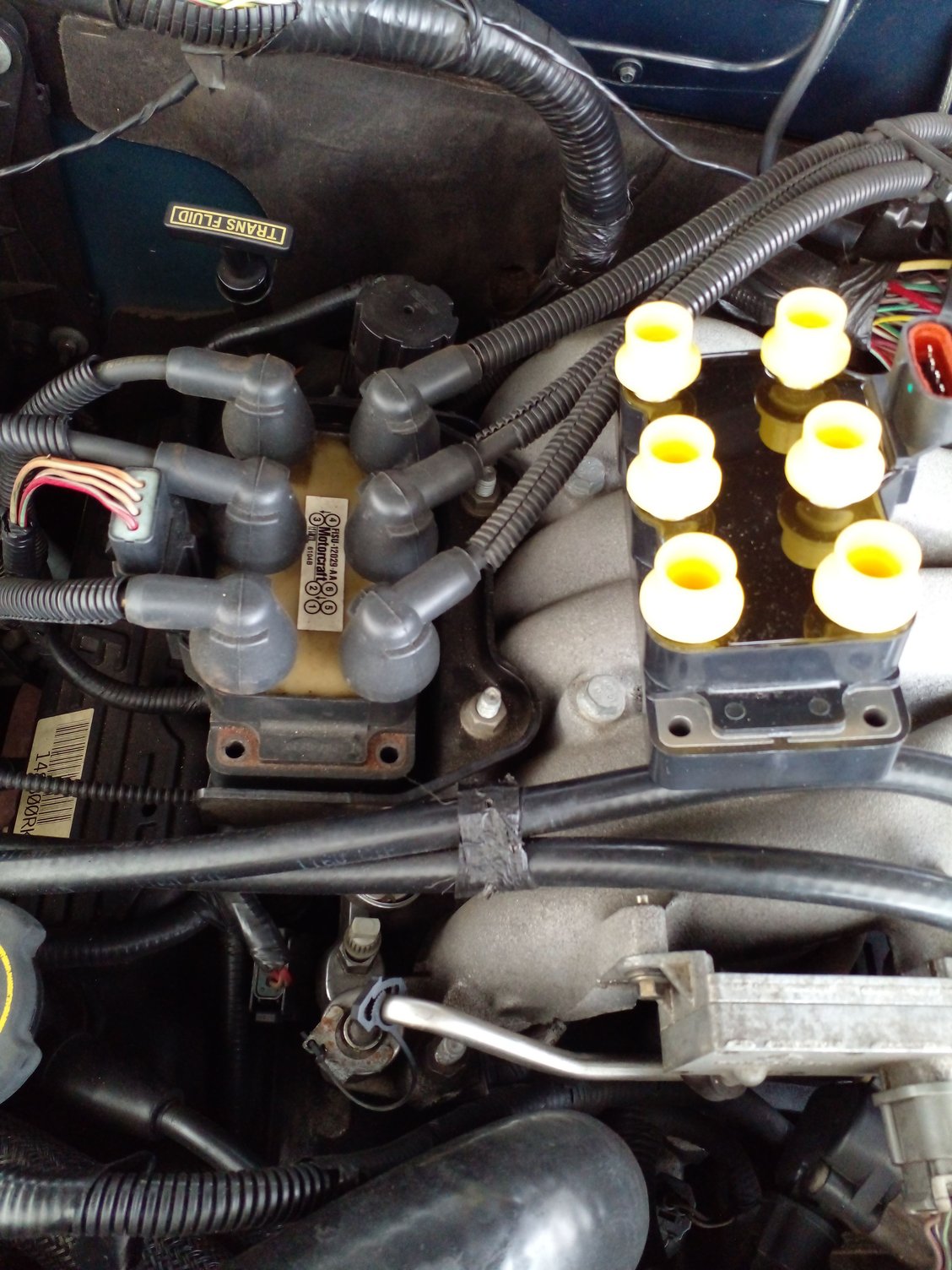

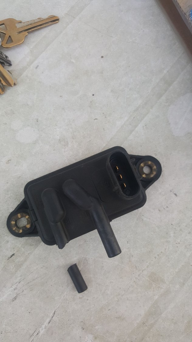

Guess I found the rough idling problem.
I replaced it with the metal one that came off the explorer intake I put in the Mustang. Fits like a glove
Started right un and ran smooth.
DPFE sensor ftw.

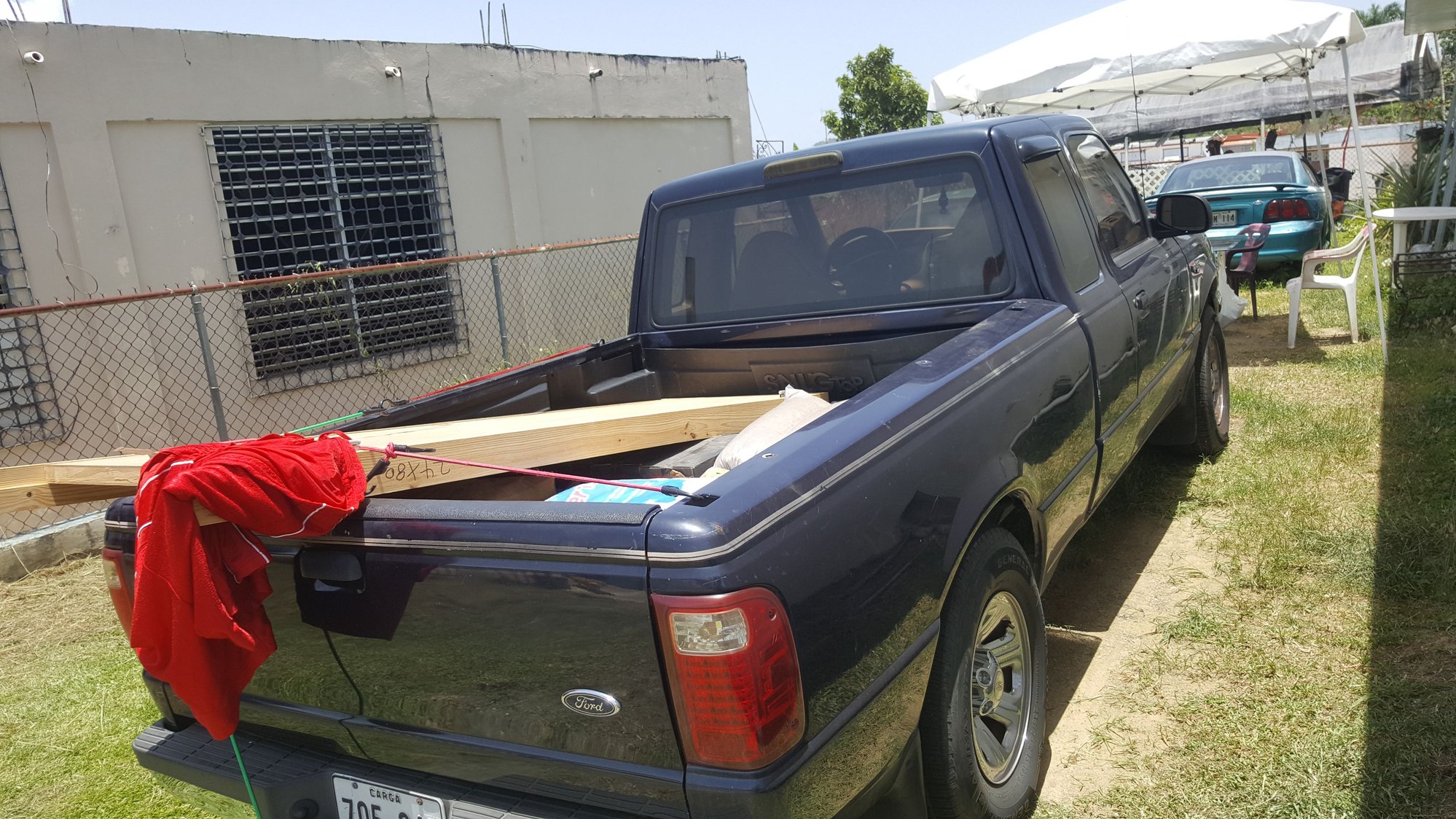

Put this thing to work. 😁

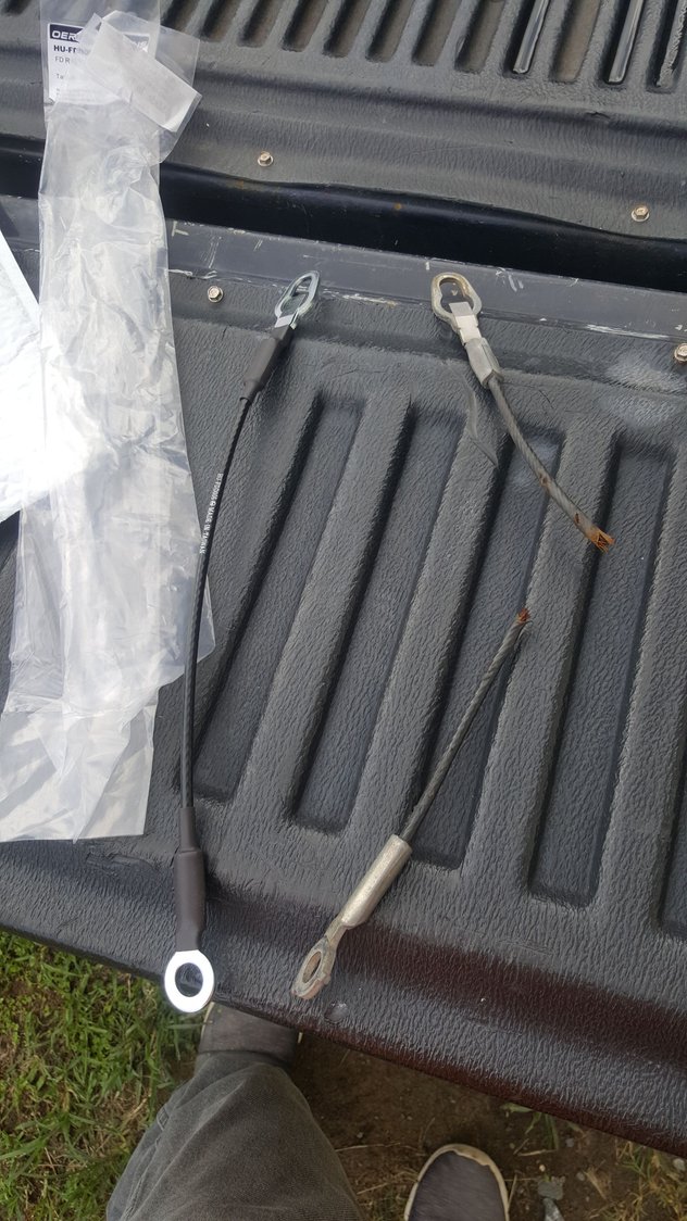

Replaced the tailgate cables today. The right one snapped and since they were OEM the other one wouldn't be too far from breaking.

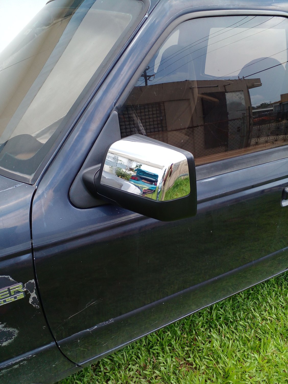

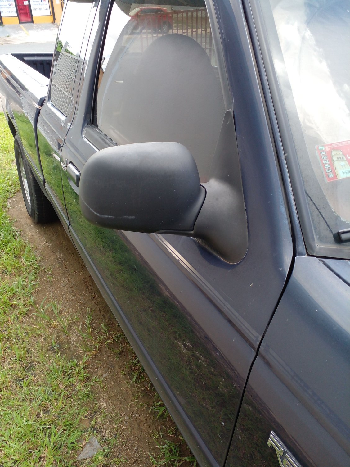

06+ mirrors are done. I ordered a new switch since that's why they didn't work.

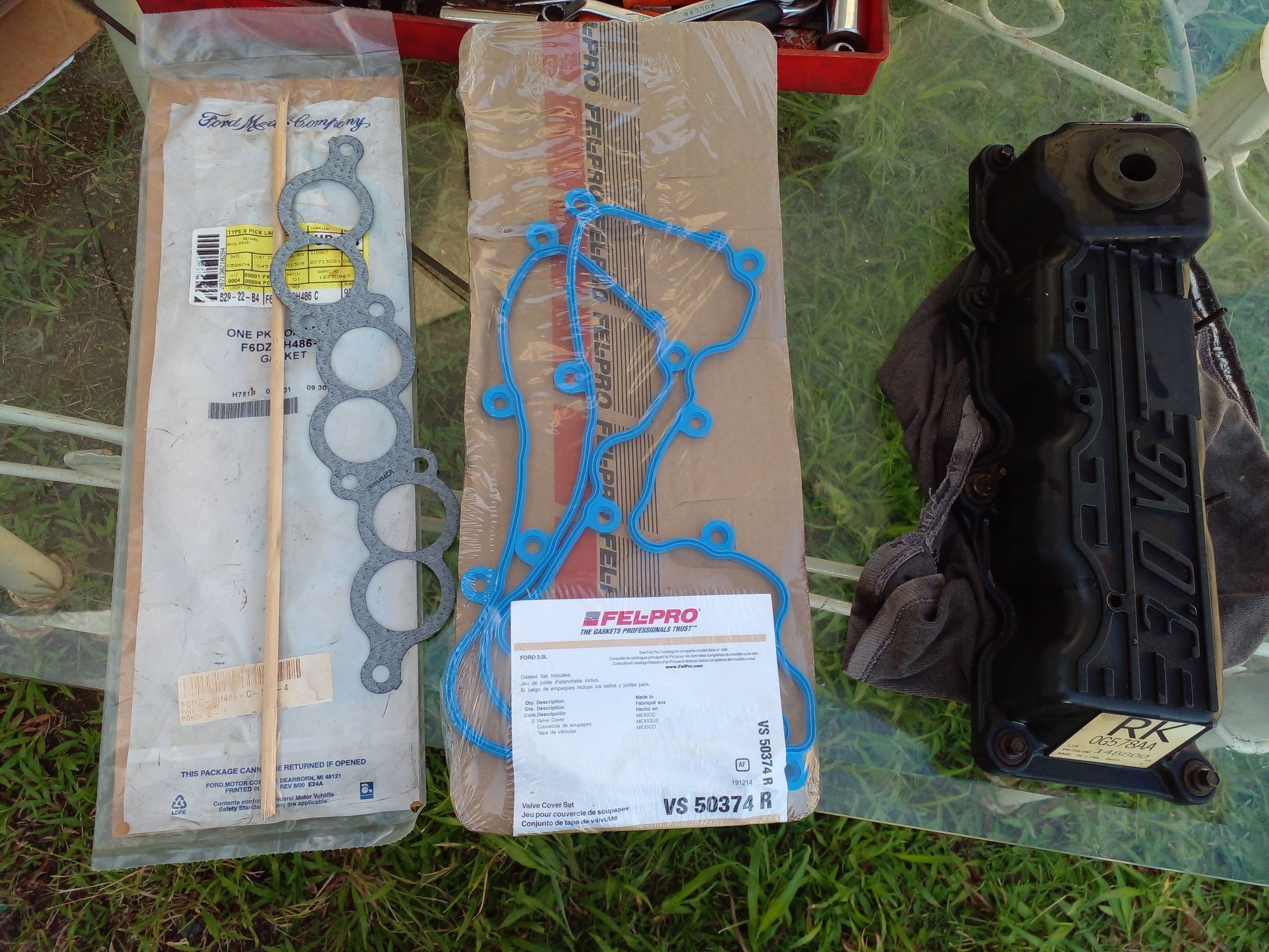

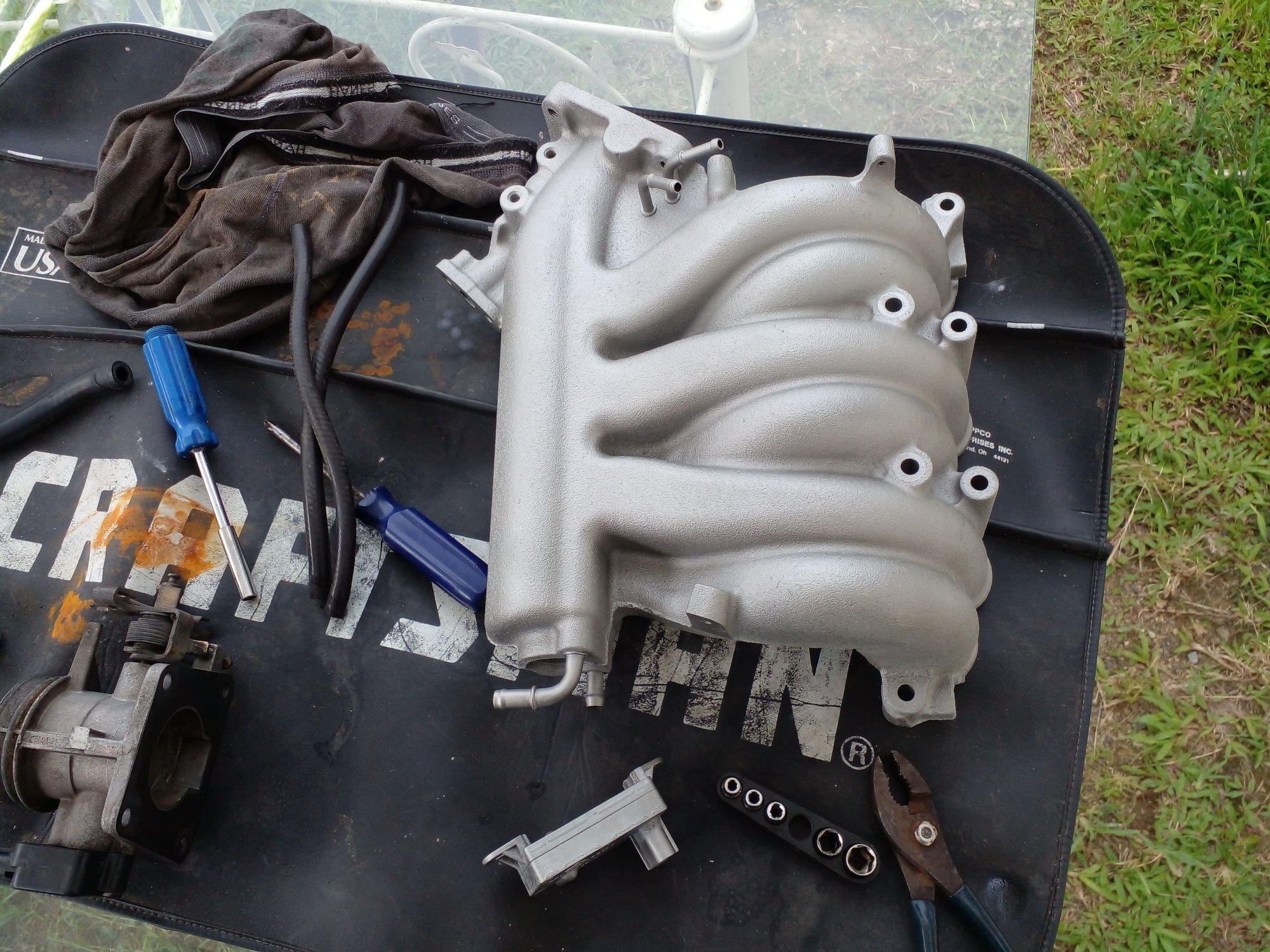

I'm doing something lol.
I'll finish it tomorrow. I want to clean & paint the intake plenum since it looks way too dull to my taste. I also have the Motorcraft 02 sensors for it.

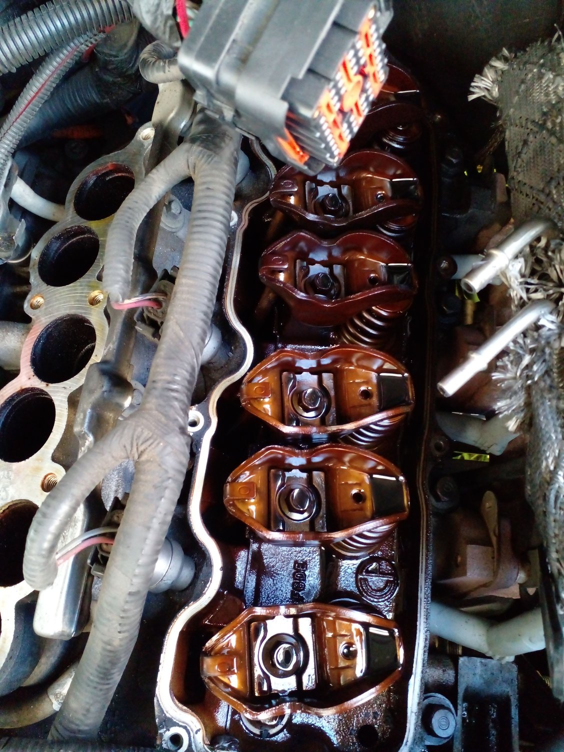

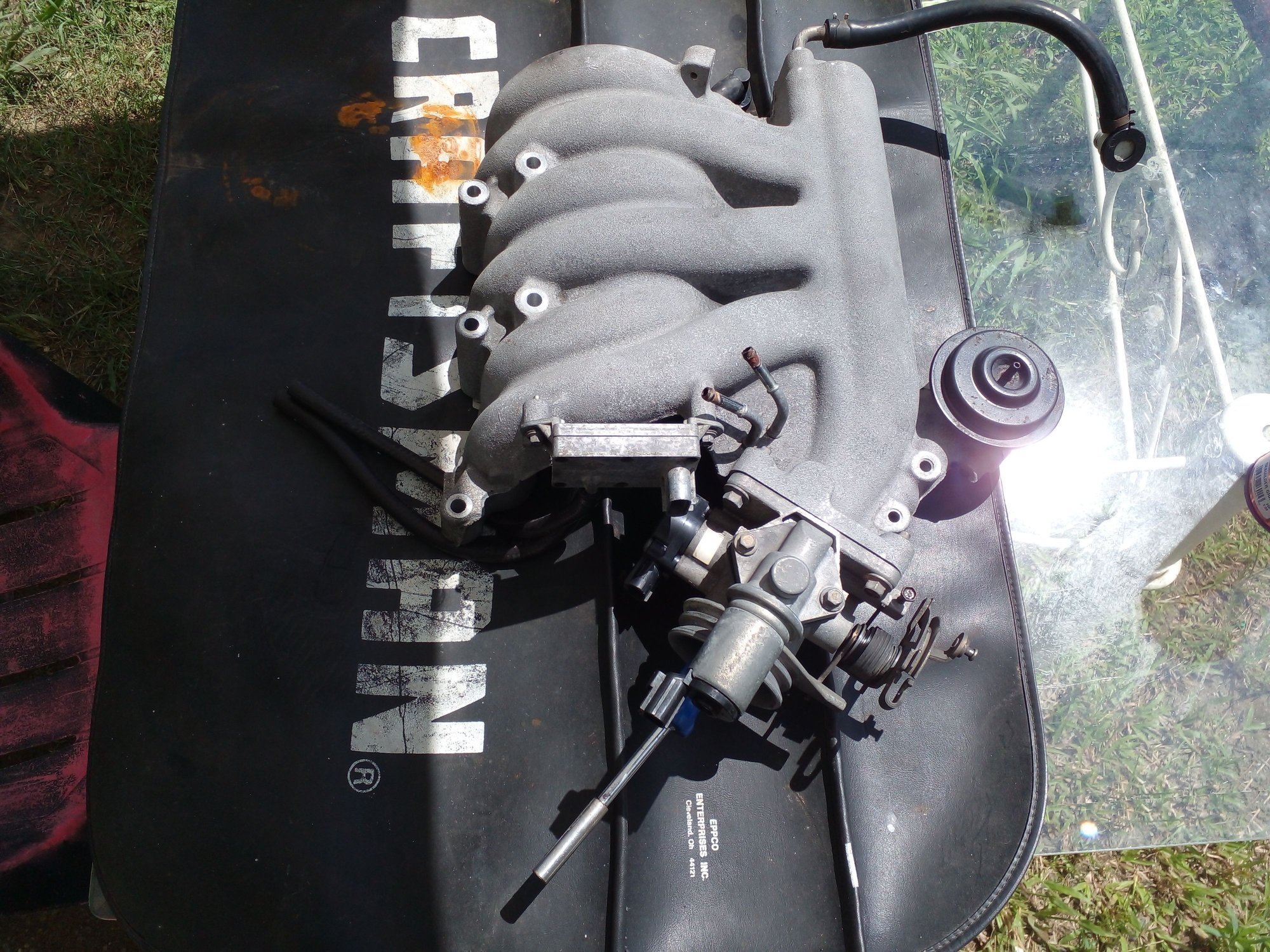

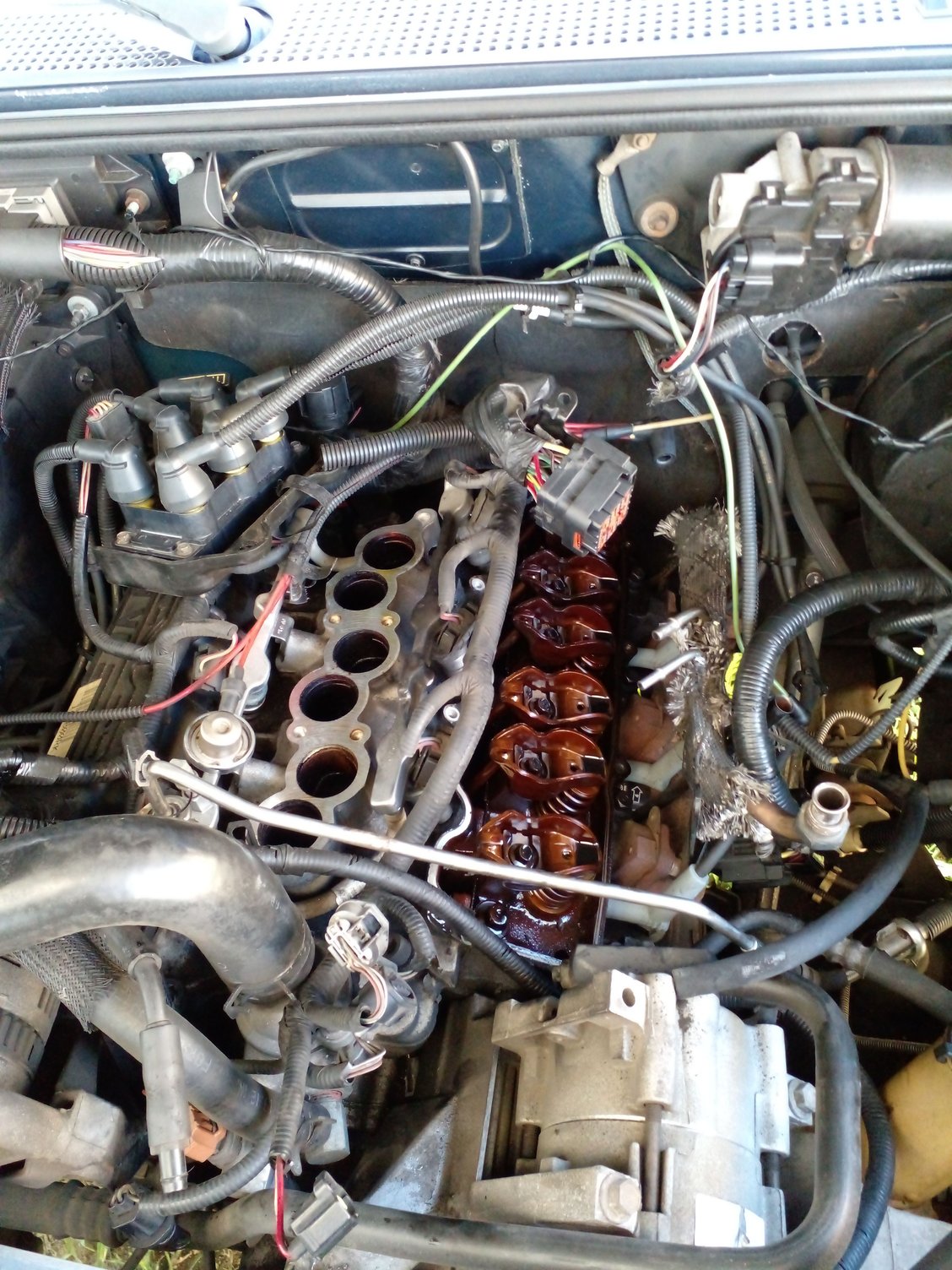

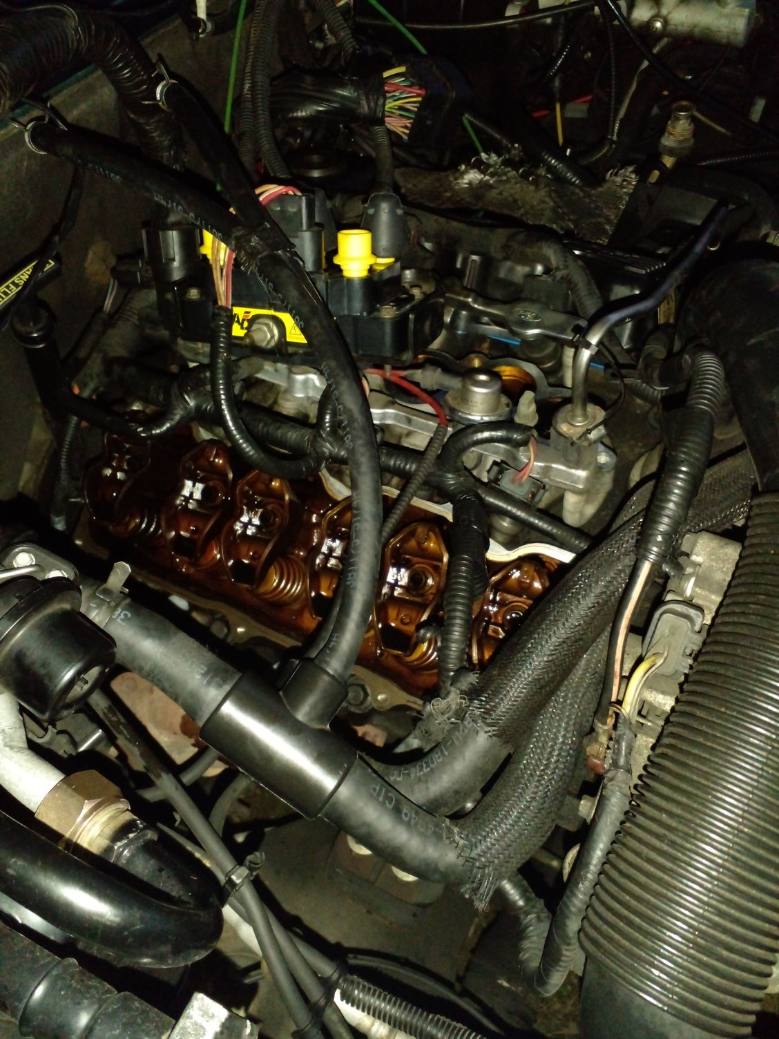

Finished installing the valve covers & plenum. Looks better with the rebuilder gray paint. 😁
Before:
After:
Gave it a good cleaning. Enen to the IAC motor & throttle body.

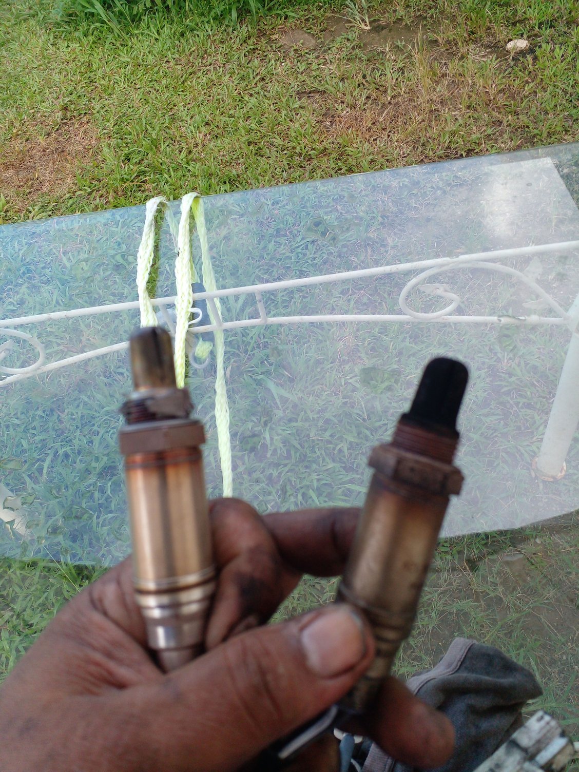

Upstream 02 sensors are done. Passenger side was the culprit, but since I had new Motorcraft sensors both were changed.

Power mirror switch done. They work as intended.
