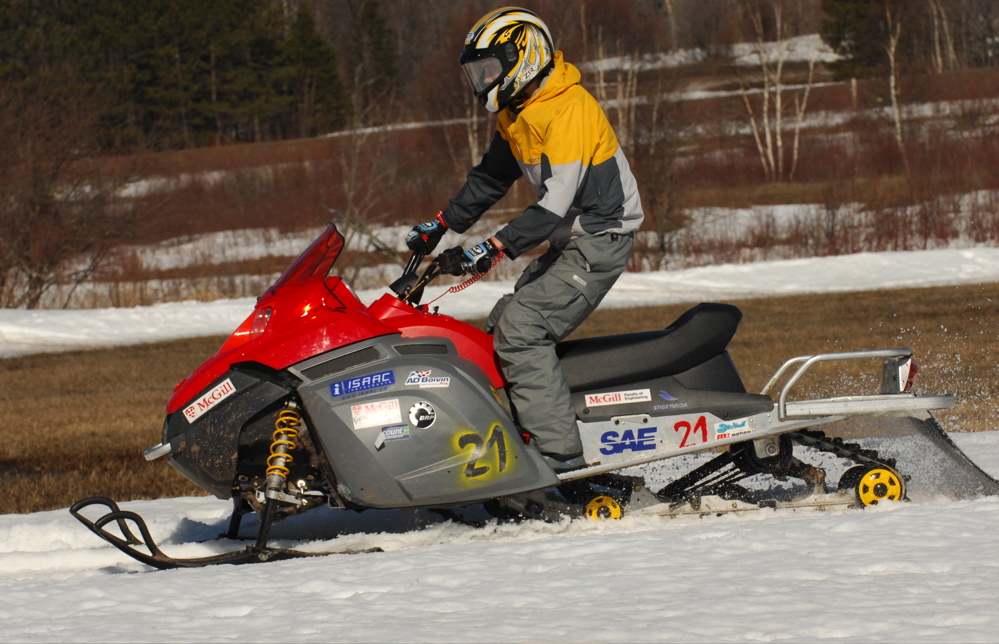

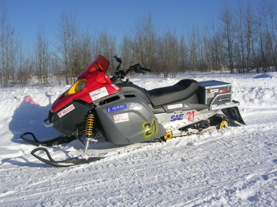

Here's a shot of how it looked last year, followed by its current form. Last year, the batteries were just sitting out in the back, and all the electronics were actually under the seat where the gas tank usually goes. Now the updated version has nothing outside of the engine compartment. Tons of empty space in the gas tank and out back. You can really toss this thing around and get the tail to kick out, its really fun:
