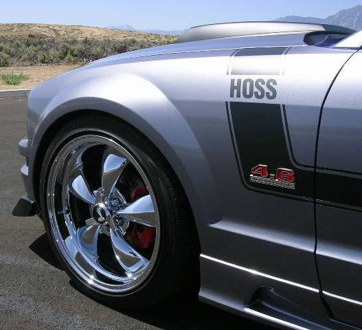

I think what he means by" marks " is damage to the finish getting the emblems off. They come off easily with a hairdryer and a flat nyon putty knife or Bondo spreader. Just go slow and easy and don't overheat the emblem. I assume he wants to put another emblem(except a Cobra) over the holes like I did on mine.
