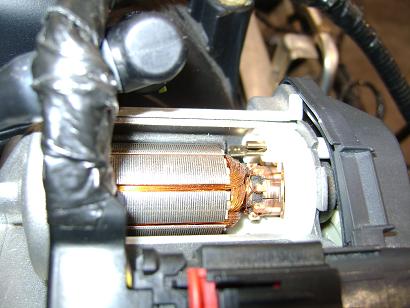

a 'throttle servo' to me sounds high tech...I work rebuilding CNC machinery, automating with Fanuc industrial robots, and to me a 'servo' typically weighs 50+ pounds, has ball bearings, sealed encoder, etc...I saw Fords cutaway at the cleveland auto show early '09, and there was a cutaway throttle servo- suprised at the 'cheep' look to it- looks like a old brushed DC motor from a kids toy, I was expecting a Aevox(model airplane three phase motor) looking 'servo' with hall effect sensors or something...nah, these 'servos' are pretty cheap- looks like a power window motor, but smaller...at least it appears Ford has not had the runaway issues of toyota...and from what Ive read they fault into limp mode pretty reliably if fault/mismatch occurs...heres a pic of the throttle servo on a 5.4 F150 cutaway:
