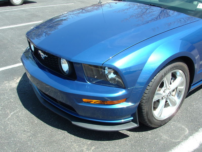

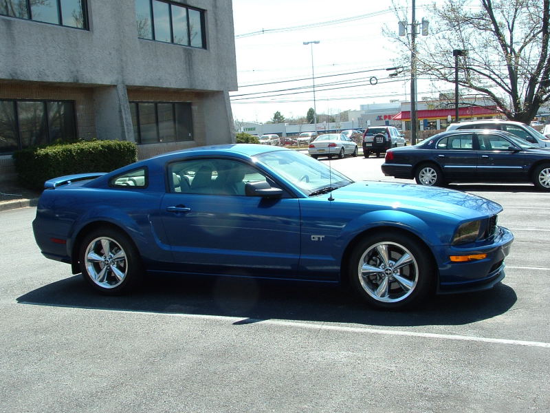

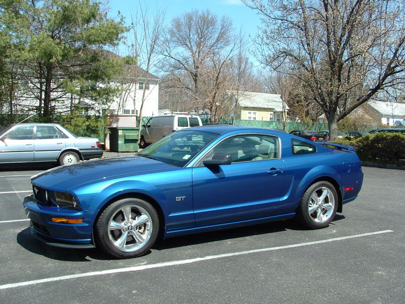

Took some current pics. Lowered and chin spoiler.

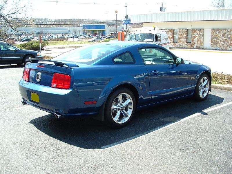

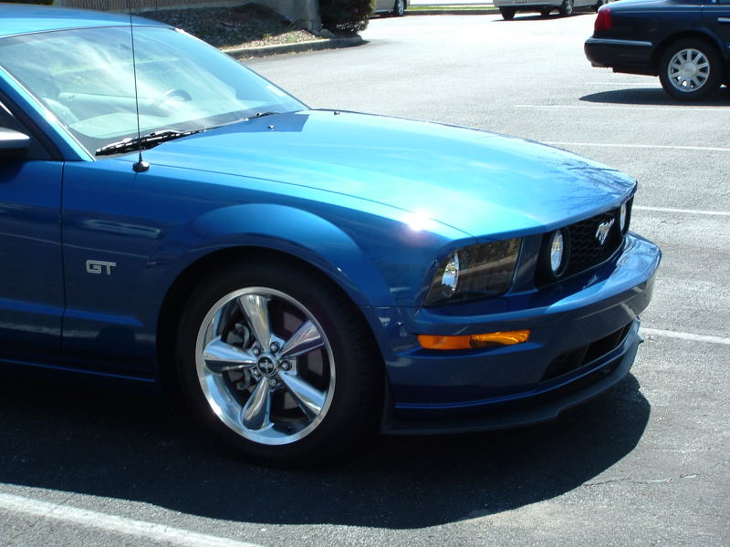

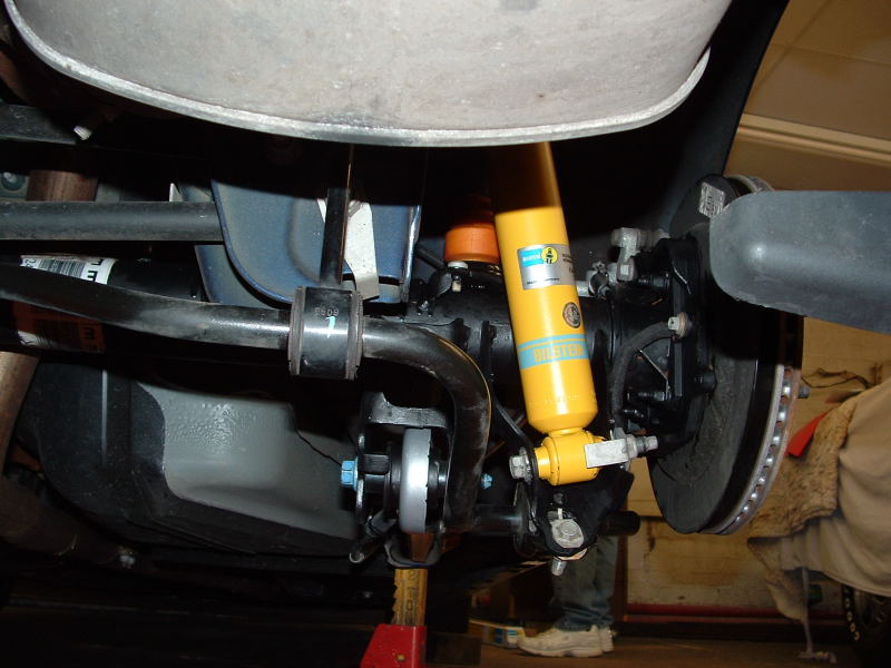

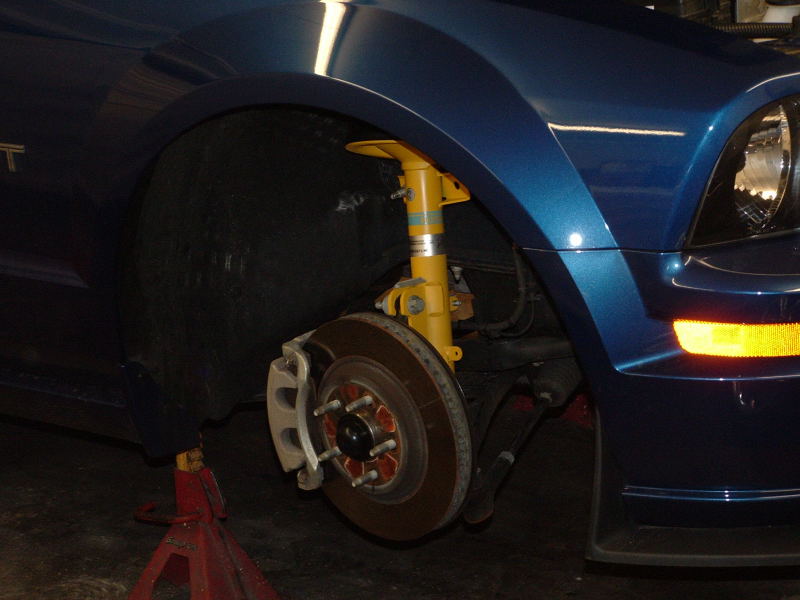

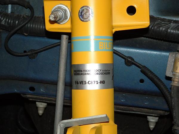

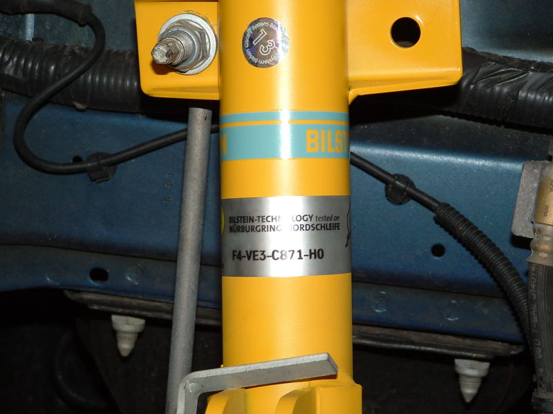

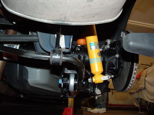

Hey guys. Snapped off a couple pics yesterday as it has been a while. I also threw a couple pics of the shock, spring, and lca install and a shot of the rear axle which is now painted rather than rusty.

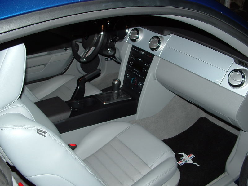

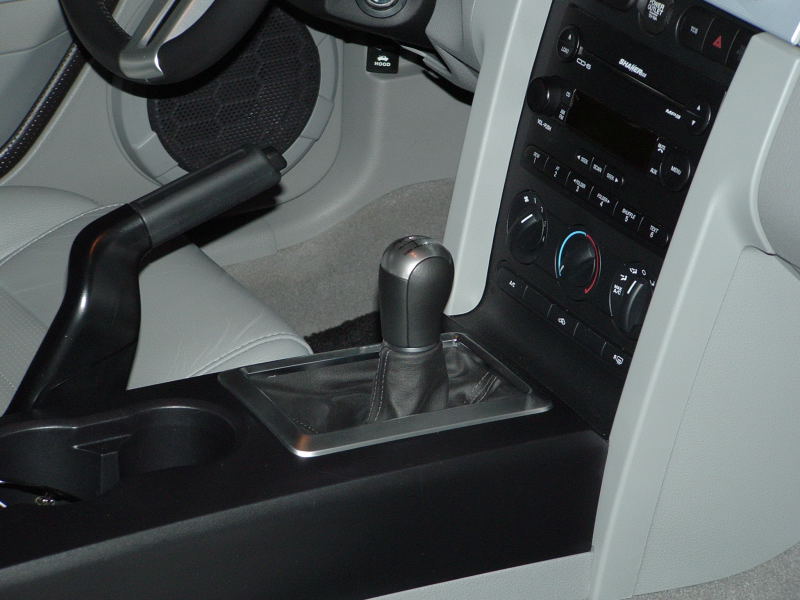

Nothing fancy as I did not bother driving to a decent location to have a nice backdrop and the lighting was just ok. Mods are those listed in my sig. I added the aluminum trimmed 07' shift boot late last night so I snapped a pic of that too.
The mud flaps were on for the winter and are probably coming off this weekend. With all the rain and crap happening this week, I just left them on for another few days after I pulled the snow tires off.

Looks nice, I like the GT500 spoiler. Just enough to notice it, but not obtrusive.

Looks good! I love these cars You buy a new Mustang ,then make it your Mustang

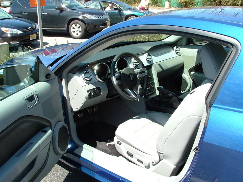

Great looking car, I love that interior but I'm glad I don't have to clean it.

Love Vista Blue!!!!!!!!!!!!!!!!!!!

Yo classj, I just wanna know how your gonna fit those brembos with those rims?

I strongly recommend you take another look at the spoiler again as it's not the GT500 spoiler but in fact is the factory Mustang GT spoiler..
The chin spoiler/splitter is from the 500 and modified to fit a gt bumper. The deck spoiler is stock GT trim.
Maybe 1" spacers. I have the brake setup from the gt500, and H&R spacers waiting for install. The clearances work out fine. But I want to install the spacers and see how the car looks. By my measurments the wheels should be as far out as the aftermarket 9" wide bullitts.
Otherwise, I will need two new sets of wheels (summer and winter), or figure out something different for the brakes.
But either tomorrow or next week I am going to do some more fitting.

Moses... Oceanslime huh? Im sorry! j/k! I live in Escondido. Anyways where can one find that front spoiler?

Tastefully done .keep that interior clean!

Thanks. The interior is not bad to keep clean at all. I switch to different mats in the winter to keep the crap off the carpet. I have had her a year next week and it is still new in every way driving it every day.
One of my other cars has a white interior. Now that is a challenge. The gray is not too bad so far. Especially since the leather is very washable and coated, not natural leather like a porsche or something would have.
Splitter is right from the ford dealer for 40 bucks. There are threads about this. It takes a little experience with this stuff and alot of patience and time to get it to fit right. 4 holes need to be drilled in the car. Only thing that needs grinding is the new splitter.
I also had to machine a custom plug out of black delrin for the rect hole in the middle which took an hour or so on a mill, and find plugs for the others. I have about 10 hours on it all together amd it was on and off the car at least 10 times.
The cervini's looks like a option too. But I would want it in black plastic or poly. I have scraped mine lightly a couple times in really steep driveways with no damage at all visible since it is just plastic.
If it were painted I would have to touch it up I guess.
That is one of the reasons it is black plastic to begin with I would think.

The splitter looks good.
Also, I couldn't agree with you more. The plastic is definitely the way to go, because it can take a lot more abuse without showing it too badly.
The only problem with the conversion: if something were to happen where it needed replacing, I don't think I would spend the time to redo it. Although, realistically, it would only take a couple of hours to redo, since the hard part of aligning it is already done.

What H&R springs did you install, Sport, Super Sport or Race? How do you like the ride? I’m leaning toward H&R Super Sport and Tokico D-Spec struts. Anyone have that setup out there?

I agree. I love the look but I am not sure what I would do if it got hit.
The car could be put back together in an accident in the same timeframe without the splitter. Then I bet using the original as a guide I could drill the holes and grind it in a couple hours now that I know what to do. And as long as my plastic square plug did not get lost or damaged, that would be reusable. And I have a sack of about 100 round plugs from mcmaster carr.
The only other two front ends I like are the roush and shelby gt500. But I want to keep my grill mounted fog lamps, so I would need a different grill or something custom for the shelby nose.
Wayne, the springs are H&R sports, 3/4" drop approx front and rear. I did them with bilsteins at the same time. But I love the handling. Ride is a little firmer. But ride quality overall is improved, less suspension noises, just everything is better. I have a post about this.
I think my rear bumpstops are hitting under some conditions though as they are close, so I have to address that.
I threw on the 1" H&R spacers today in prep for the brembos. They look great so far. I had to knock the tips off the studs on the car with a cutoff wheel and dress them as they were hitting the wheels even with the pockets. But that only took an extra 10-15 min a wheel maybe. But it had to be done.
So as long as the car is ok over the next couple weeks. I will bolt on the brembo stuff.

That looks great. And I love your shifter boot. Where did you get it?
