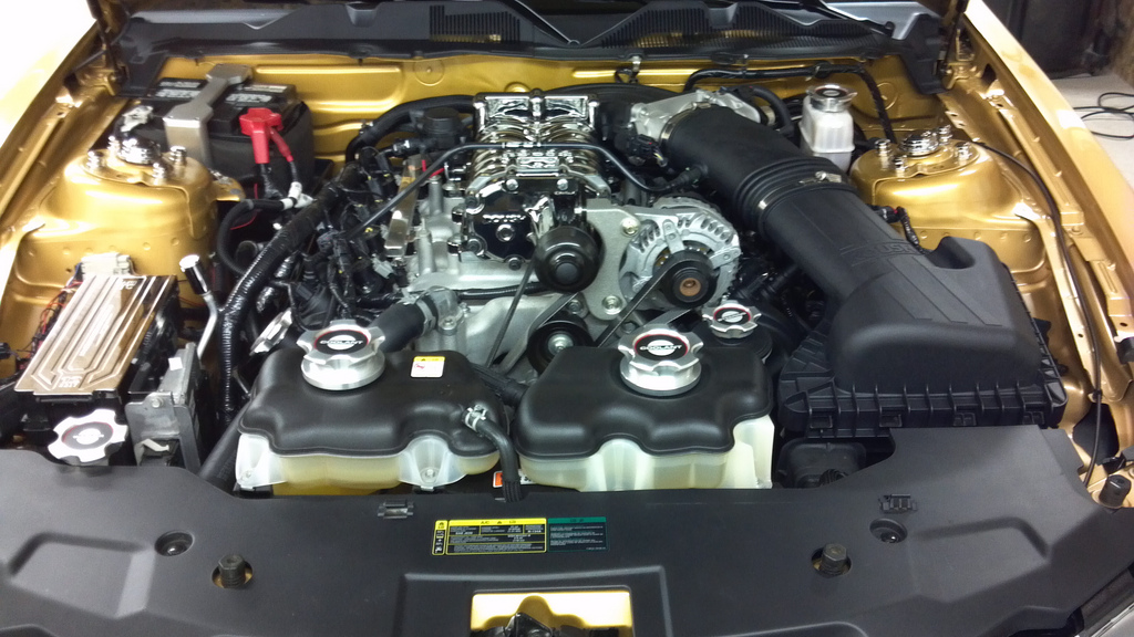

I have the M90. As a first time Mustang or any real sports car owner. I started with the best price. The M90 is a great starter supercharger, it makes the car come ALIVE. If you have the money, do the TVS 2300, that was told to me. Any supercharger will put a Big A_s Smile on you face. Enjoy!
