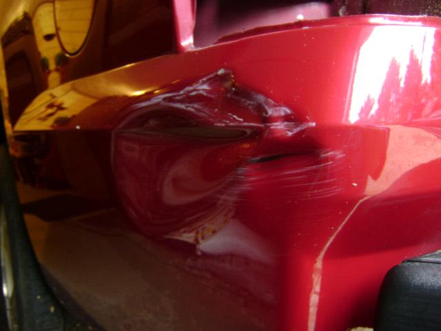

just to paint/blend, I bet 800 minimum... I got a price of 1200 just to spray a hood- paint is expensive, labor to shoot it is too.
if any structural/welding/hidden damage, it can get pretty nuts. Id bet a 'minor' quarter straightening/painting will run 1200-2500 depending on whats involved for a minor one... having to cut/weld/seal or panel replacement, double that... I agree 100% with John, best to save the panel...some folks would 'want a new one', but a new one involves welding without ecoat/epoxyprimer dip that the oem one has...
if youre still driving it, take a mirror and look closely under the fender lip where the outer panel is crimped- if anyundercoat is cracked at the crimp, do anything to seal it before it gets water in there...ductape/anything, theres no way to clean it out if road grime gets in the crimp, and thats one spot you wont want rusting...
hard to imagine without at least a pic, but hope its not too bad, just a little hammer/dolly and paint job

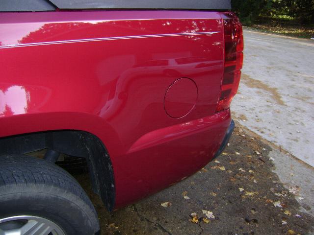

I just did my wifes 07 avalanche, got hit on vacation, just below the taillight, really krinkled it up, got it beat out pretty straight, but you can see the metal is stretched...at 500 deductible, had to fix it myself for 50 bucks, just so it wouldnt rust over winter...far from unnoticeable, but looks better than it did and shouldnt rust.
I got the paint from automotivetouchup.com, the basecoat is great and color was better than Ive ever found...their clear is a kinda cheep laquer, but it dries fast and rubs out quickly...wish I'd have bought my mustang louver paint from them, my first set I spent over 200 bucks for the base/clear/hardeners and the color wasnt this close...with christmas right around the corner had to do something- but cheap as possible...

thanks, but its still pretty apparent it was hit- wife was happy with it, unless you look its not *that* noticeable...looked a lot worse with wrinkles/chipped paint, gouged lens...the lense sanded out nice, cant even tell it was tore up...had fun with the kids for a couple evenings- I didnt let them hammer on it(they wanted to) but they did sand/buff/dspray...makes it a bit more fun
I wasnt too happy with the bodywork, metal was stretched enough/not enough access to get it all out, but I was super happy with automotivetouchup.coms spraycan basecoat...think its like 16 bucks a can (we have our machine paint at work put in pressurized cans for touchups- the paint store charges like 20 bucks a can to put it in the can- plus paint!) and their color match was really really close. just the basecoat for my mustang louvers was like 80 bucks for a pint IIRC, it was a fair bit off...if I had to do any more trim work on the mustang I think i'll try the goofy spraycan from thesr guys- for the base anyways...their clear is not that great, seals/shines up alright and being laquer its fast, but I'd rather have a urethane clear- huge price difference though...
