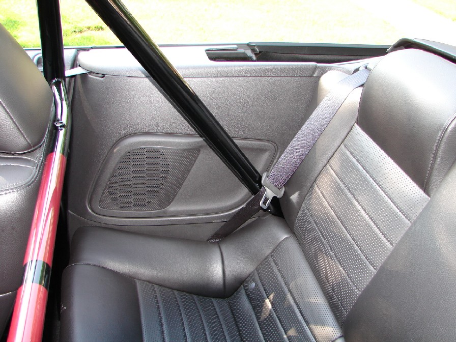

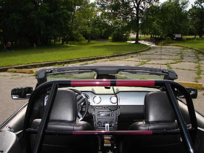

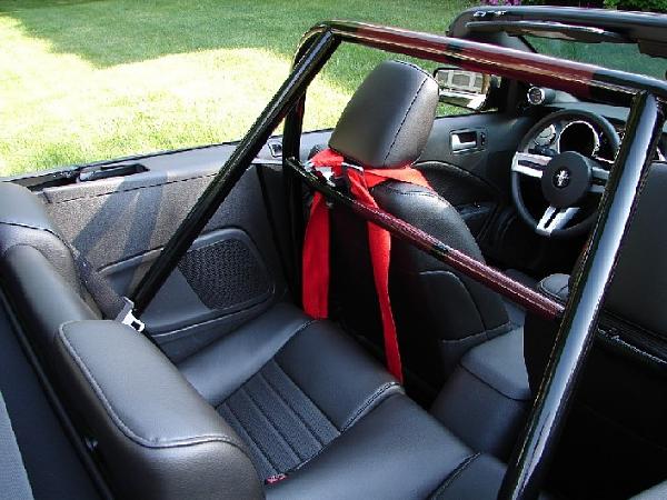

We mounted my rear braces in the corner of the rear seats (see pic). Required slight trimming of the rear seat bottom in the corner. Rear plastic trim did not need trimming.
Why do you want to spend 1000 on a non-legal rollbar?
The rollbar is worthless without a harness also. So if you eliminate the center harness bar as you plan to, you will have nowhere to mount the harness.
Also nobody makes a rollbar as youve specd it. So you would need this to be a custom rollbar. Prices range from 200-300 per point for custom rollbars.

UberPony,
I do need a legal bar for VIR and CMS, two area road courses.
They require 4pt. harness for any 'verts.
Even a roadcourse is planned to be build on the lake I live on.
You setup looks exceptional for a rollbar.
The rear braces are perfect.
They fit the corner of the seats well.
I would want someting similar done.
The hoop part of the bar looks great also.
I would want something similar there also.
But the harness bar looks to be too close to the seatback for my application.
As a daily driver, my seatback is recliner further, to where it almost touches the rear seat.
During autocross events I have it more upright, but past where your harness bar is.
I suppose saving up and sticking to the local shop would be best.
That way I could sit in the vehicle and make the measurement around me.
I would like to sit in a car once with a bar installed to get the seat feel.
Thanks for the pictures.
