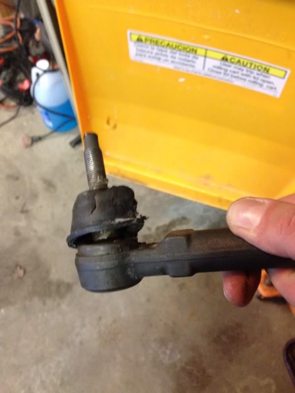

Figured it out... duh!!! rod end...

Tie rod? I take it you saw some play in it. Was the boot shredded like that on the car or did that just happen while you were busting it loose?
I find it weird that a front suspension problem would make the back end lose, but then again the front suspension controls so much of the feel of the car.
Old Jan 19, 2014 | 04:57 PM
DPHC13's Avatar
Joined: October 6, 2010
Posts: 427
From: Antioch IL
It was ripped. It was a floating feeling so I was compensating little bits as I was driving. I think that's what was making it feel loose. It never actually came around on me under "normal" driving, and now that I changed out the part it feel's SOOOO much better. This all happened right after I lowered it and added the Pan hard bar. All this at the same time kinda changed the way the felt to me, and I guess I was over sensitive. When I got the tie rod off and moved it around it was WAY F'ed up. It was really tight in one direction then really loose in another.
