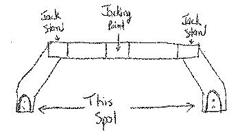

Maybe subframe is not what I am referring to.
Check out the attachment for the location I am referring too, and please tell me what to call it. This is the front end of the car.

I jack the car from that spot all the time to get my main jack under the center of the car just below the engine. Since I lowered the car, I need 2 jacks to get it into the air. Once I have the car up, I also use those spots for the jack stands. I have probably done this on the order of 20 or so times with no issues.

I put my stands there all the time without an issue. I jack from the center of the K-frame and throw the stands where you pointed under the mount bolts.

classj,
Thanks. That was the answer I was looking for.
