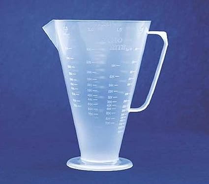

.... and pouring the fluid into a measuring cup to the 16 oz line (32 ozs is a quart) each time ....
http://ecx.images-amazon.com/images/...4L._SX425_.jpg
.... I installed the drain plug and removed the fill plug and pumped just a dribble less than 3 quarts and 7 ounces (call it 3.2 quarts) of slightly aged (est left over from mid '90s) Texaco Havoline Mercon / Dexron III ATF into her.
