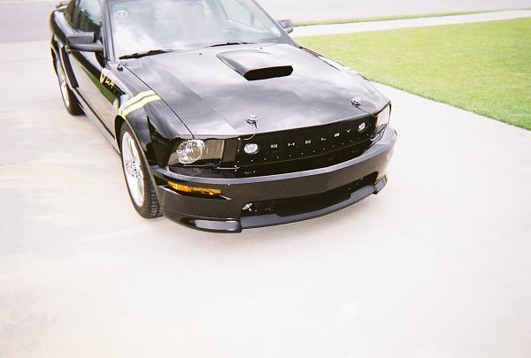

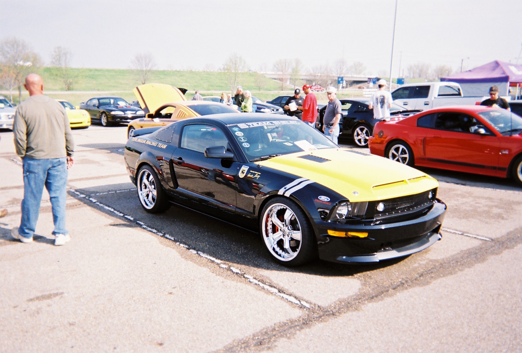

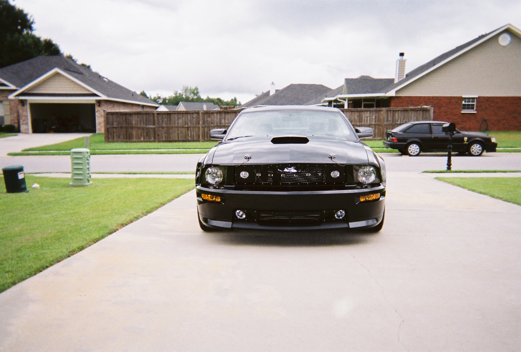

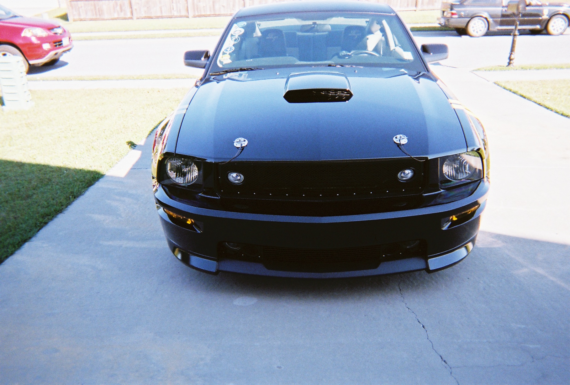

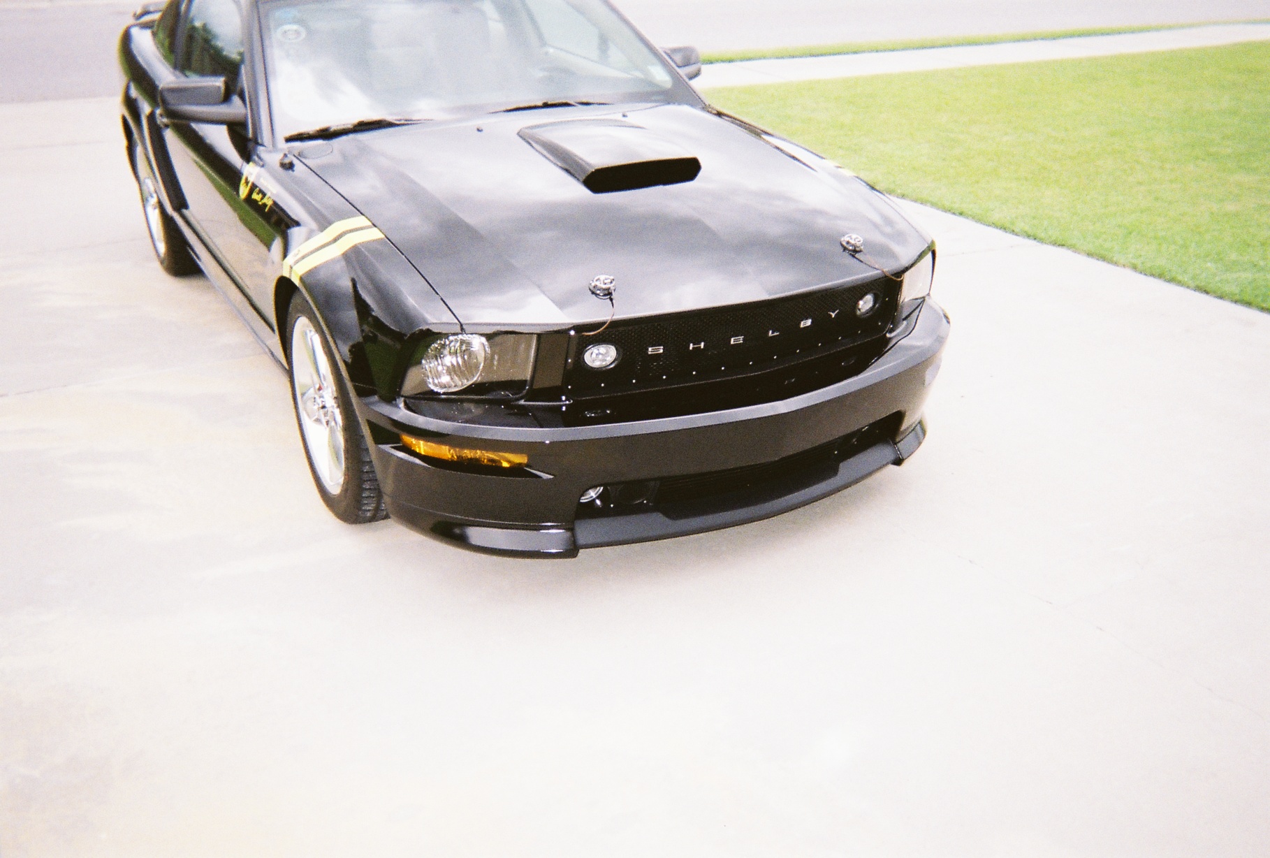

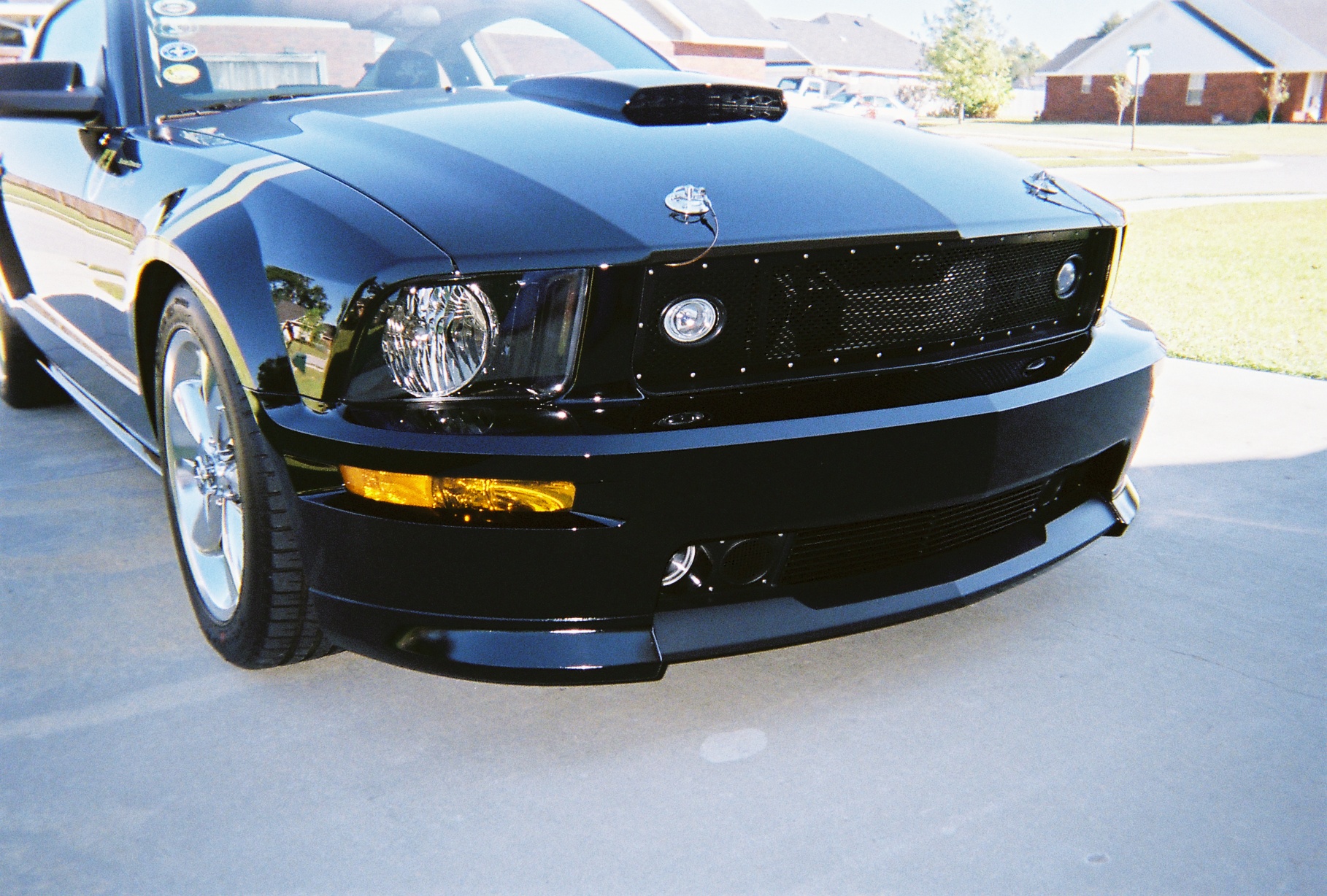

Hood pins , ,,just do it and be done ,, I had mine over 135 mph with no trouble after I installed the Shelby hood pins a few years back ,,no shake at all .

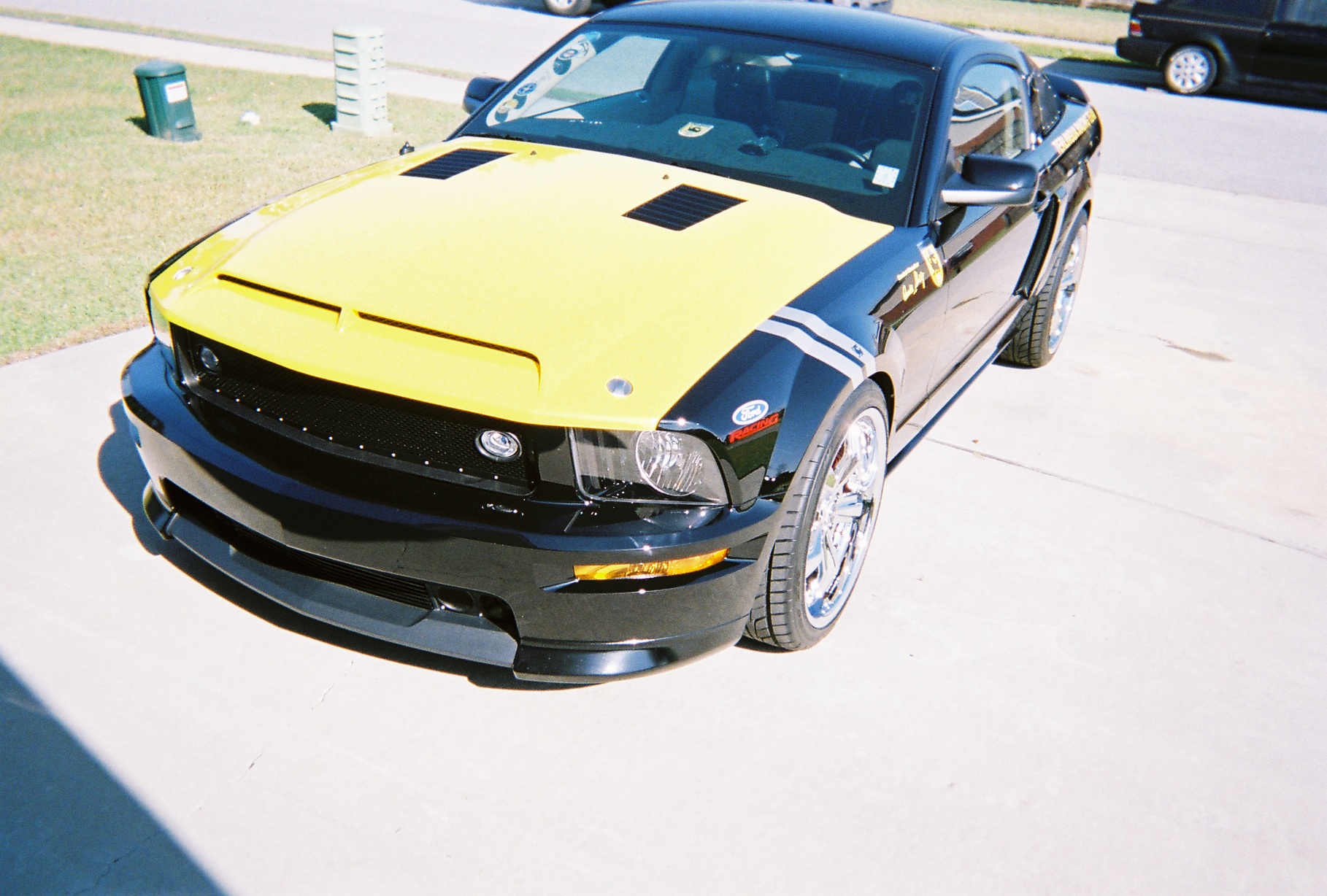

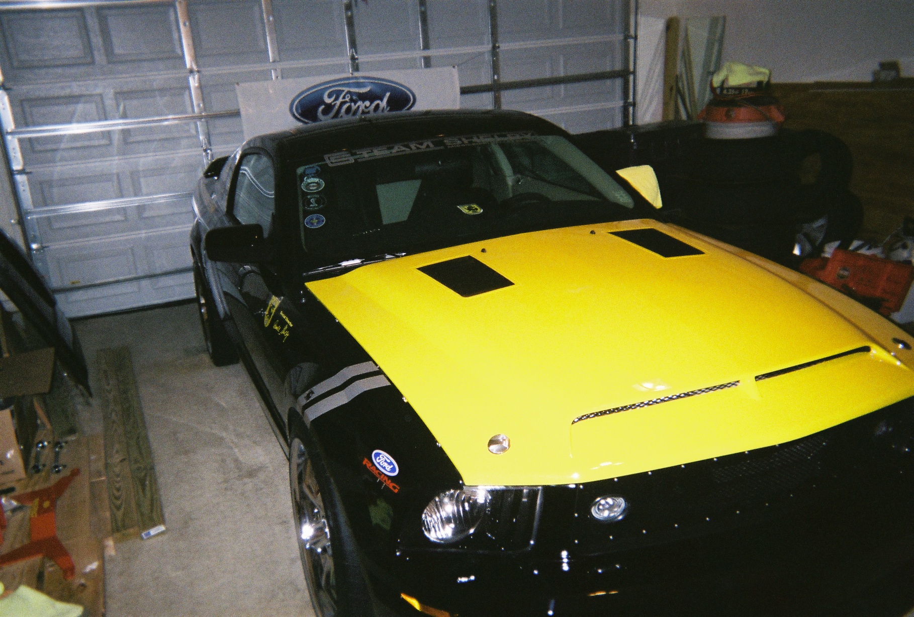

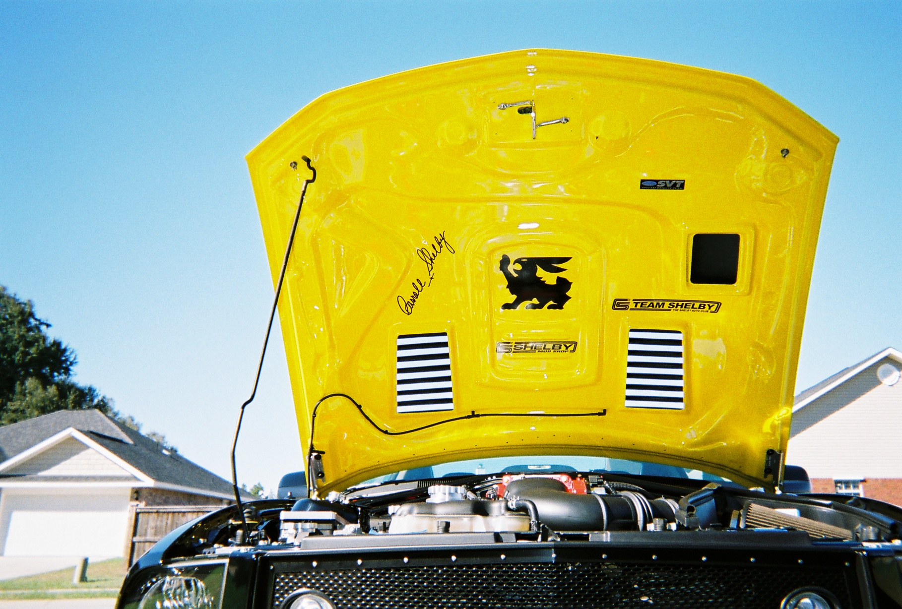

Hood popped doing 80 on highway-323010-r1-04-21a.jpg,,,I have the Trufiber ( twist -locks ) on my Yellow Trufiber Hood now ,, they work great as well ,,140 mph plus ,,not shake or pop ups ,,"no worries " at all . best money I spent .

Attachment 131197,,,I have the Trufiber push -down and turn ( twist -locks ) on my Yellow Trufiber Hood now ,, they work great as well ,,140 mph plus ,,not shake or pop ups ,,"no worries " at all . best money I spent .
Hood popped doing 80 on highway-140220-r1-11-14a.jpg,,,,,,.
