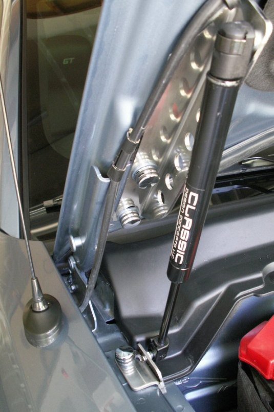

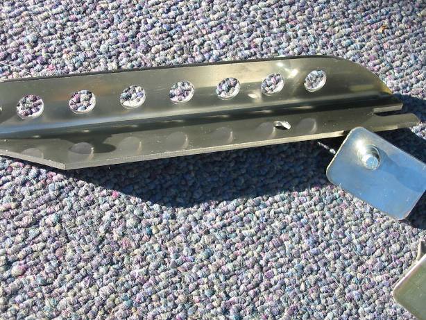

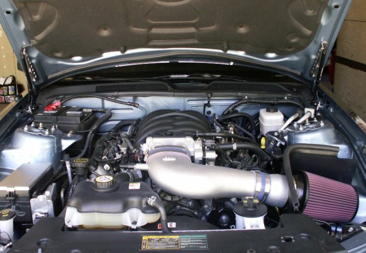

Finally decided on a vendor (CDC) and installed my hood struts...have to say, install went off without a hitch (thanks to all the great tips and install pics from other TMS'rs). Opted for the CDCs over the MRTs as I like the stainless steel look. Whipped out the Dremel tool and polished the heck out of those SS brackets (pics below). My primary install concern was hood misalignment, so I took 3 precautions: (1) marked multiple locations where hood met bracket (so I could tell if any slippage occurred after loosening bolts); (2) wedged a 1 1/2" sanding block (wrapped in wash cloth) between end of hood and cowl (near hinge); (3) loosened the REAR hood hinge bolt first (backed out just enough to slide "U" cutout on bracket under bolt & washer), then tightened just enough to prevent slippage... I left bracket slightly angled in so it wouldn't cover front bolt. Next, I removed FRONT hood hinge bolt, gently tapped the CDC bracket back into proper position (so front bracket hole aligned with front hinge hole), then re-tightened both bolts.

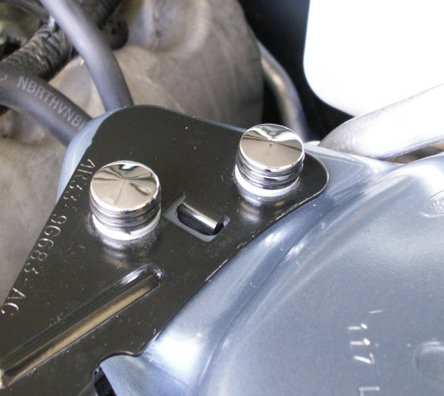

A shout-out to TacoBill for his 10mm bolt cap solution. Pick up a set of Spectre Billet Bolt Caps (O-Ring design) to finish off the look. Did multiple hood fit checks as I progressed through install... still fits like a glove. Liked the bolt caps so much, started covering other 10mm...
