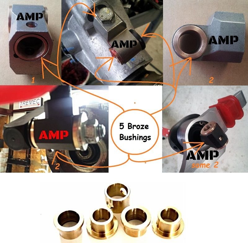

Has anyone here who has swapped in more solid shift link bushings care to share the results?
These are to replace plastic bushings on the square bar link that connects the shifter at the lower end and the transmission. They look like they would tighten up both forward and aft movements as well as selecting which rail by the twisting incurred as the driver moves the shift **** left to right?
I'm thinking of something like the AMP TR3650 Bronze Remote Shifter Bushing Kit, but it took some looking to find them. I ask here because these transmissions were used in both V-6 and V-8 models with 5 speed manuals. I don't have a problem, but it looks interesting, would for sure reduce wasted motion I think, especially twisting motion as you change from 2nd-3rd or 4th-5th.

I found some pics after much searching, I don't know if it was my choice of search terms or just that these are a well kept secret, but got a set coming now. Just ordered the AMP 5-pc bronze bushing kit for the link bar myself, they look to be just what the doctor ordered as they will snug up the real connection between the shift handle and the shift rod at the transmission, transferring both for & aft movement as well as twisting motion in selecting the 1-2, 3-4, and 5-R internal shift rails. I already have the Hurst C+ Billet shifter I put in in '13 with a lever extension I made to raise the ball (still only 2.5" 3rd to 4th and no hitting console with funny bone), and the McLeod SS braided clutch line (no expansion) and a Bondurant pedal extension (clutch pedal should be higher than brake as it requires such a long stroke) . I think the bushings look to be the topping on the cake.
If the OEM link bushings wear and allow slop, even the finest shifter can't transfer driver input to the transmission effectively with no lost motion Buying a aftermarket shifter gets one shorter throws, but there's still the lost motion as to that twist that goes on at the "gate" like from rail to rail from 2 to 3 or 4 to 5. None of the aftermarket shifters address that, they all have one reuse OEM bushings. They often include polyurethane bushings for mounting, but you could weld the shifter support arm to the transmission and still loose the motion due to sloppy or soft link bushings. The bushings they do include just stiffen up mount bushings that have to allow for the engine/transmission twisting in relation to the car body.

A video I found on another site, freely posted. Looking at it, the rubber you see is like a dust or dirt cover for the factory plastic bushings, I think one uses them on the bronze ones too. Mine haven't arrived yet.

I did measure mine though. Made sure two of one, two of the other, and just one of the third with the hole through it that goes on ball end of shift rod extension from transmission. The five were in a sealed clear plastic bag inside the Amazon padded shipping bag.
