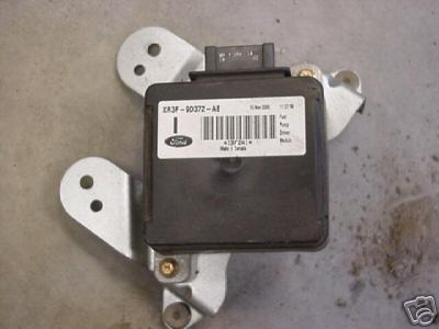

I had a similar problem with my 01 GT. Pulled into gas station, went inside, came back out, and it would crank but thats it. No check engine light, nothing out of place under the hood, and I also didn't hear the pump kickon when I turned the key on. Had it towed to the dealer and it turned out to be the fuel pump module. Had I payed full price for the fix, it would have been $400.

where is it located on the car and can auto zone put in on their code reader and tell me what it is, also i don't hear the fuel pump kick on

Its on the left side of the trunk behind the molding. I don't think it threw any codes when it bit the dust on my car.

well i think i will definatly try the diconeccting the battery and then the fuel pump modeul and if those don't work i will do the fuel pump
