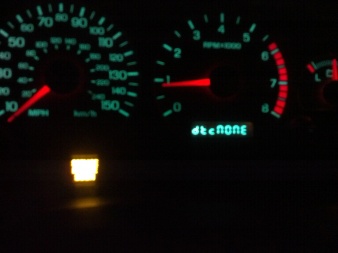

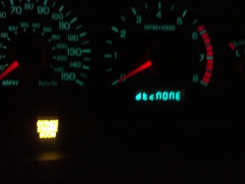

there is a way to check it w/o going to the auto store. hold down the reset button on the odo for a few seconds, then continue holding it, and turn the key to on (not cranked), you should see the gages sweep, now you can hit the reset button to scroll through a number of things, such as a check of the dash lights, digital speedo and rpm, and the dtc codes

i havent figured out why that happens, unless that feature wont read every code. Mine did the same where it said none, even though I know of one that should be there constantly.
Old Jan 7, 2012 | 09:21 PM
cpotts13's Avatar
Joined: July 27, 2011
Posts: 1,569
Okay I think i figured it out......
i lifted my car up, disconnected the battery, and went and disconnected the MIL eliminators, went to plug them back in and they snapped into the socket, I didn't do that before....
So i am thinking the MILS weren't fully connected, so a the check engine light came on. I read somewhere that the the CEL can come on and not read any codes becuase there may be something wrong with the electrical (?). So anyways, connected all up RIGHT, drove it around the block and no codes so far...
