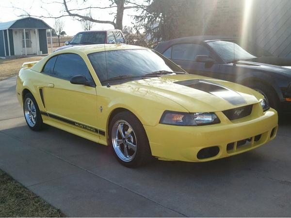

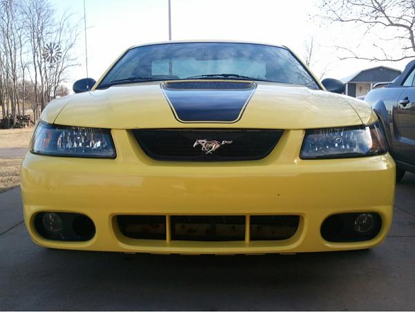

I put one of these on my v6. I got all of it from a Certifit which is the place to go for oe parts. So much cheaper than anywhere else. My dad and I painted it and installed it and it went on perfect. I was missing the bezels that hold the fog lights and brake cooling duct and the fog lights themselves. I went back and bought them and installed them. Never got the foglights hooked up, and never installed the brake duct kit (don't even know if there is one). Long story short, hope that helps and do install yourself. It isn't hard. And we also just took the Pony out of the old grille ( I think it was pop riveted on) and made a bracket and mounted it like the cobras have it. Kind of like the mach1 too. Hope any of that helps. Here's a picture:

Also be aware the GT and V6 hood is longer than the Cobra hood, so if you mound the top of the grill sides where it usually goes the hood will hit the bumper. A lot of people drill holes farther back in the headlight nose panel and mount it slightly back so prevent this from hitting.
Top of this panel is what i am referring to.

I do remember that. Just scuffed the paint on the top of the pillar around the grille. And I can't remember now. But just as a reference I almost bought the cs bumper for my 06 a few months back and it was only like $230. See if you can find a place like it. Just oem replacement. It's where all the guys go who buy wrecked cars

No I didn't modify it. I think we bent the hood latch a little and it was still snug but didn't touch the bumper. The hood latch took a little more jiggle after that but it worked fine.
