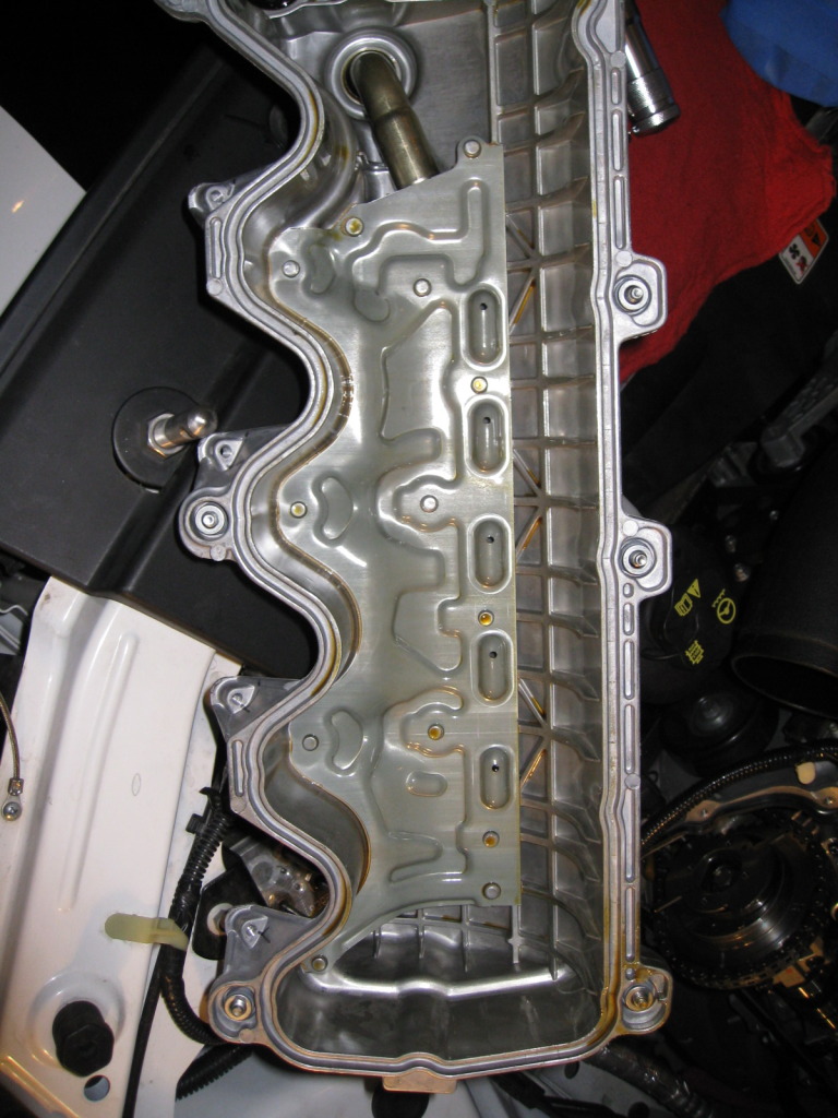

This is the inside of the 4.6L3V cam cover. I would imagine its pretty much the same.

I figured it out yesterday. No baffle in the valve cover so we removed the driver's side cover which has a baffle and modified the top opening to accept a PCV grommet and all is well.
